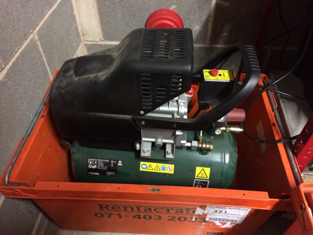

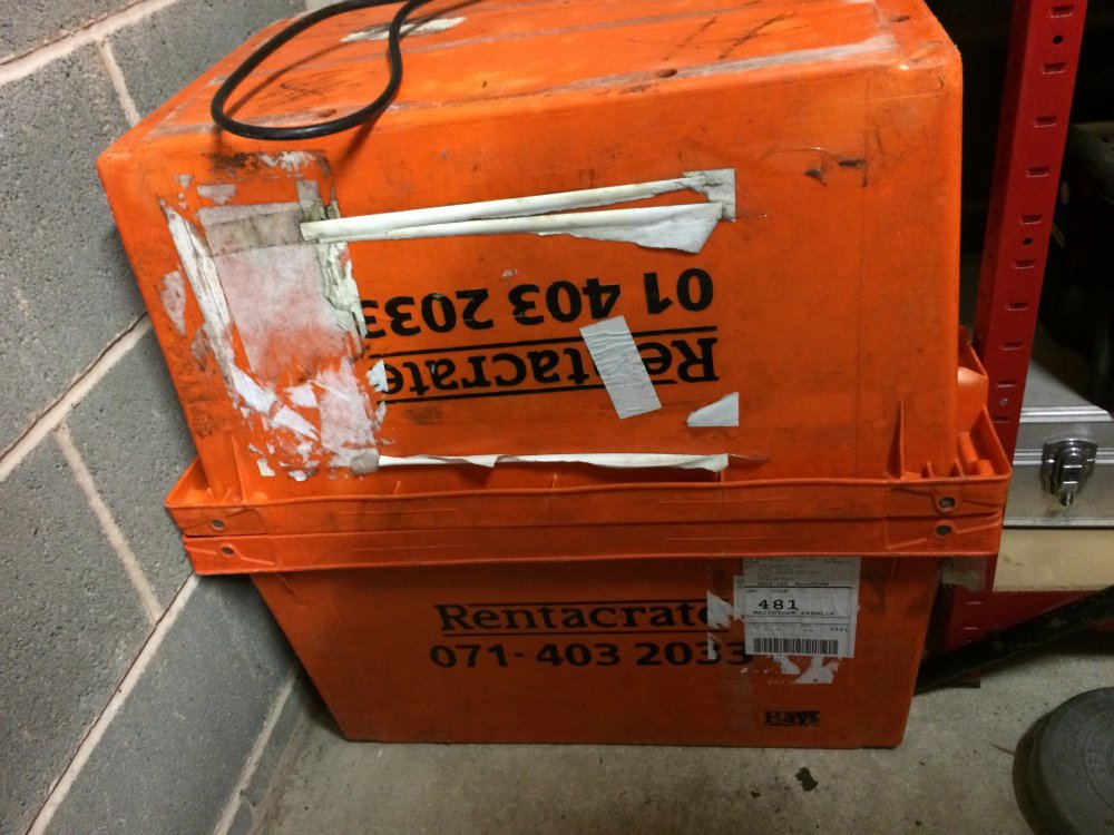

and fit a high flow rate fan small ones wont do itmake a box from wood, thin plastic containers will amplify some of the noise just like a drum does, create air vents that turn corners as sound waves cant travel round corners
I have no experience with fans other than computer ones, I didn't even know it had a fan inside the compressor haha. Thanks for the heads up I will take a look in to that. I may even be able to piggy back the fan's power supply
