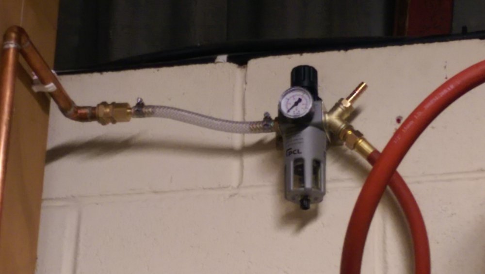

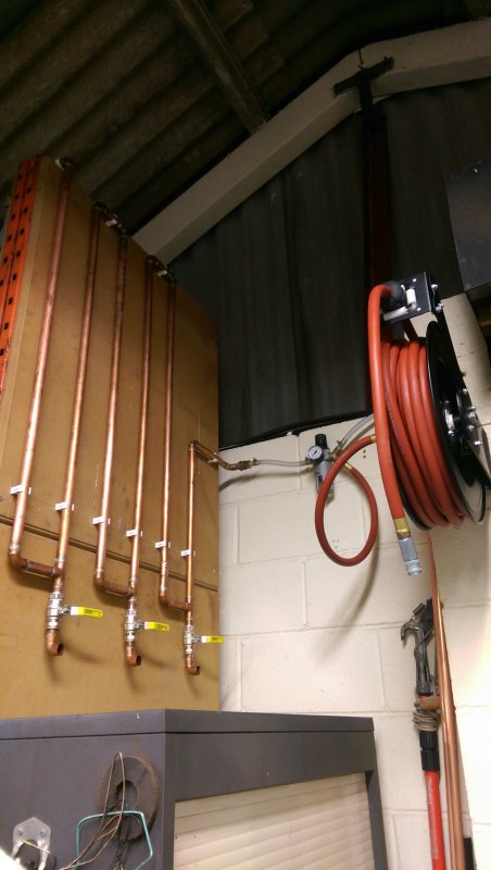

Hello all,
I am trying to make one of those DIY air dryer setups with the copper pipe/ ball valves etc.
I have read many threads on here but I am still struggling with how to get from a standard pcl socket on a pipe from my compressor to the dryer, and out the other end once the air has passed through it
I am going to use 22mm copper pipe but can someone please tell me how to get from that to a pcl plug on incoming side and pcl socket on the other end ?
I read on a thread earlier that you can take the nut and olive off a 15mm compression fitting ( that i was hoping to reduce from 22mm to) and put a 1/2" bsp fitting straight on to it , but i have just been out to try and get a couple of pcl fittings and the only 2 sizes I can find locally are 1/4" or 3/8"
Any help will be much appreciated
