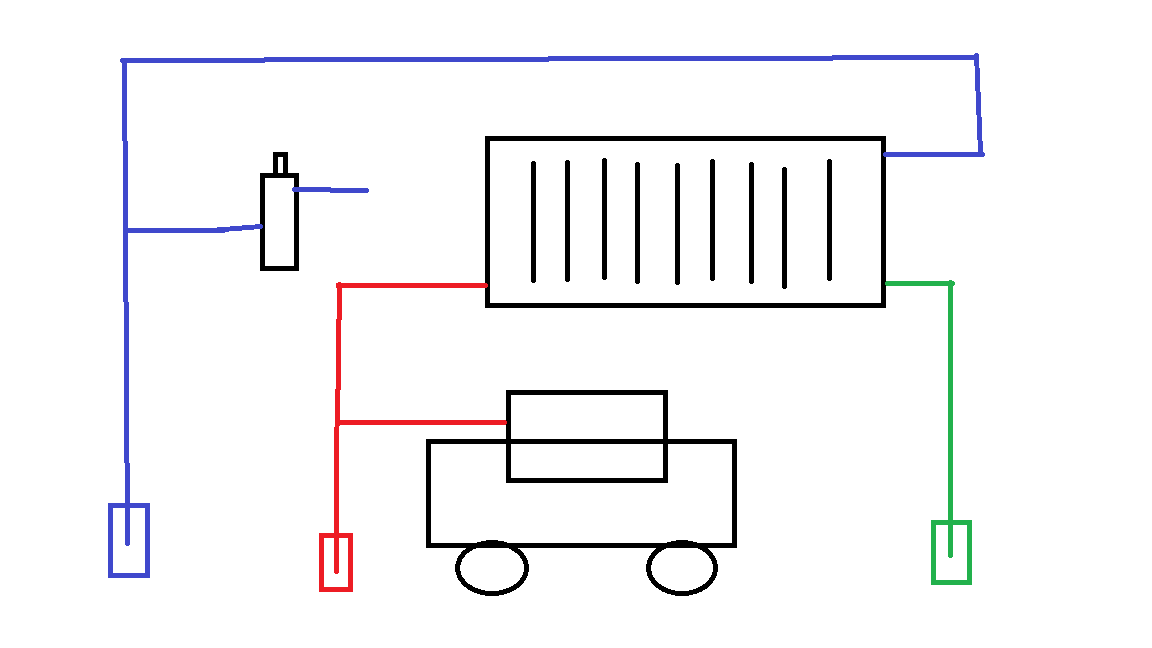

I'm going to open with I think this may be a little mad...
Currently I have my compressors outside each unit inside an enclosure. I want to cool and dry the air.
I was going to go with the traditional loops of copper pipe work on the back outside wall of the unit with the typical drain off points. However when I was mulling around the back of the unit I realised I have 4 house hold radiators.
So I know they are OK up to 8 Bar working as I have the data sheets for them, I would intend to put the air line in at the bottom and on the opposite take out at the top with a long drop drain at the bottom of the opposite side.
Am I mad to think this?
Cheers
