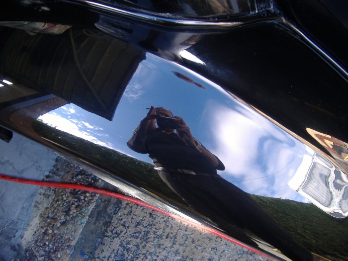

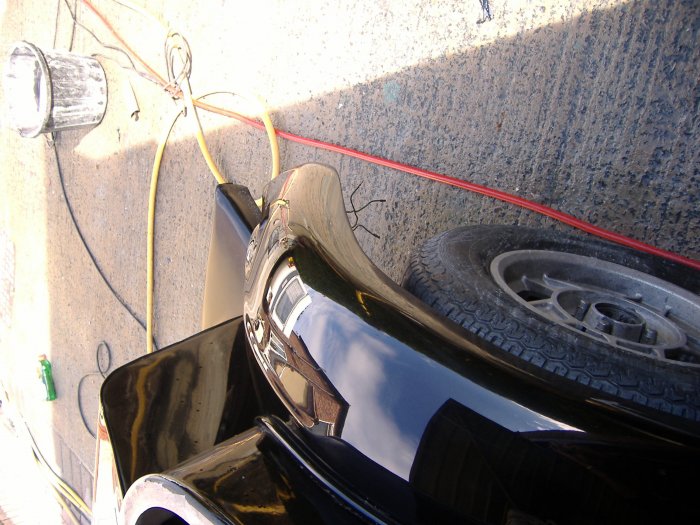

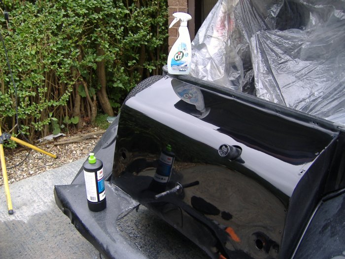

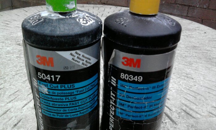

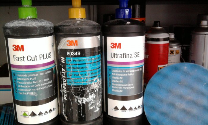

what we call water spotting,if you are in a hard water aria this can happen .But your paint still needs to cure.When you compound put a little on your mop head ,and not the paint itself.the best cloth to use is,micro cloths ,This will take your compound of to easily.Get a pack of six from asda,or tesco.Your water spots will come of ,with a repolish.remember when you are polishing ,there should only be left swirly polish marks ,not a large amount of compound,When you get the car in the sun you will see swirl marks caused by the mop head ,to get rid of them you will need the blue bottle in this picture,plus the blue mop head that's in the picture.
I'll see if I can get hold of some of that blue top do you think I need to leave the paint a bit longer ?
