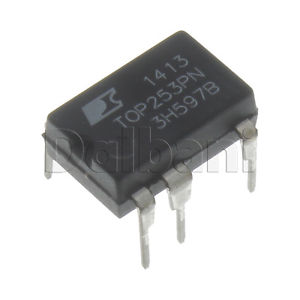

Had the small 24v PSU pop on the plasma today. I had a spare so it wasn't a problem but I have just looked in the old one and there is a component blown. Anyone know what it is likely to be so that I can get a replacement.
It only has 7 legs which seems a bit strange and from what I can see it doesn't look like one was just snipped off as there doesn't seem to be any remnant left as you would expect if that had been done.
Here is a pic of the whole board.
And a close up of the component.
