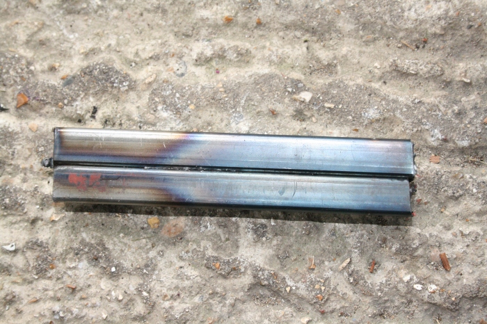

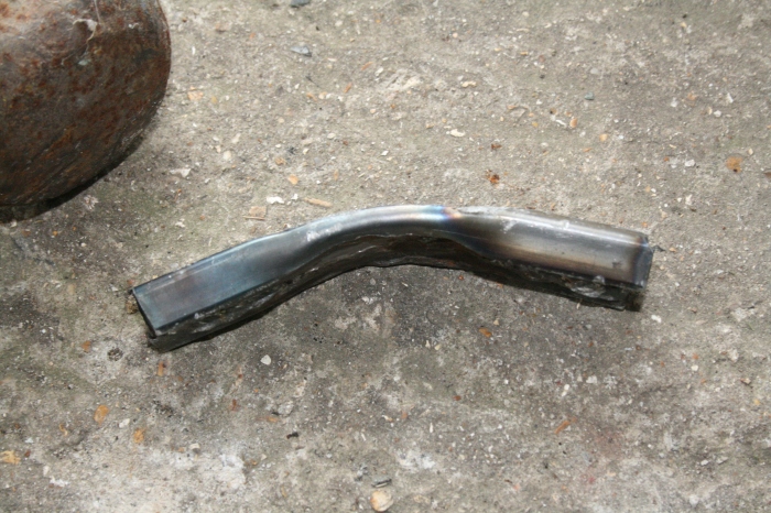

For weld testing - it's no good unless you break it. It's when it breaks away from the weld that you know it's a good one.

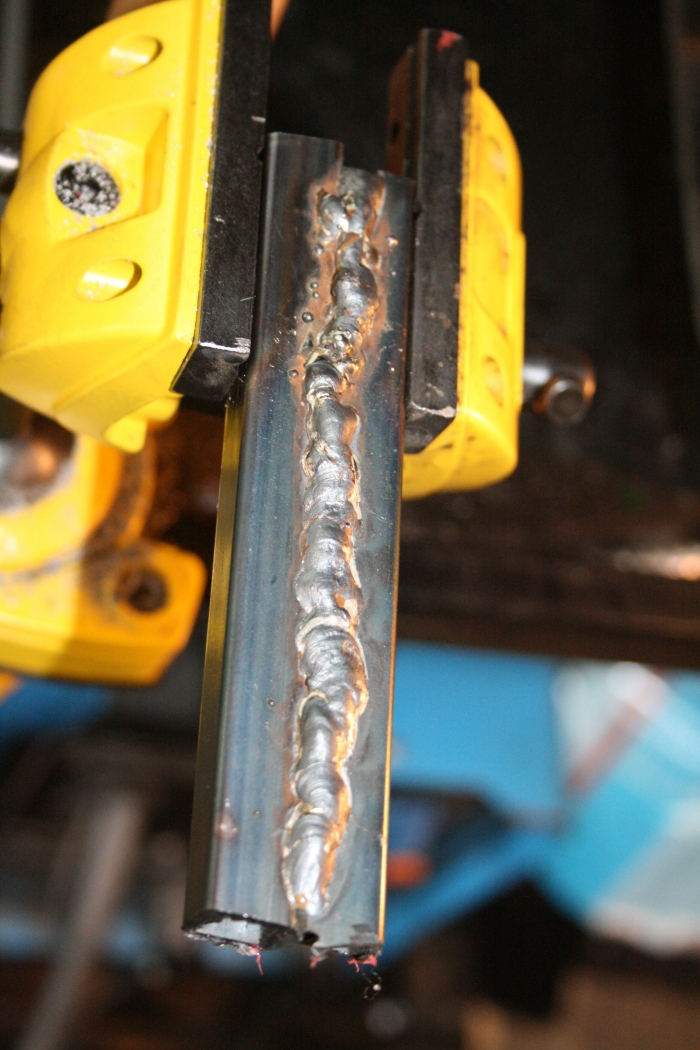

For welding in a straight line can you see the weld pool and the joint it needs to follow while welding? Having your head way to the side helps a lot.
