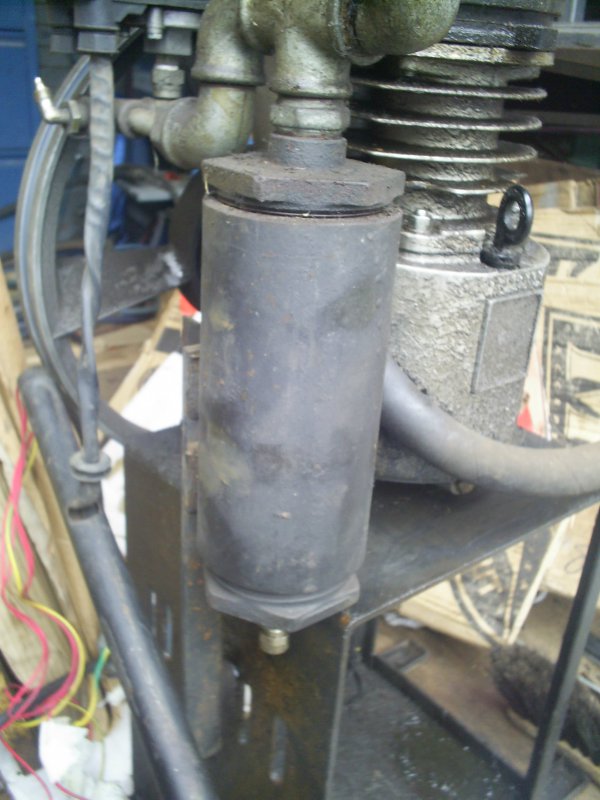

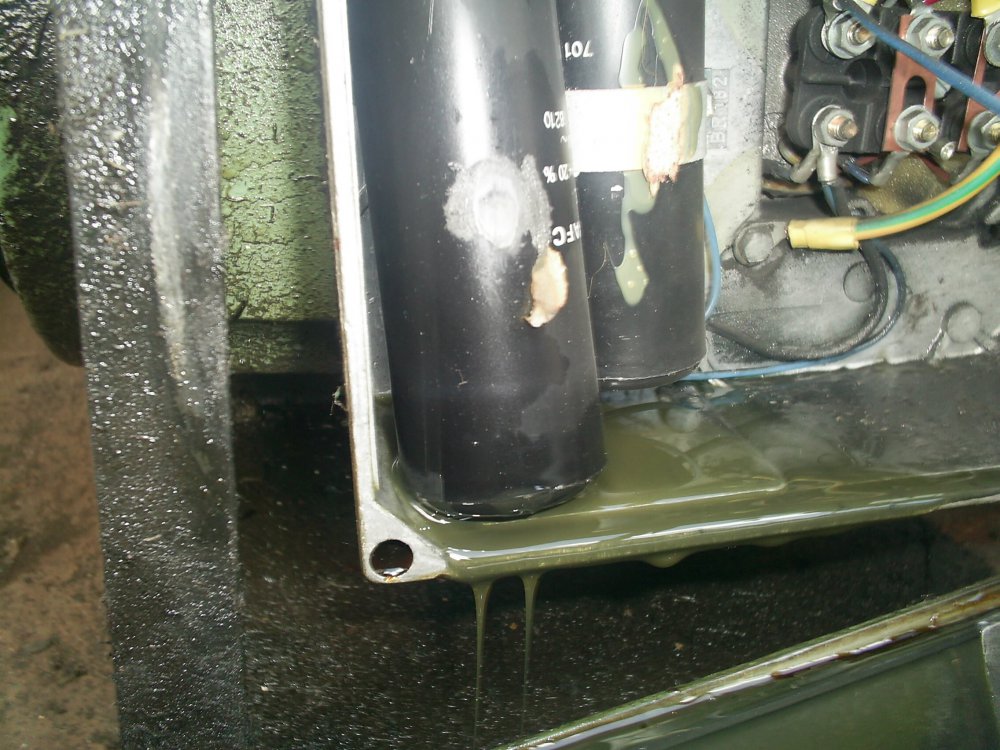

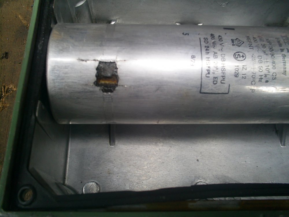

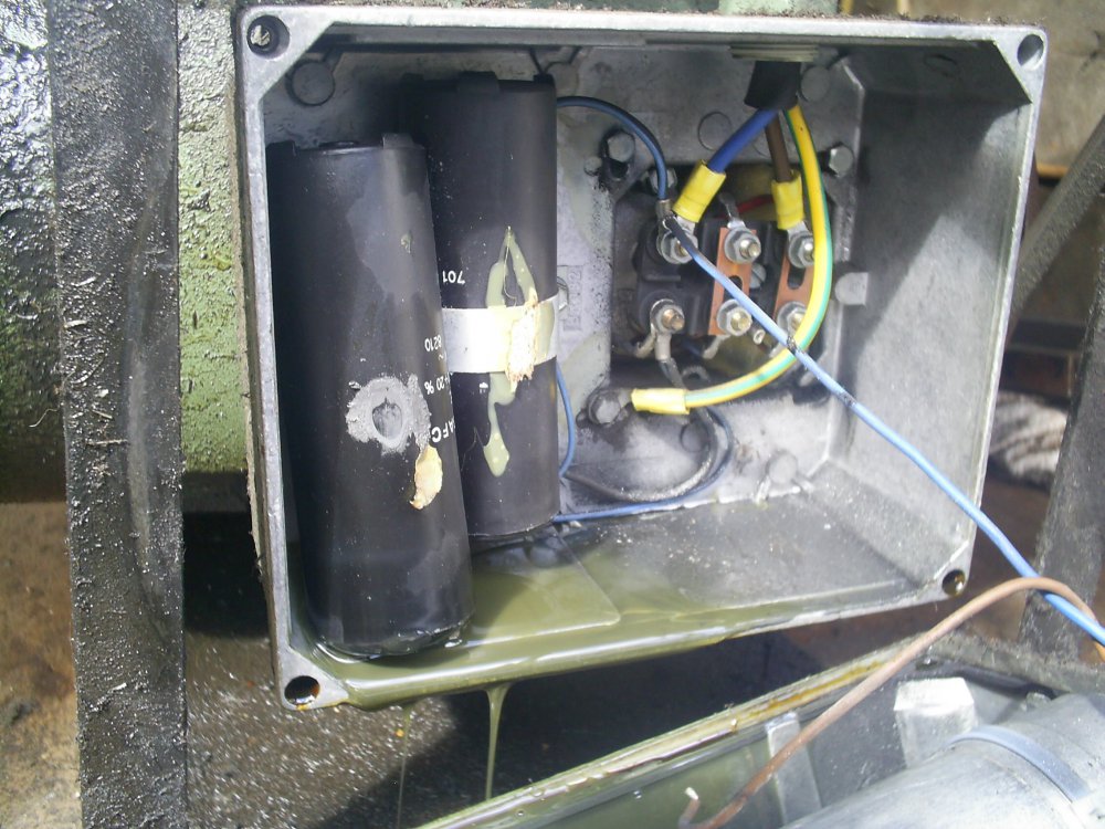

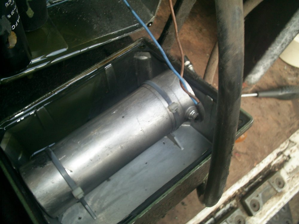

I won one of these compressors at an online auction from a farm being sold. It has a separate vertical tank and is a stand alone cabinet. It was working at hammer fall as the tank was full of compressed air and indeed a lot of water. From the look of it it has not had a lot of love and attention paid to it. Anyway I decided to clean it up and check and paint where required. Upon taking the cover off the motor I found a mess in there. The oil was thickish and although there is a lot of oil mixed up with the dust of the cabinet and all over the engine and components I do not think it is engine oil. Do the two black capacitors have oil in them I wonder? The third capacitor in the lid looks ok. As well as the oil the brown lead from the silver capacitor was adrift from its luck and the earth cable from the mains input was loose as the bolts holding the whole electric casing to the motor were either loose or had fell out due to, I assume, vibration over time. There were no spring washers fitted so no wonder. The compressor is as title and is a model 5450 type MA 500.
watch out for the health and safety police jumping on the thread
check the size and get a replacement on the leaky one
