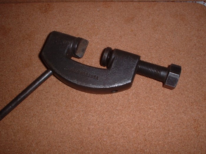

My TR7 rear bumper is held on by 6 14mm nuts on (I would say) 10mm studs. To be more precise, the bumper is currently held by one nut, which is being a bit illegitimate. The stud seems to be spinning in the bumper because the nut is rusted to the stud. It's a confined space, and I've tried all sorts of ways to either get the nut off or cut the stud behind the nut - grinder, nut cutters, close quarter hacksaws, even a hacksaw blade wrapped in insulting tape.
I've seen the compact 8" bolt cutters on eBay. Will these be any good?
Its a very handy tool to have,i think mine are sykes pickavant but any decent tool place should have them.....even Halfords sometimes have them in stock.
