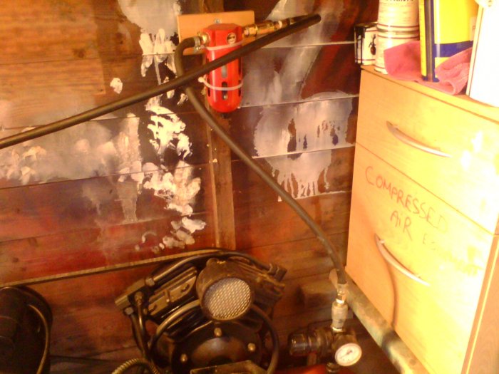

M miggymarky Member Messages 165 Mar 27, 2011 #1 Can anyone tell me if there is anything wrong with this set up i have in the photo.Also i am using 3/8 airline,so would this cause any probs running my da with this size of pipe.Any advice welcome.
brightspark Member Messages 41,189 Location yarm stockton on tees Mar 27, 2011 #2 3/8 airlines ok for a da . and u have the water seperator. as long as the hose lines arent to long and coiled up just turn ya moisture seperator round
M miggymarky Member Messages 165 Mar 27, 2011 #3 Forgive me if i sound a bit thick,but do you mean turn the whole thing round 180 degrees.
brightspark Member Messages 41,189 Location yarm stockton on tees Mar 28, 2011 #4 miggymarky said: Forgive me if i sound a bit thick,but do you mean turn the whole thing round 180 degrees. Click to expand... just the water seperator on the wall so that the pipes arent bent up
