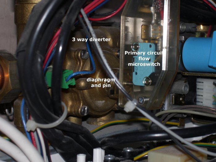

Could it be variable water pressure. My brother in law usually has great pressure, but at peak times it drops of drastically. Is there any pattern to when it fails?. Could it be that CH still works as the pressure there is created by the circulation pump, hence will always be high enough. Only guessing here as I've never really studied the inner workings of a combi.

You've probably got to the bottom of this by now, but as i've only just seen the post I will add my twopennyworth anyway.

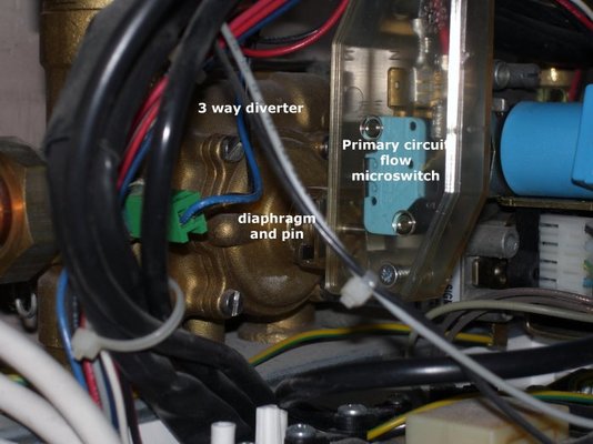

I also rely on a combi, though not the same make, and at intervals have the same problem as you, always initially at times of peak usage, ie, lowered mains pressure. First occurrances are when the tap is only turned on very slightly or very slowly. As time progresses, the problem gets more frequent, and is accompanied by little black bits in the hot water (bits of diaphragm). I have found that a diaphragm lasts between 6 and 7 years and that to replace it I have had to buy a complete diverter valve each time which seems a bit silly, but there you are.
Incidentally, the failure of the diverter diaphragm has never had any affect on the operation of the CH side of the system.
Hope this helps, even if it is a bit late.
By the way, it can be anything up to 3 or 4 months from initial problems to complete failure as the diaphragm deteriorates reasonably slowly

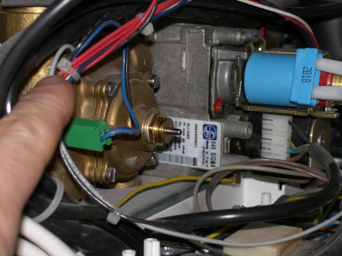

Thought I should post a follow-up on this seeing as I'm always moaning that others don't post follow-ups.
The fault got worse and got to the stage where I couldn't get any DHW unless I put the heating on so I had a guy out to look at it today. He replaced both diaphragms in the diverter and all seems well. Although the diaphragms weren't holed they were both stretched and that's what he thought the problem was.
Anyhoo, it seems ok and we now have hot water without having to put the heating on.
Yes, that was the deciding factor!
He has suggested we have a new DHW heat exchanger too, he thinks it's crudded up as you can hear the water 'swishing'.
The boiler's not that old and other than the fault we had it's in really good shape so probably worth spending a little on it to keep it up together. The new h/e is £92 so not too bad really.
He didn't mention descaling it, he's ordered the part now so probably a bit late to cancel it.
