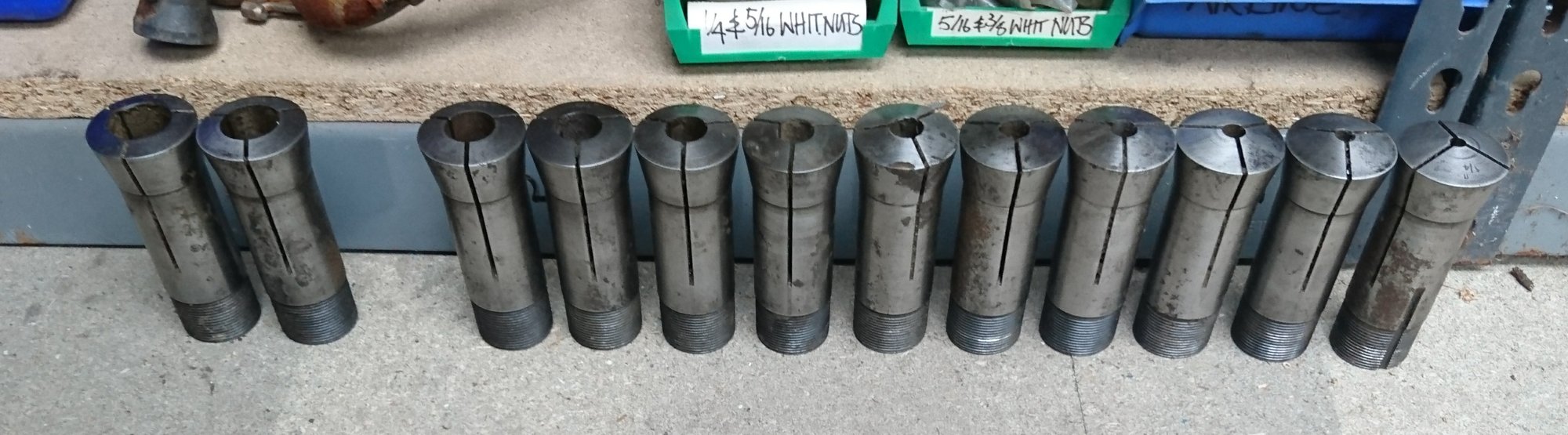

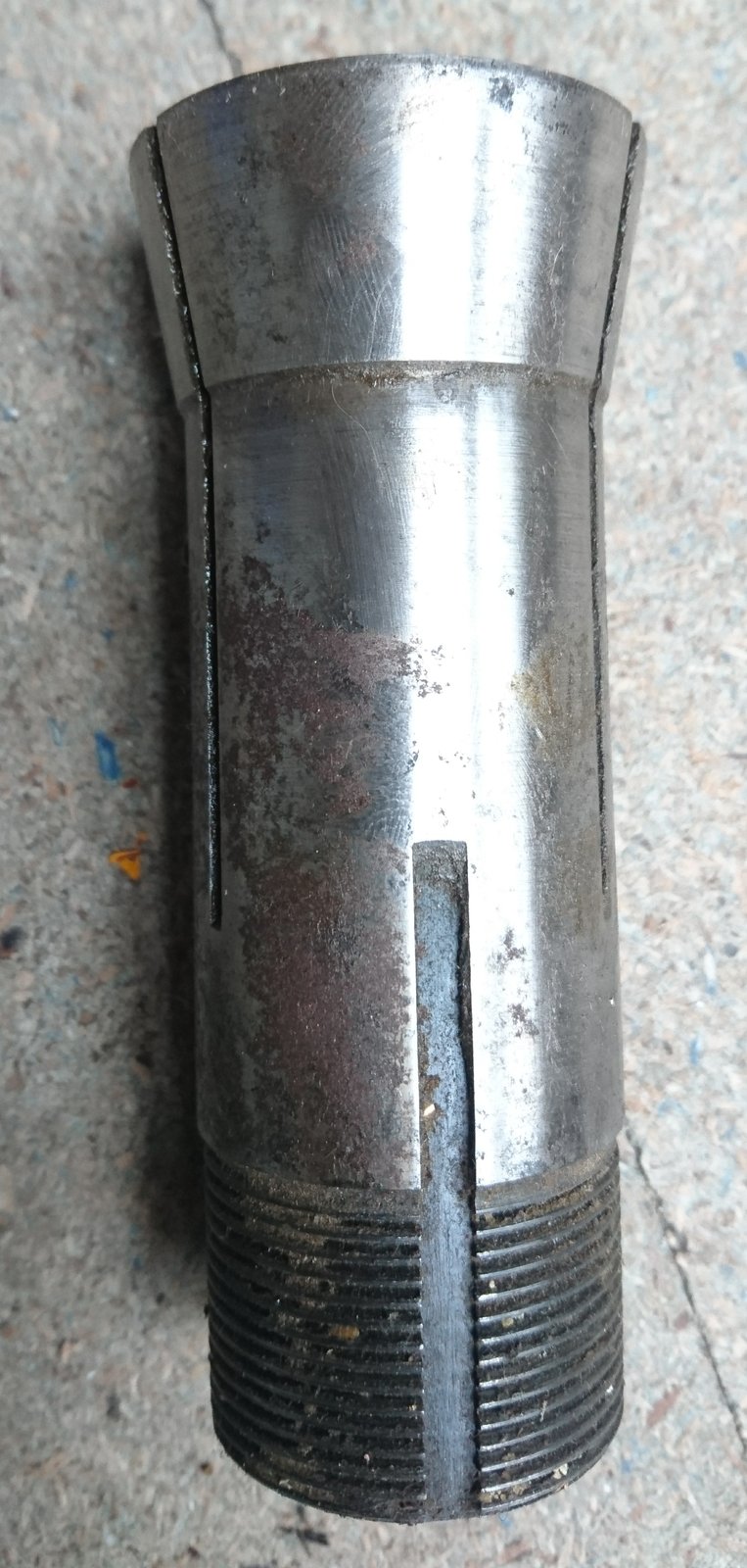

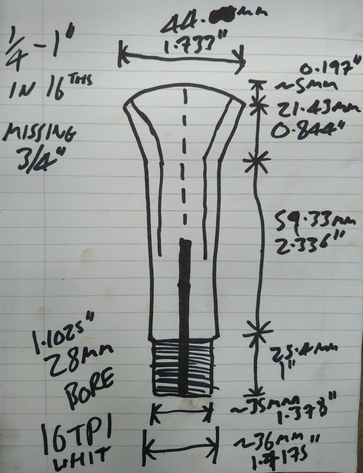

Hi folks,
Need some help to identify these collets, they appear to be imperial, the work holding dimension definitely is as they're 1/4" to 1" (missing the 3/4").
Any help appreciated, they look like hardinge 5c/20c ish but don't match the sizes in hardinges own booklet and listing.
Cheers,
Dan
