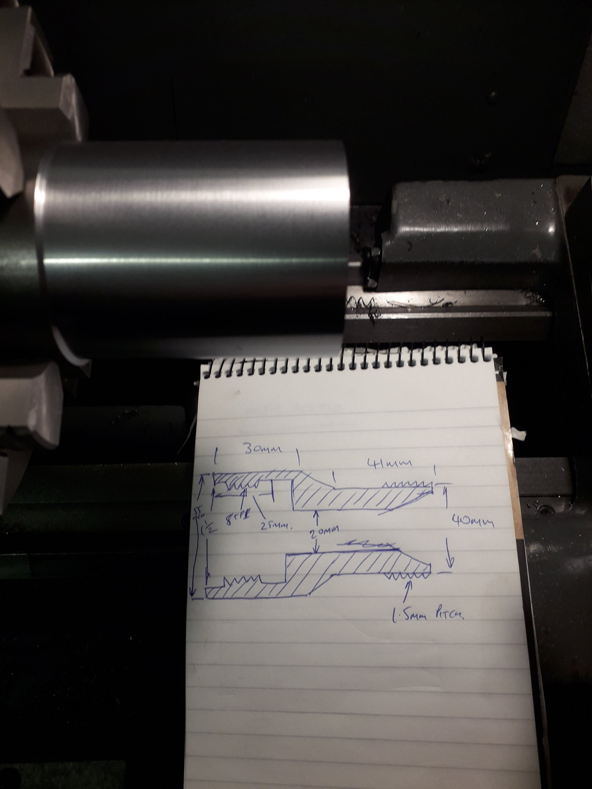

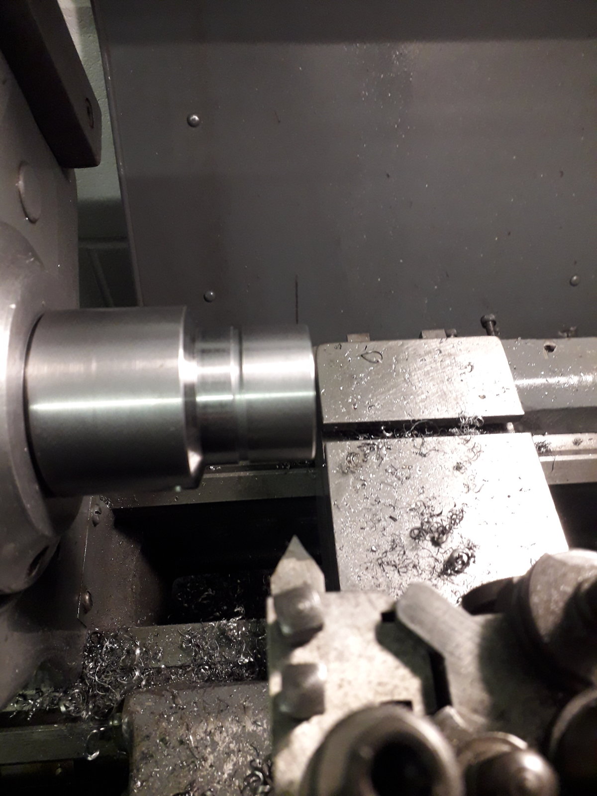

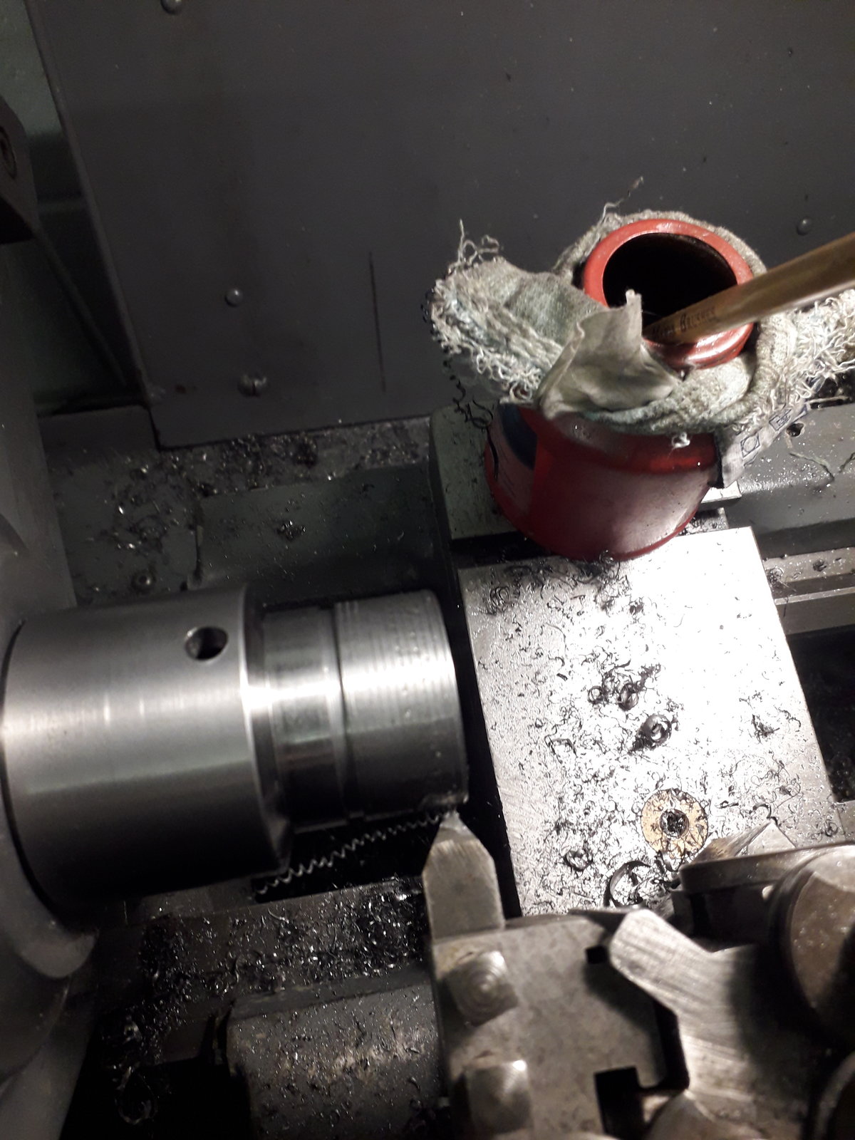

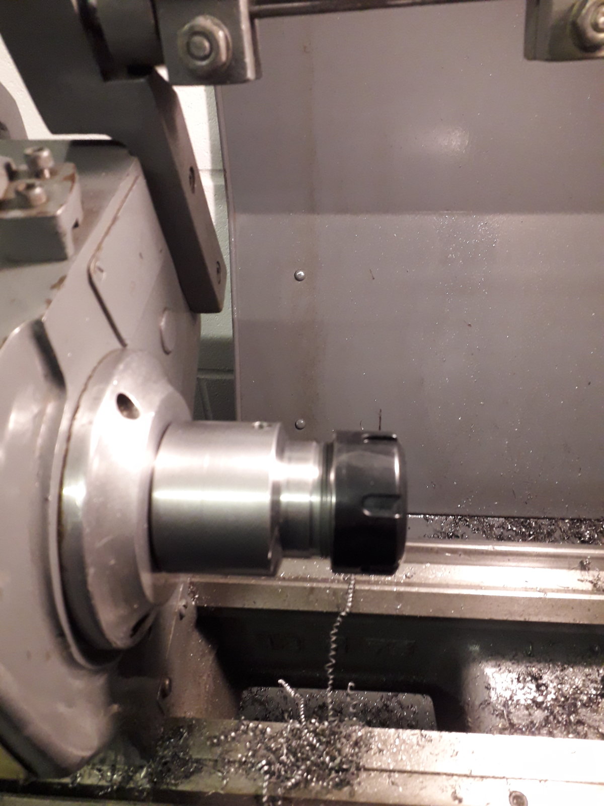

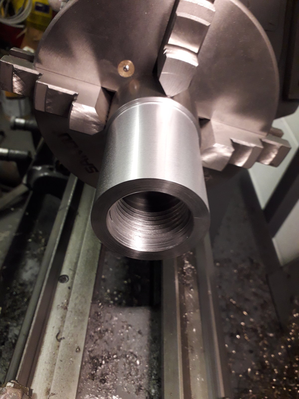

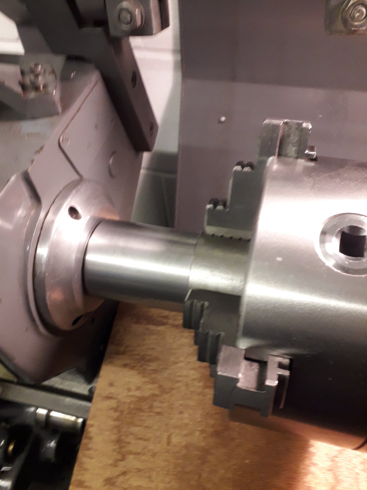

Off today so filled my day in making a collet chuck. Started at 10 this morning, next thing i knew its 10 at night. Anyway some pics.
I even made a plan.

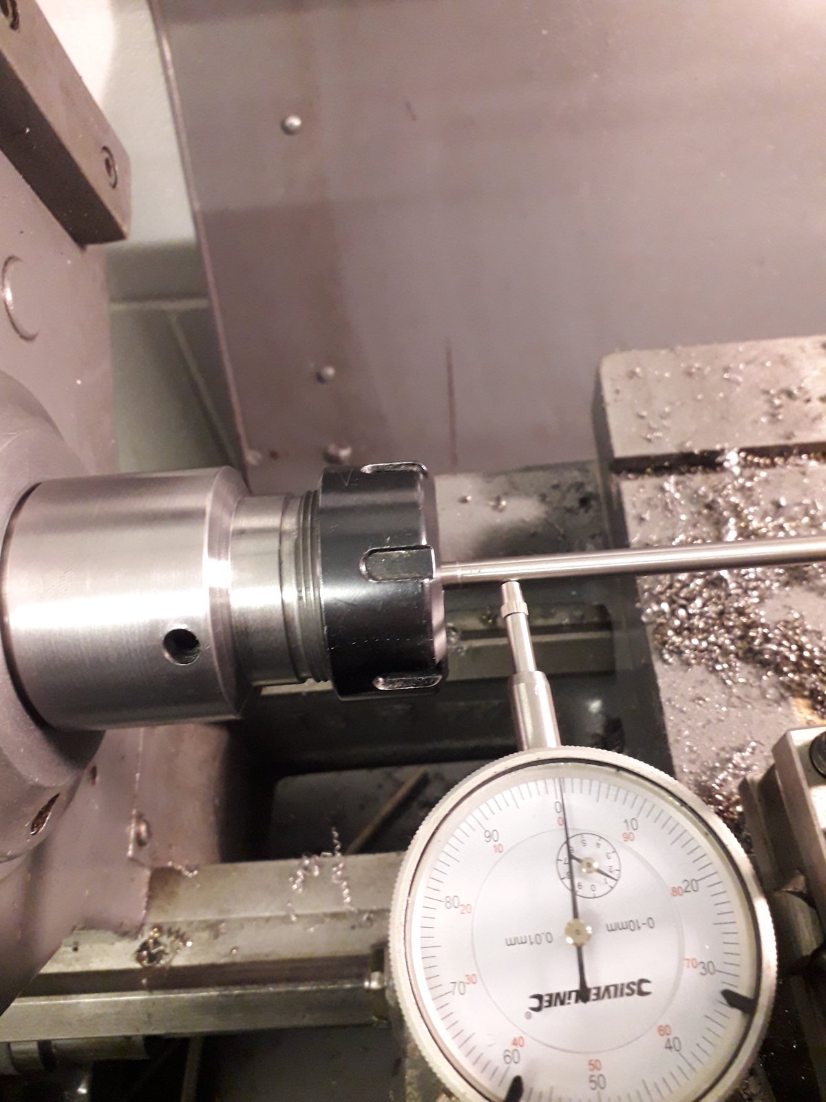

Its got 1/2 tho runout is that acceptable. It will do for the work i do but i wanted it to be bang on. I will blame it on the chinease collets and nut.
