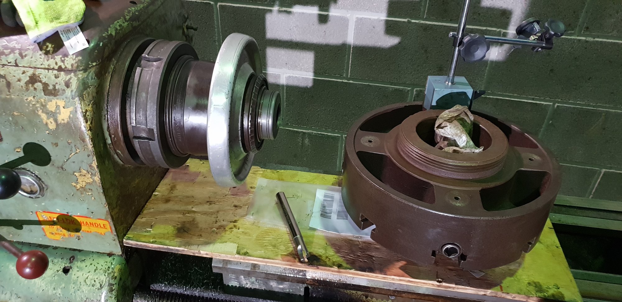

These look like nice chucks.

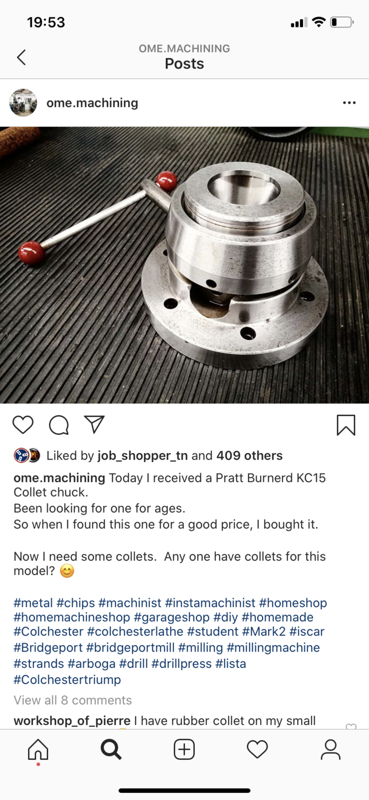

I have one of these as well, its designed to fit a D1-3 mount. Its accurate and repeatable and goes up to 1.5" but the biggest issue for me is you cant grip short lengths easily, my go to is my 5C system, maybe not as versatile as you need a collet for every size and they only go up to about an inch but I still prefer it, great for holding soft materials as well.
