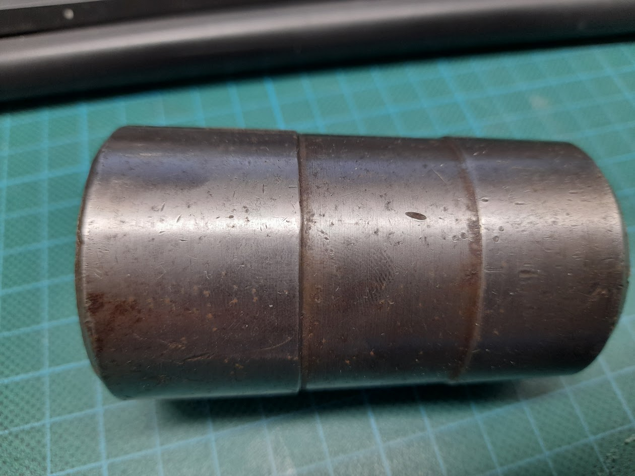

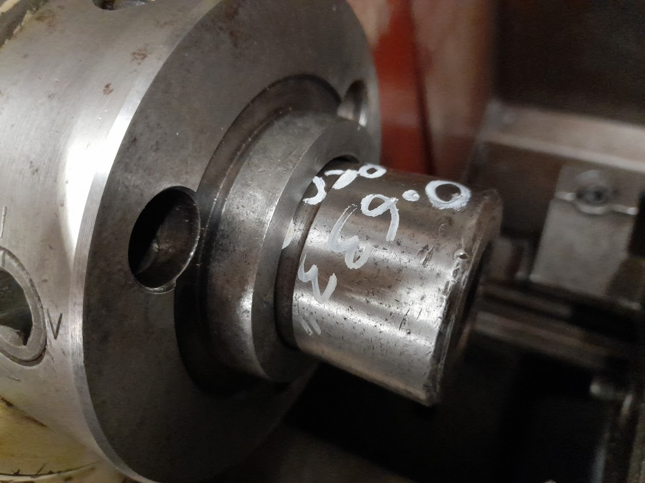

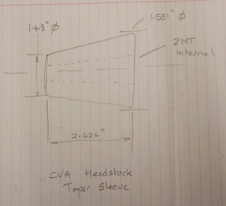

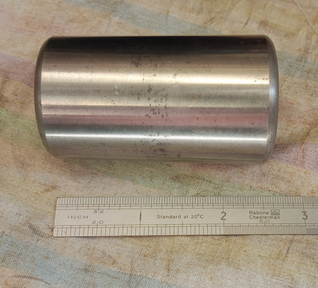

A guy contacted me via the Internet - he wants a headstock reducing sleeve for a Colchester Student. I don't know whether he has attempted to measure the internal headstock taper but I seem to recall this is not the MT5 taper found on a Harrison M300 lathe. In addition to some MT5 sleeves, I have a few other headstock taper reduction sleeves in my "spares" drawer so I attempted to measure them this evening. My method was to mount them between centres on my M300 and using a DTI measure the taper per inch by traversing the saddle by exactly one inch (I used a gauge block and travel stop). This gave me a taper of 0.05275" per inch which equates to 0.633" per foot.

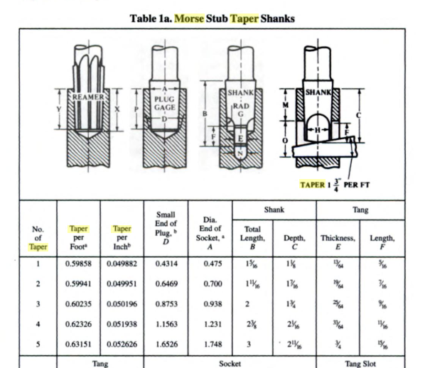

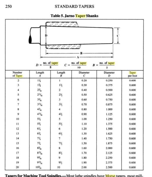

The measured taper is very close to MT5 but the sleeve is just slightly too big to fit my M300. It is tricky to take useful measurements of the sleeve big end/ small end diameters due to the end bevels. Initially I thought this could be a Jarno but looking at the tables again I don't think this is likely.
Any ideas?
