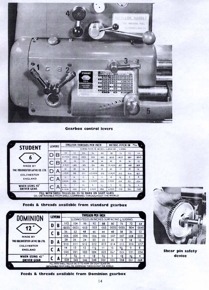

I have the same model as this, do you have a manual and parts manual by any chance. thanks Daithis is my model i know how to read the chart for threading just cant seem to get the feed rate slowed down
