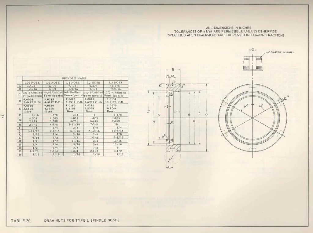

...I've had a very grainy version of that for ages...
Have some more:
https://www.scribd.com/document/425915595/spindle-noses (Table 28 and 29 precede the one above).

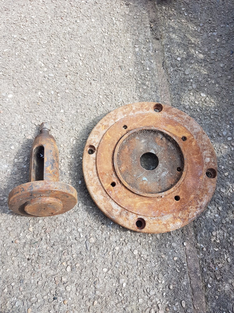

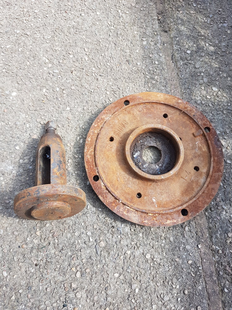

That's what I thought, just not sure how or why. I guess it had a specific purpose and it may be useless for anything else.The thing that's next to the lantern toolpost looks to be an adapter plate for between a chuck and a backplate.

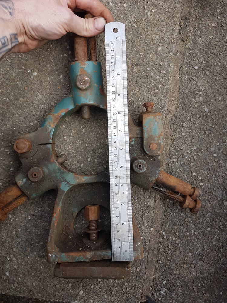

They are in the bottom of the tank cleaning. Dumped them straight in after I took the pics.Some dimensions may aid matters
Did you get to the bottom of what they fitted as I am after one for my Colchester master 2500.They are in the bottom of the tank cleaning. Dumped them straight in after I took the pics.
I'll pull them out tomorrow, measure, and look for numbers.

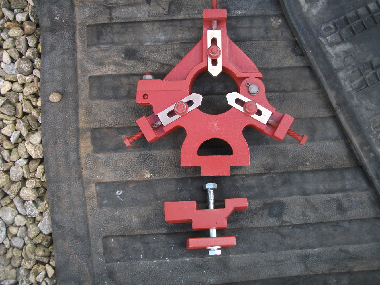

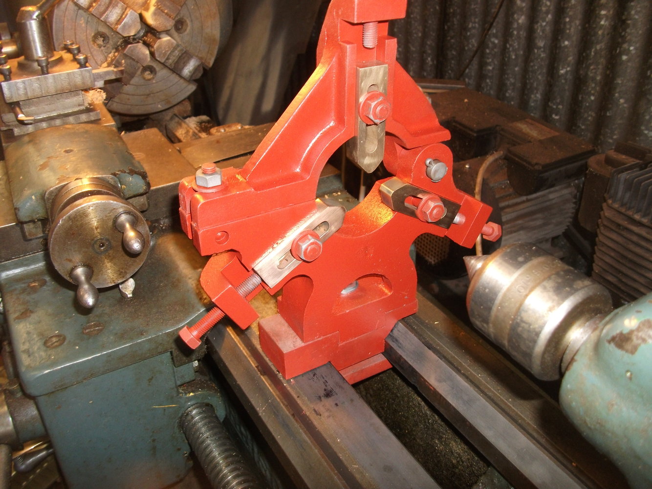

Ok thanks. I will keep looking thenThey are 6.5" center height, from a roundhead of some description.
Seems both students and masters could be had with 6.5" center height and t slot carriages so could be either.
I can make them work on my fortis lathe though, although I may swap the travelling steady for a non t slot version.
I'm amazed how much money people ask for them.Ok thanks. I will keep looking then![]()
Yep even if you can find one prices see insane.I'm amazed how much money people ask for them.
Fixed steadies people seem.to want £2-300 for.
I'd assumed they were just chancers bit they all seem to be asking that much. I've seen them go for alot less, they don't seem to make that much when auctioned.
It might be worth seeing if roundhead ones will fit your lathe as the squarer steadies for the later lathes are even more money!

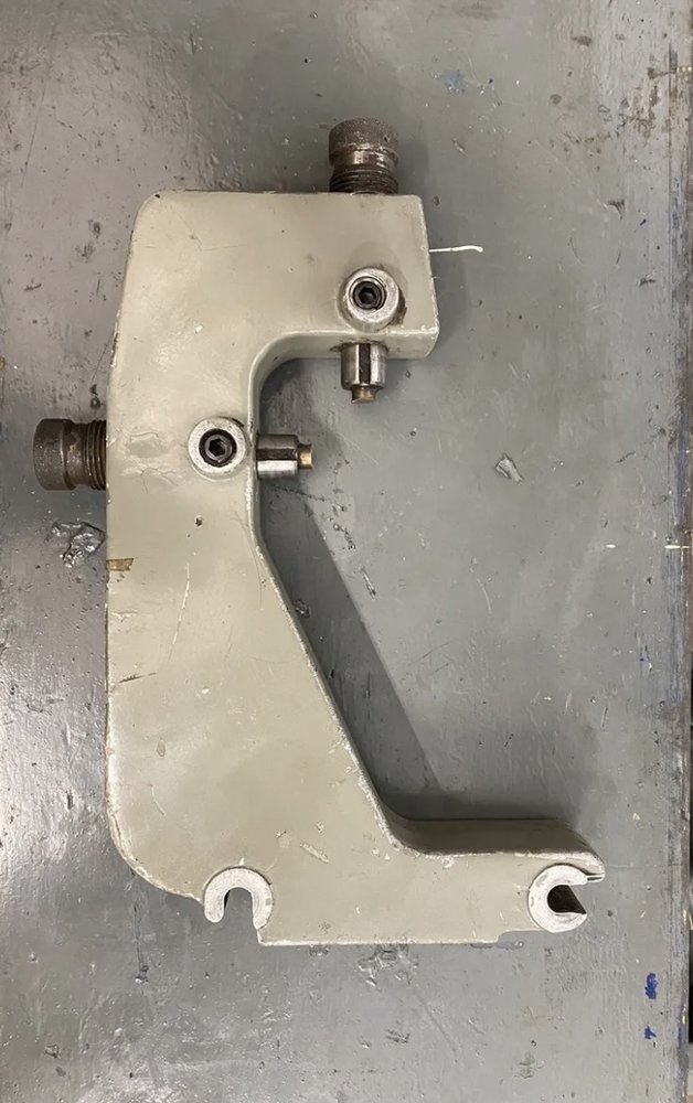

"Lathe steady vintage" has just been listed on ebay if its any good to you.It would be if my bridgeport had not thrown a wobbly.![]()
Good call but I have materials sorted now thanks."Lathe steady vintage" has just been listed on ebay if its any good to you.
Not mine, but could be a reasonable starting point.
