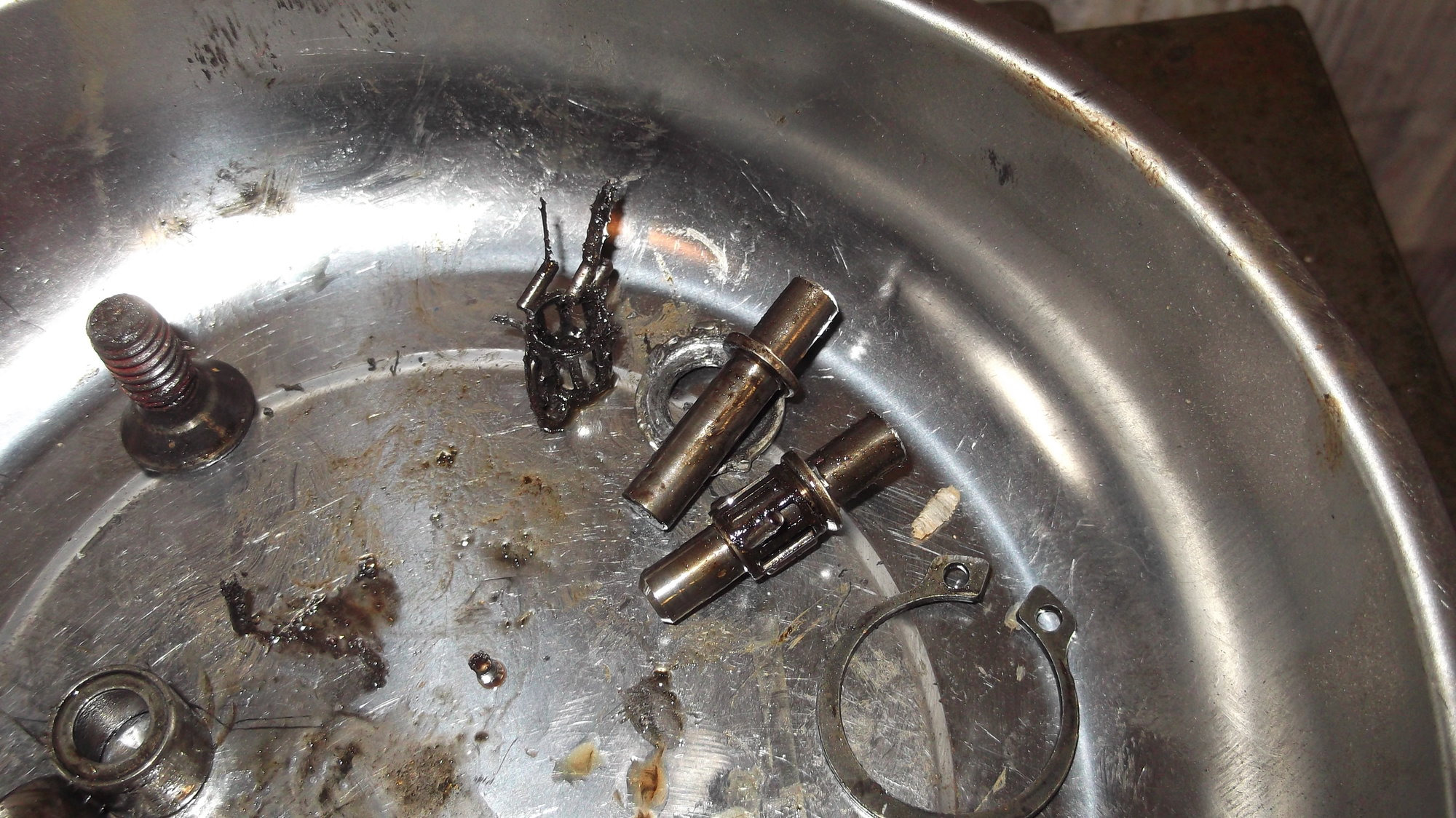

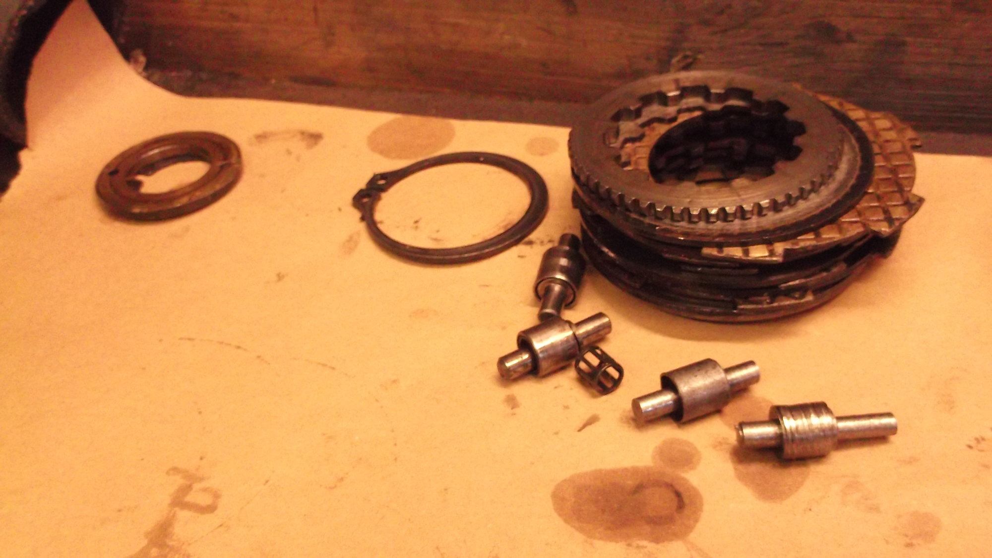

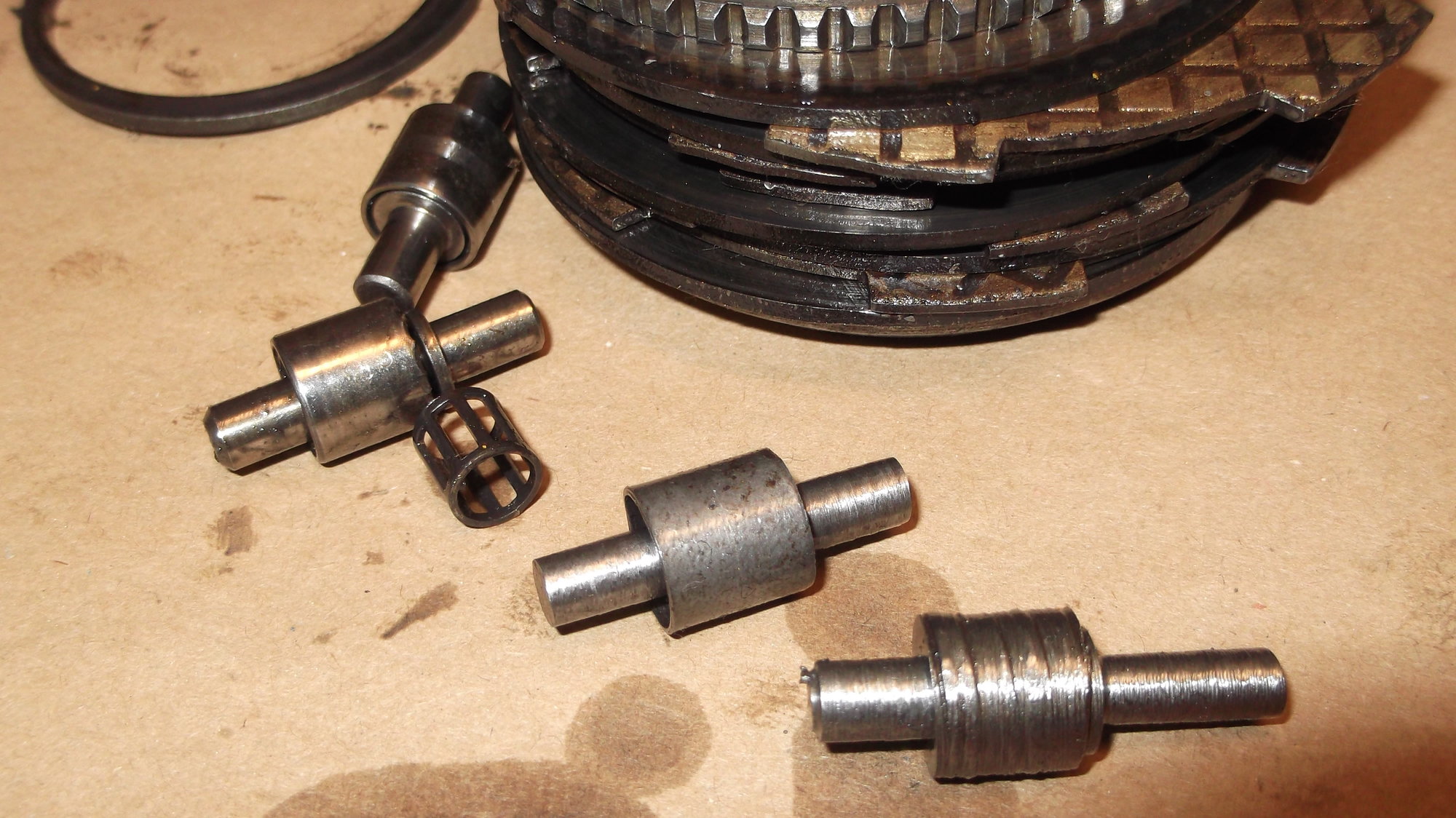

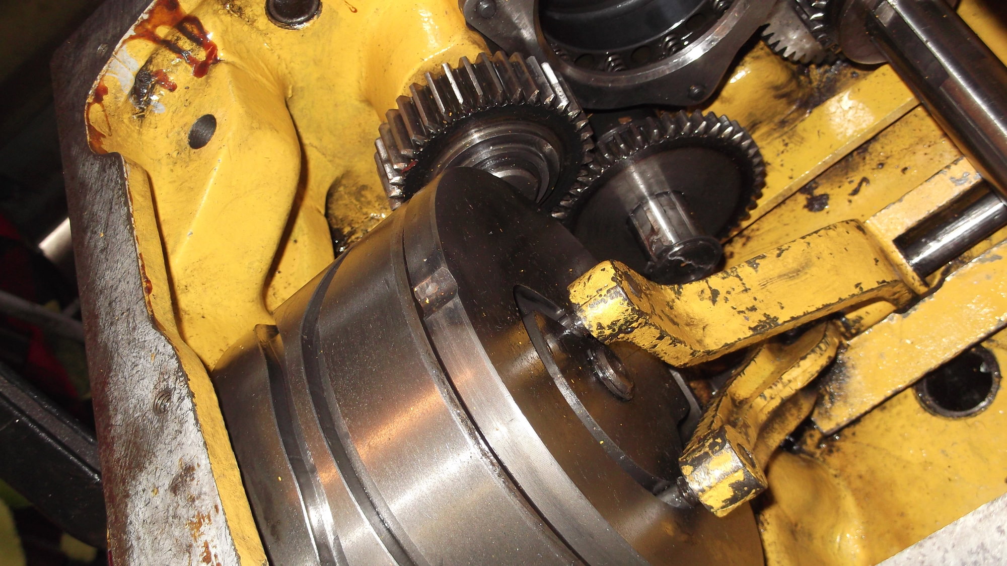

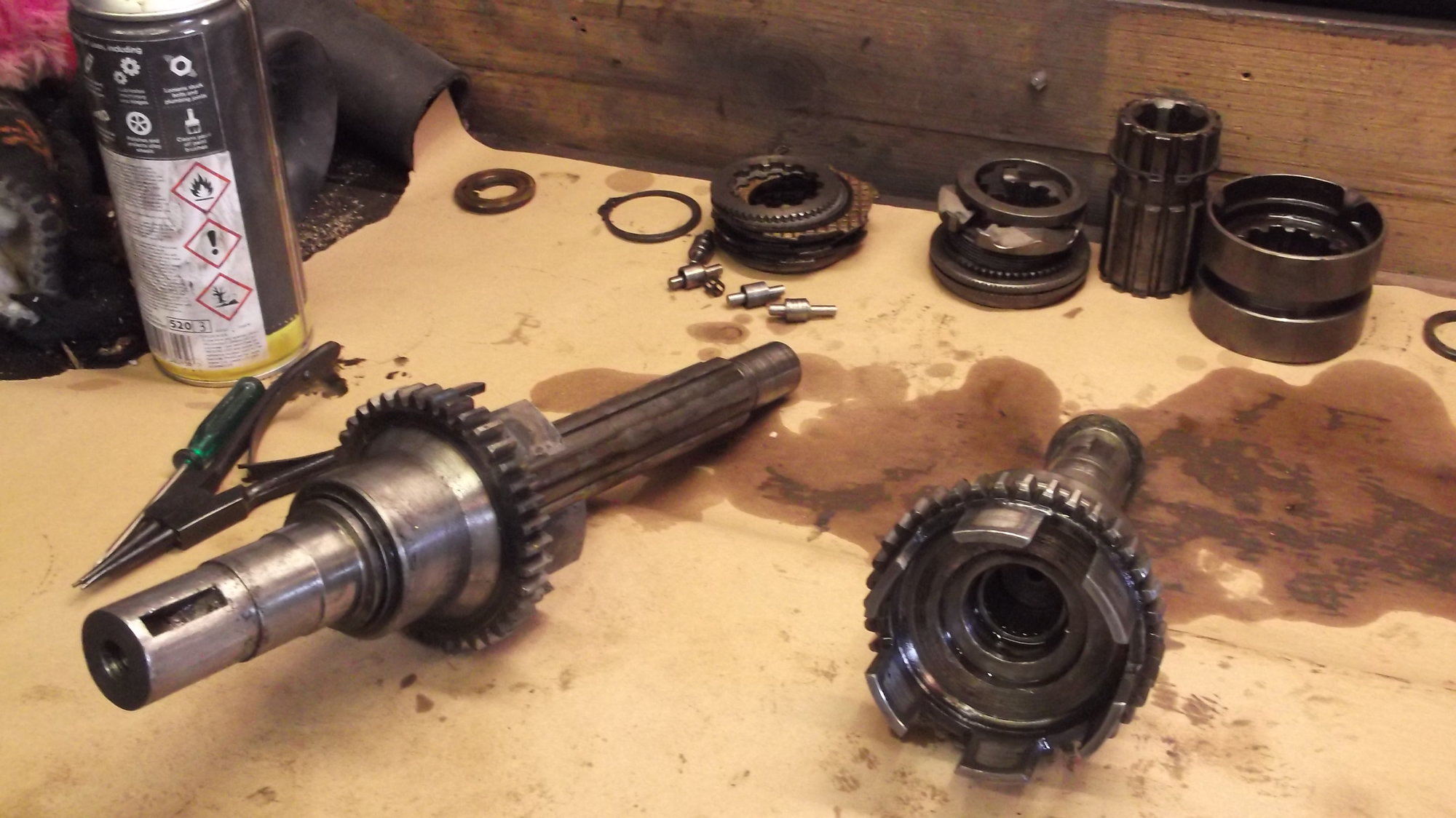

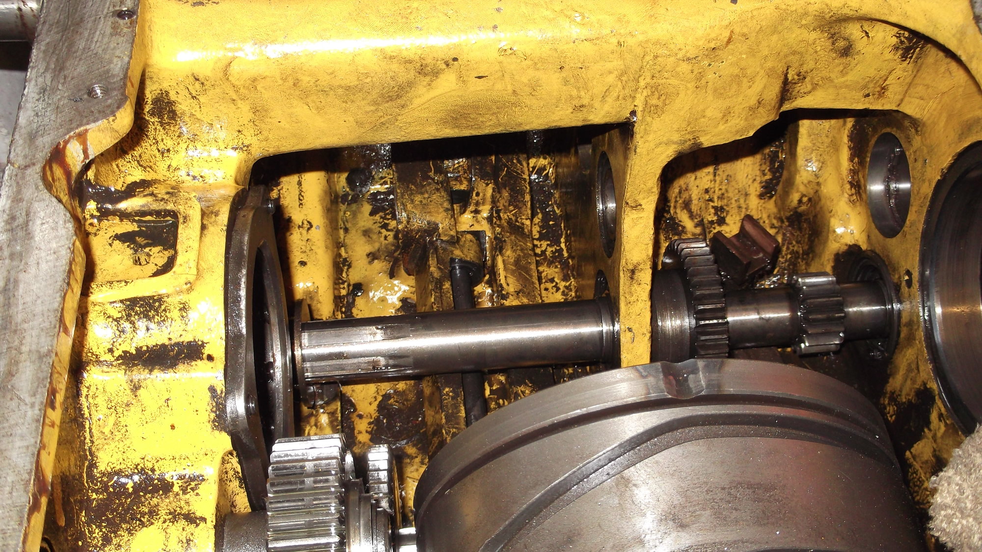

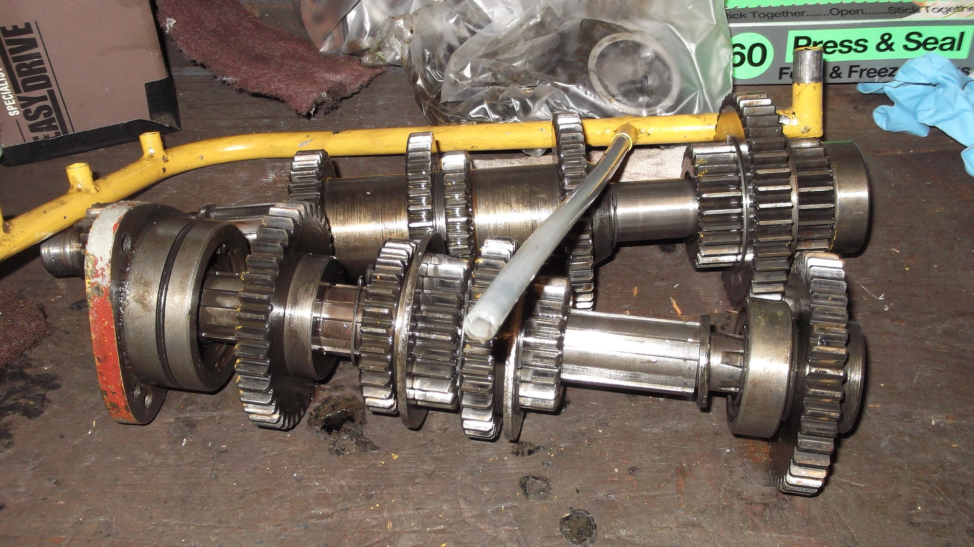

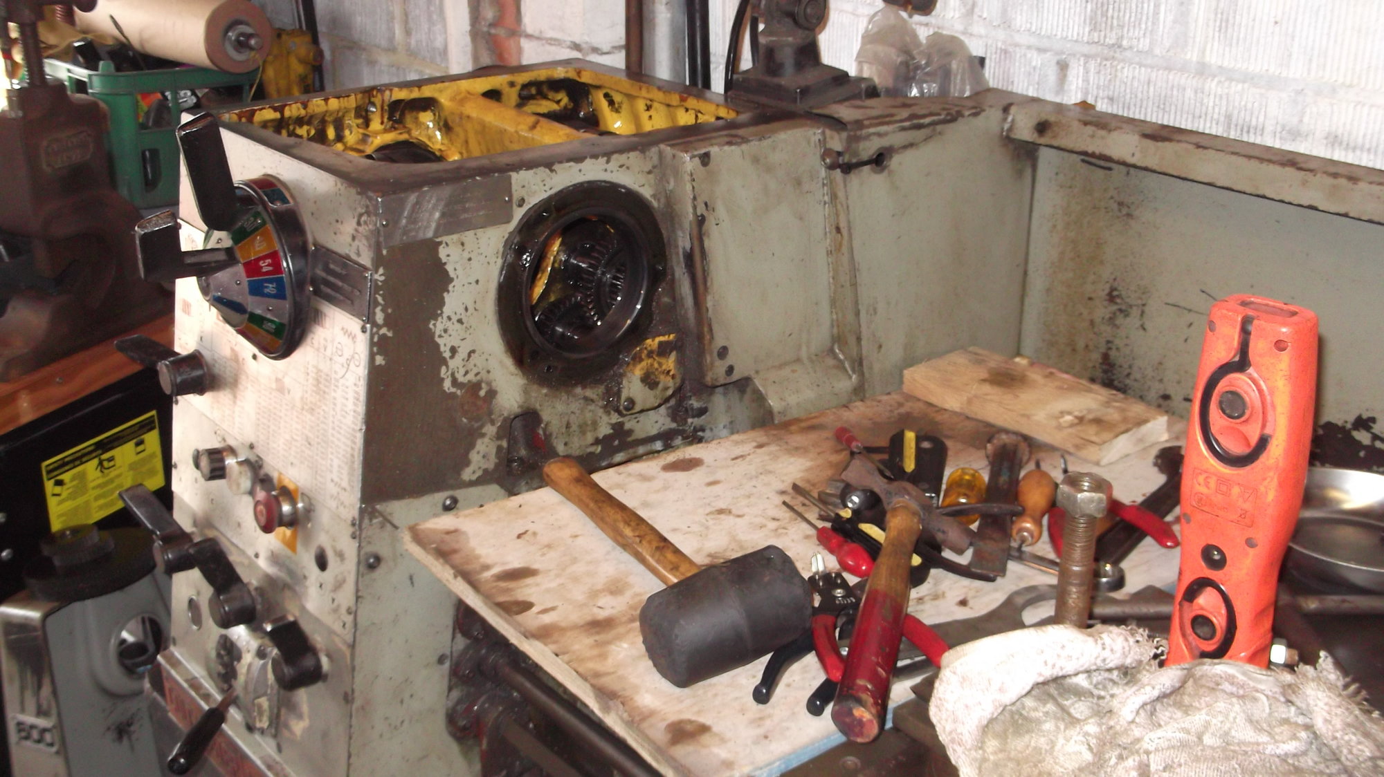

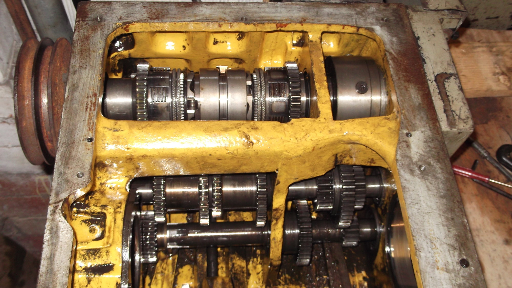

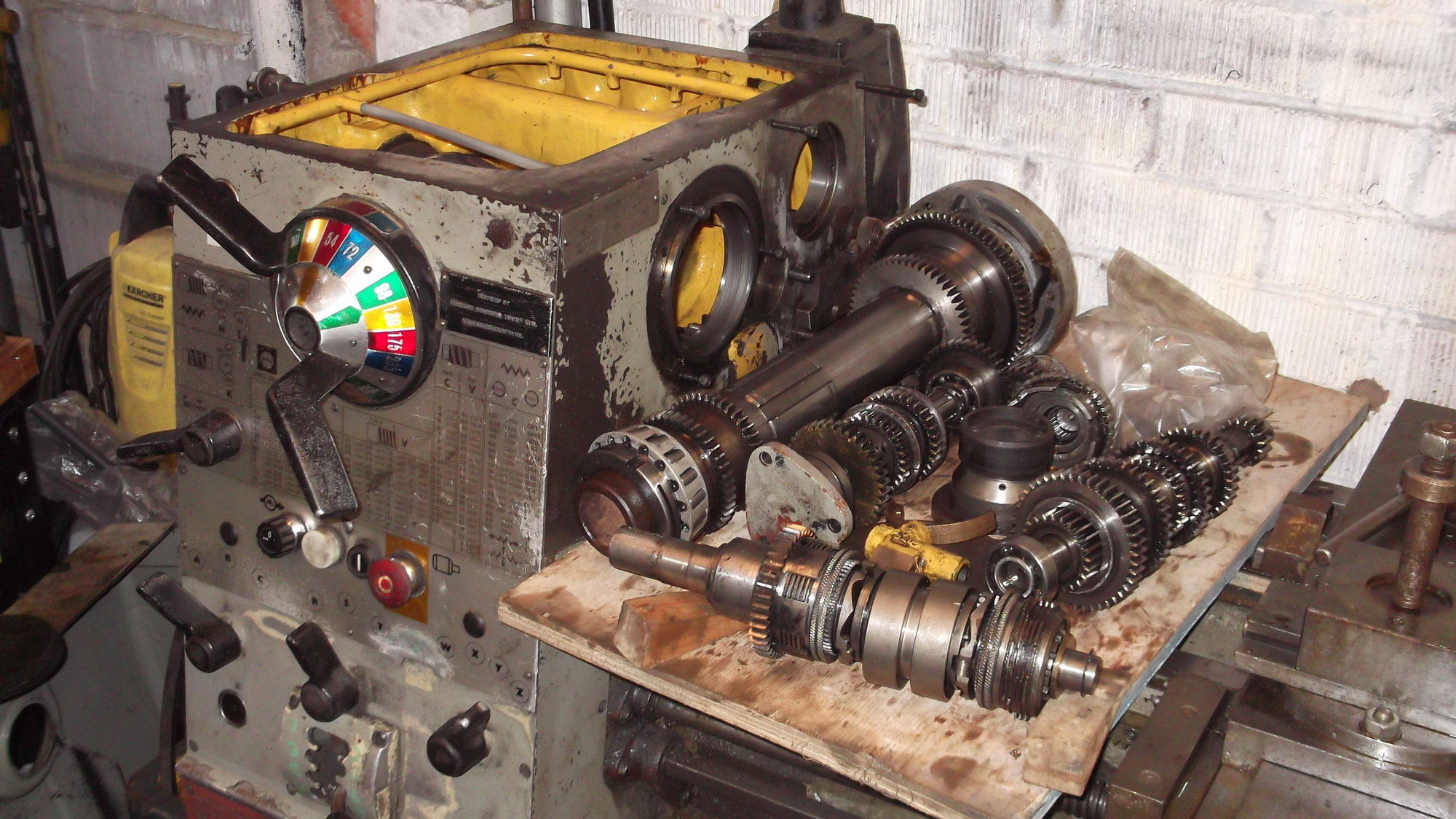

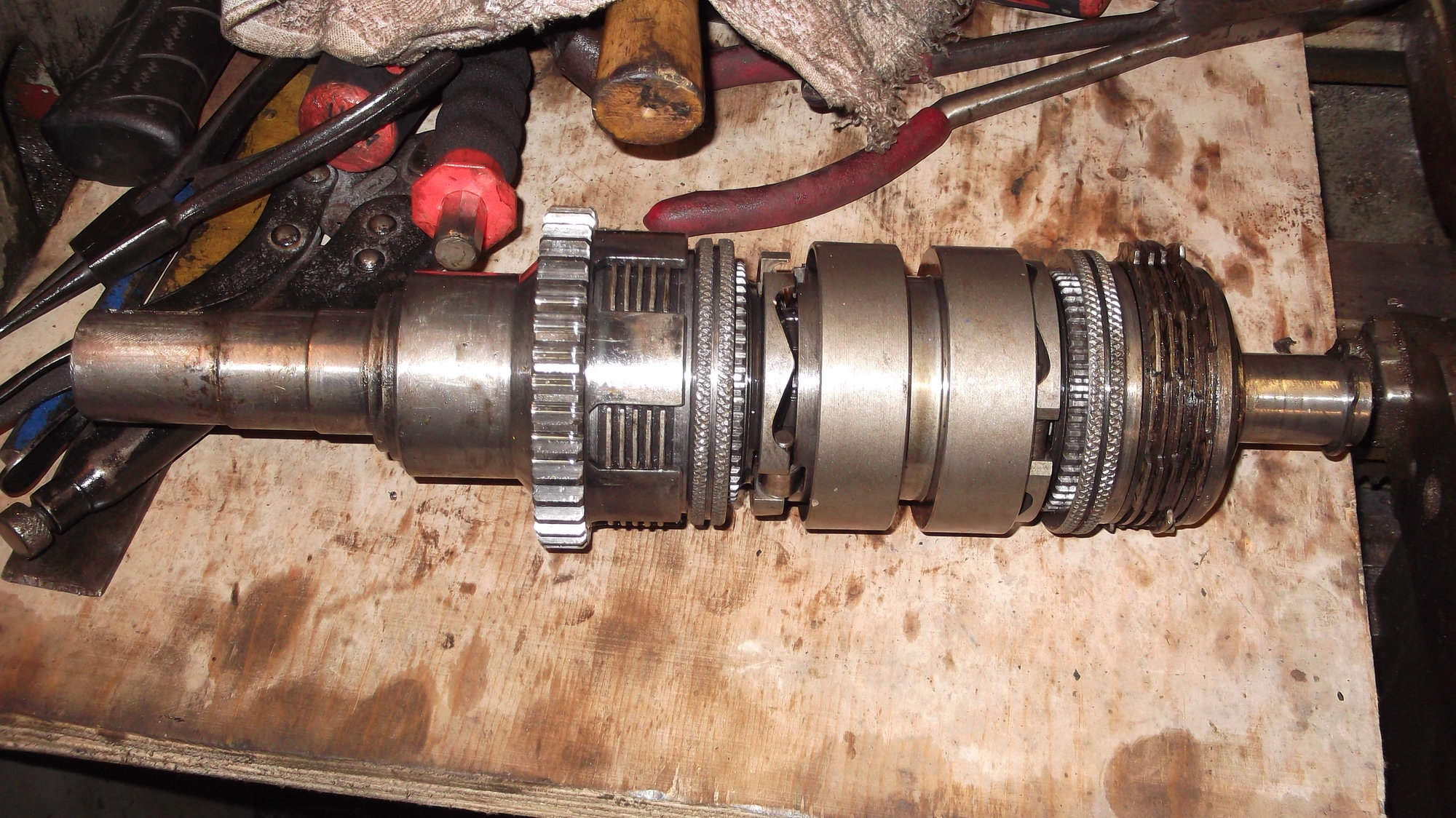

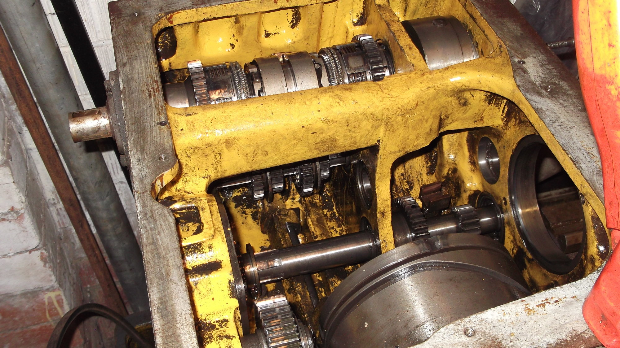

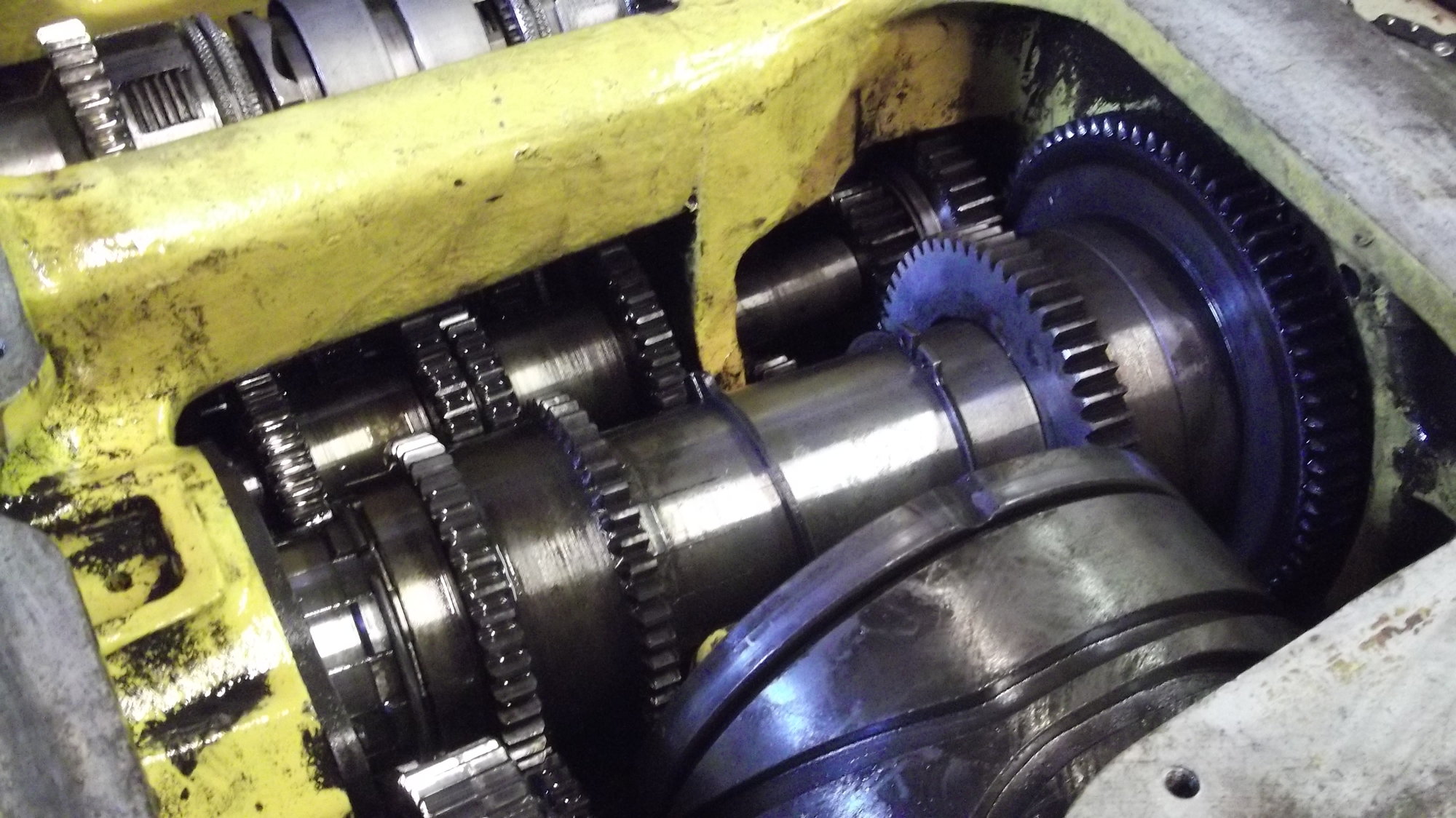

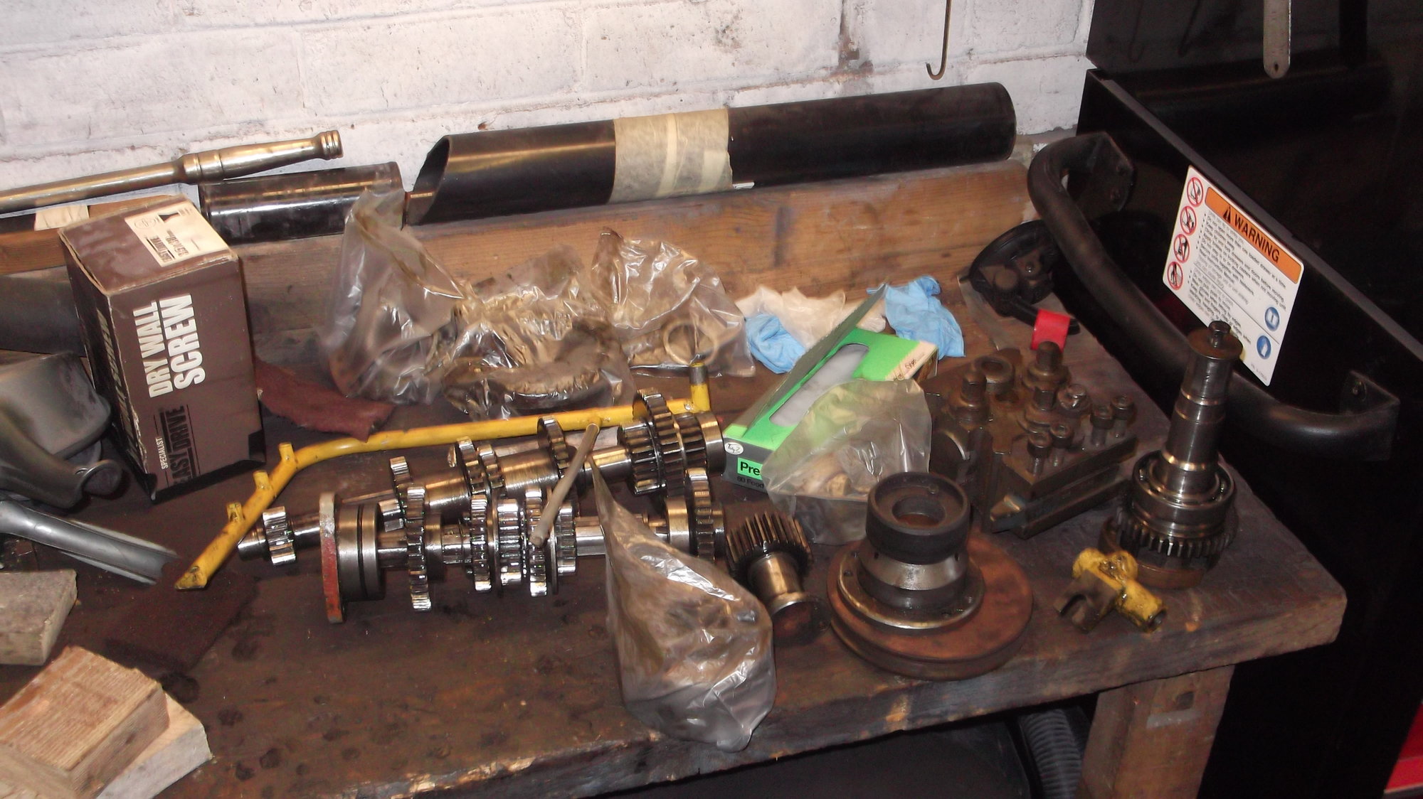

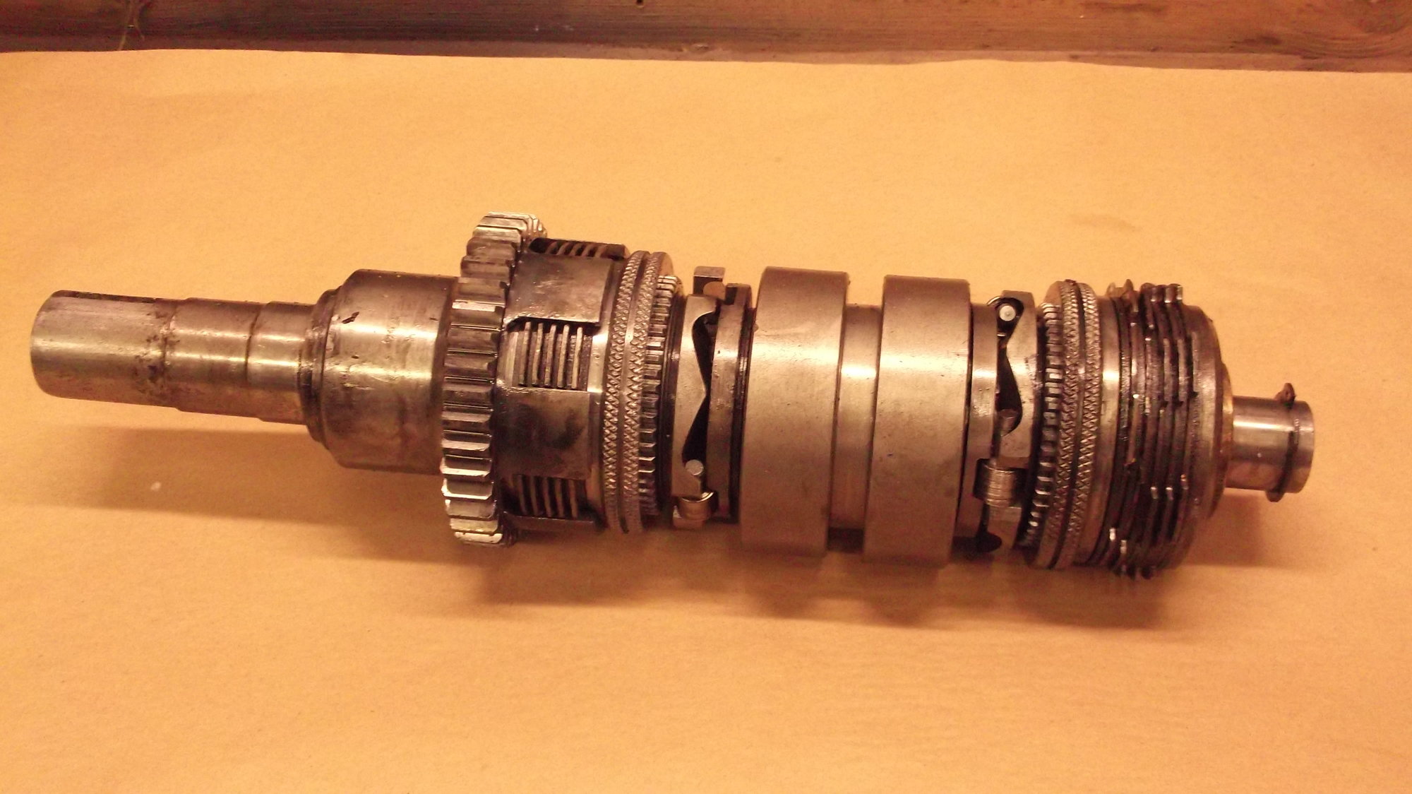

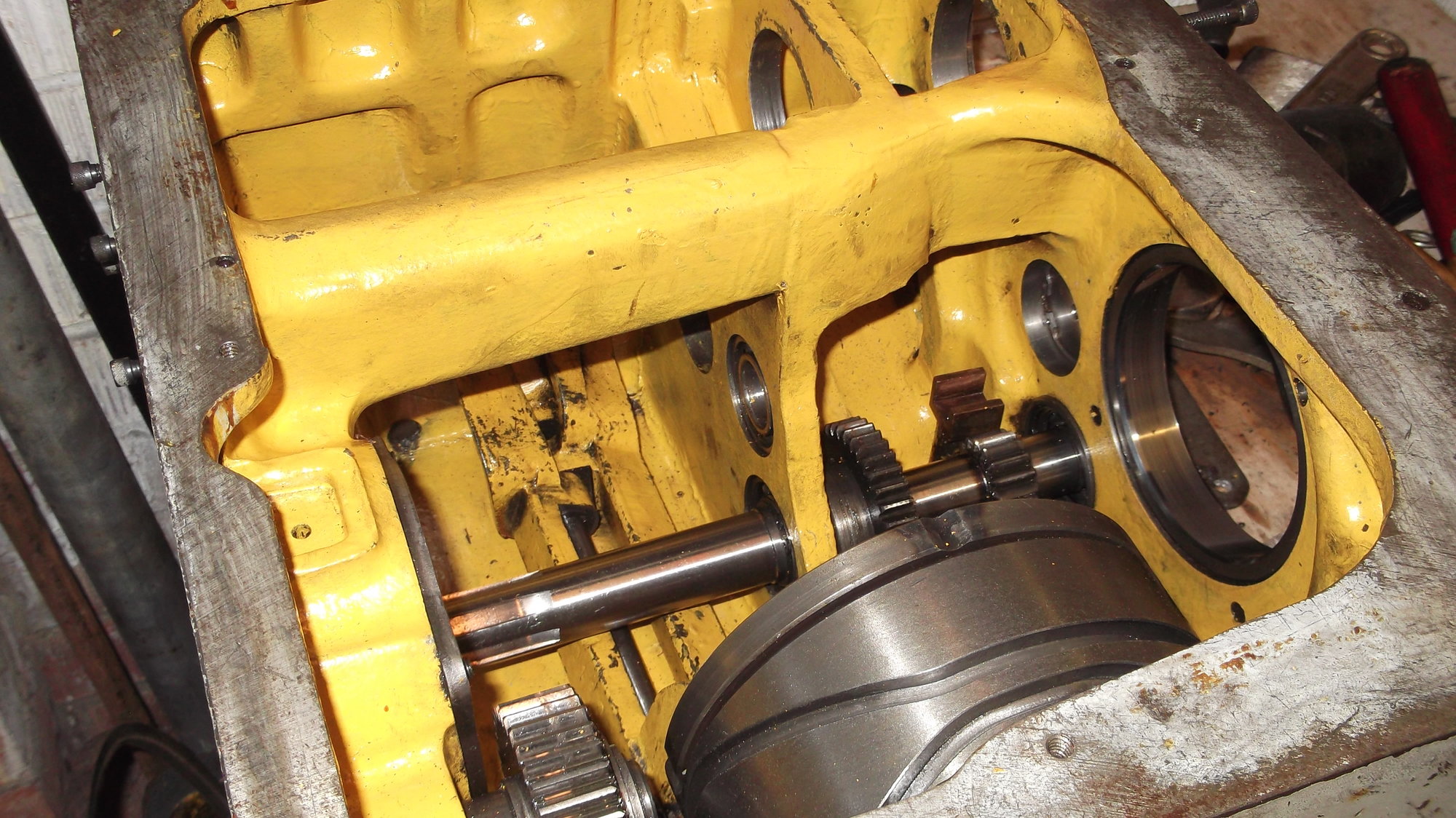

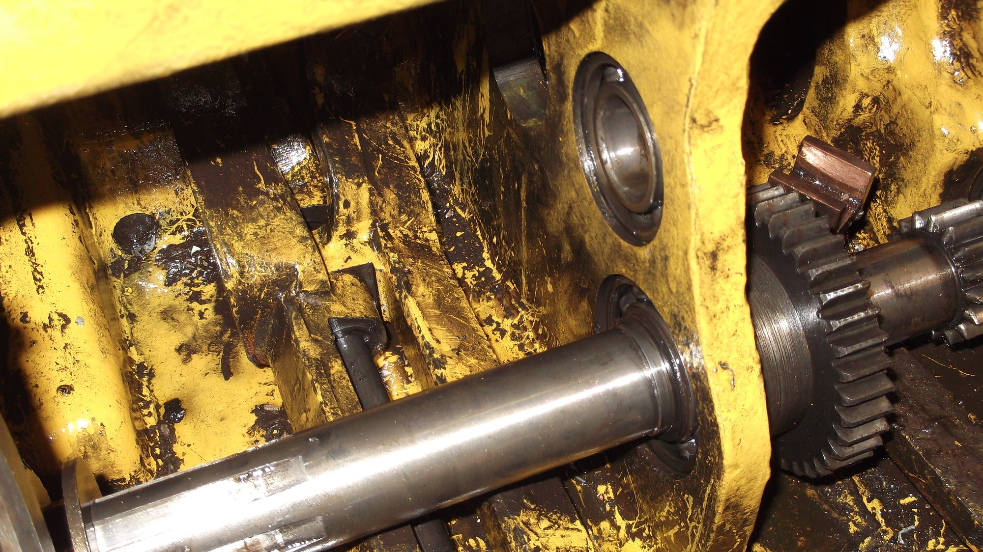

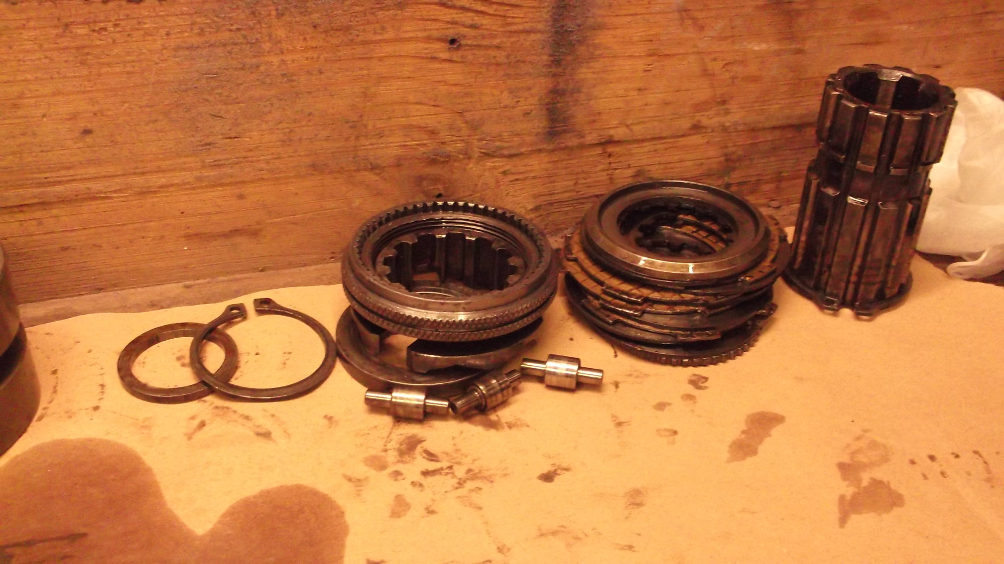

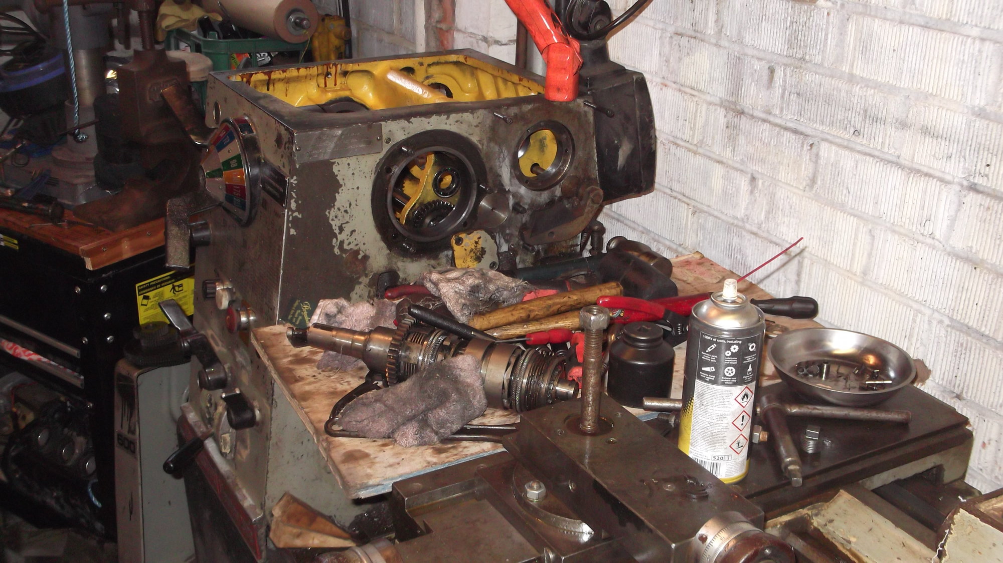

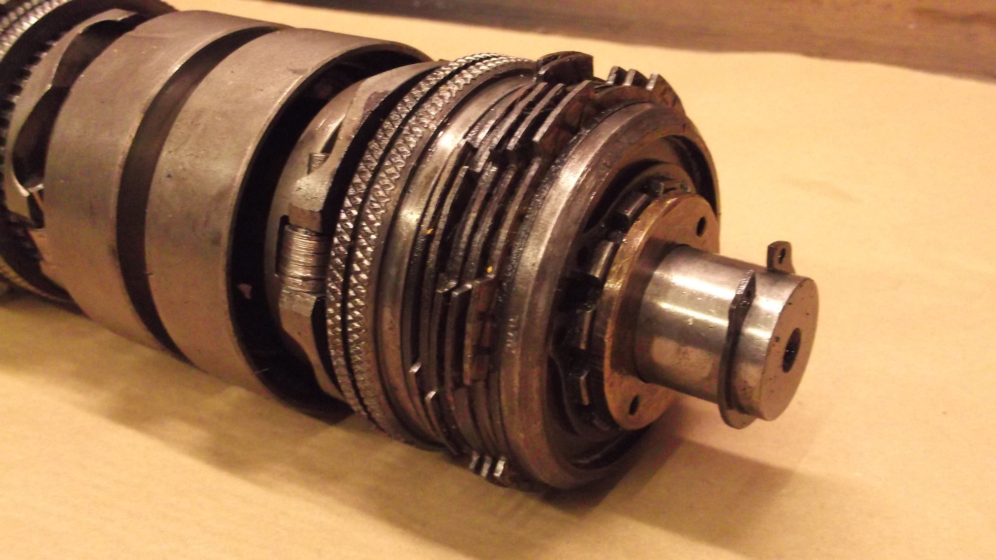

Evening everyone, a rare post from me but it may be of interest to some folk so thought Id stick some pictures and stuff on as I go along the way.

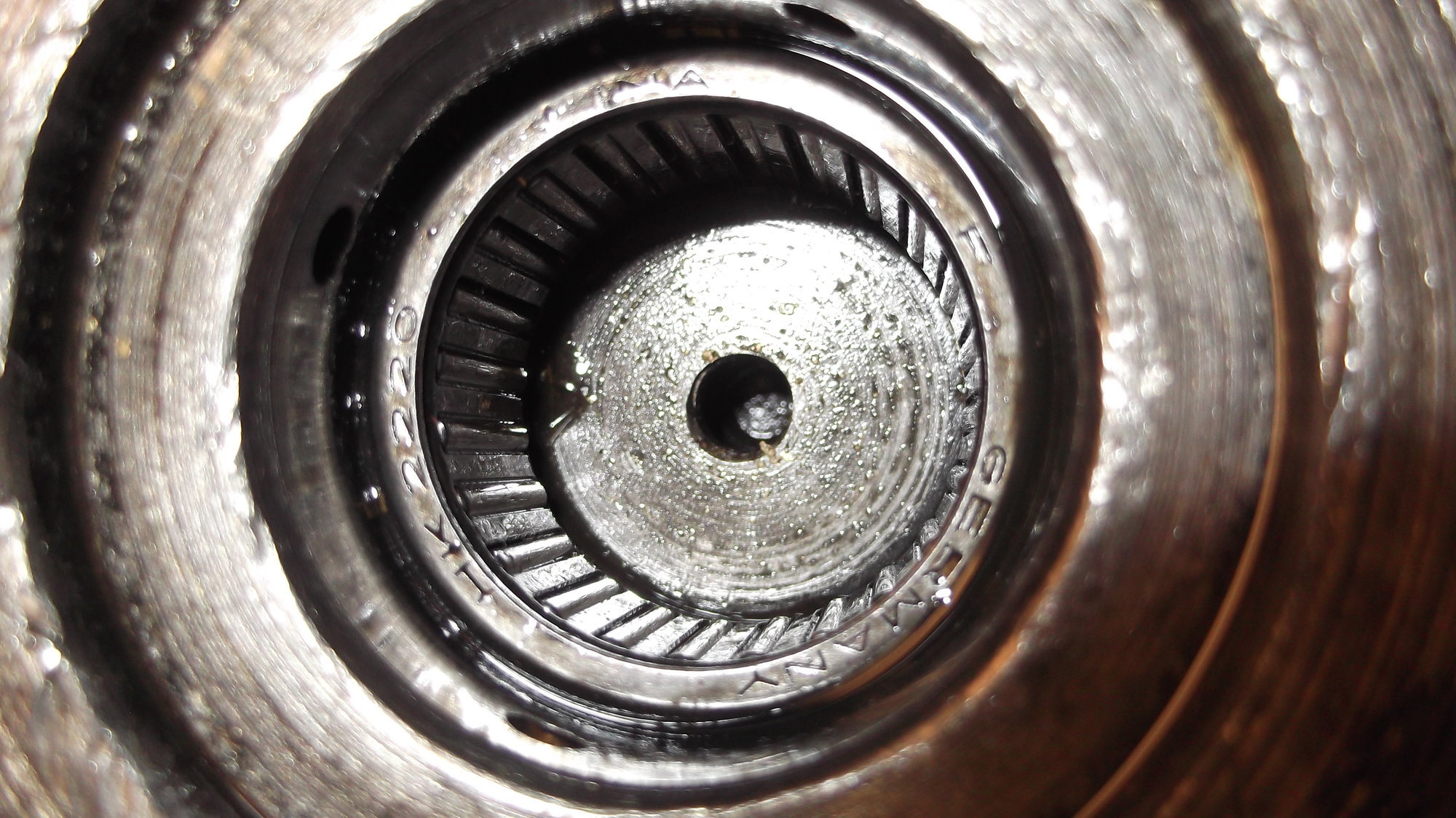

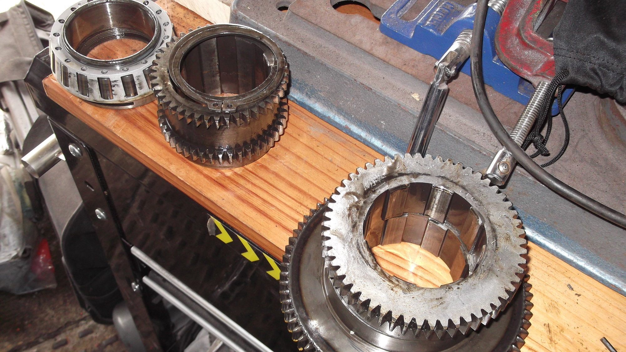

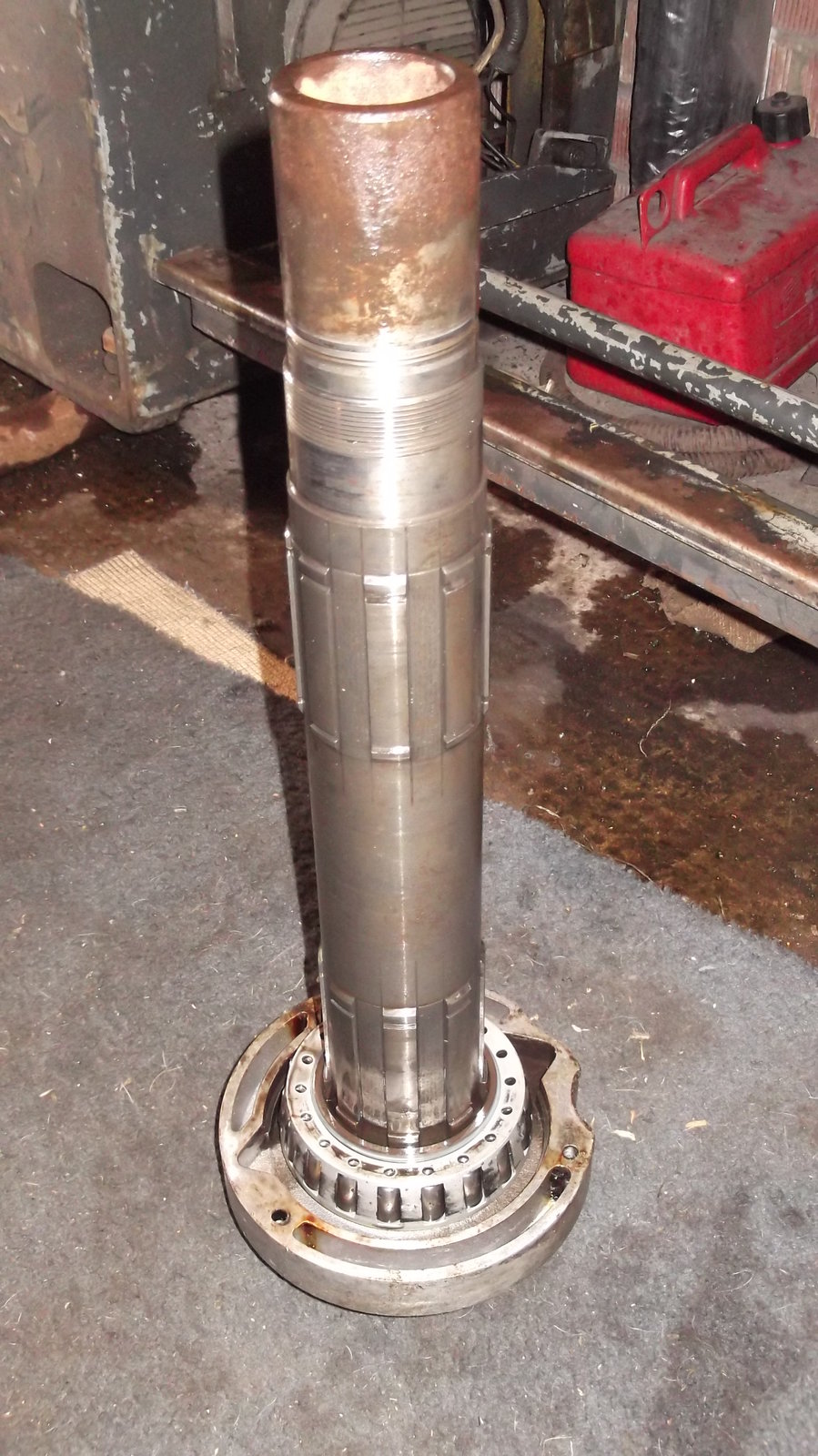

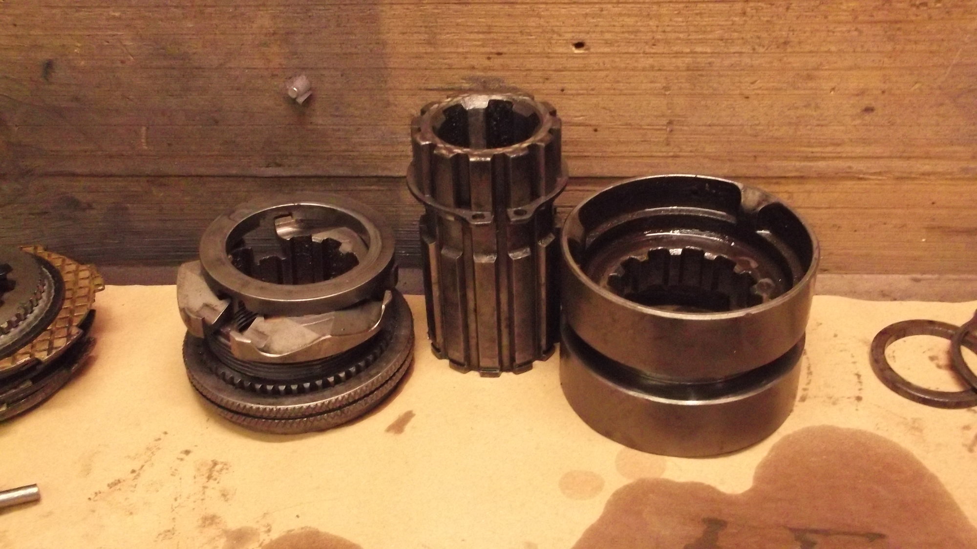

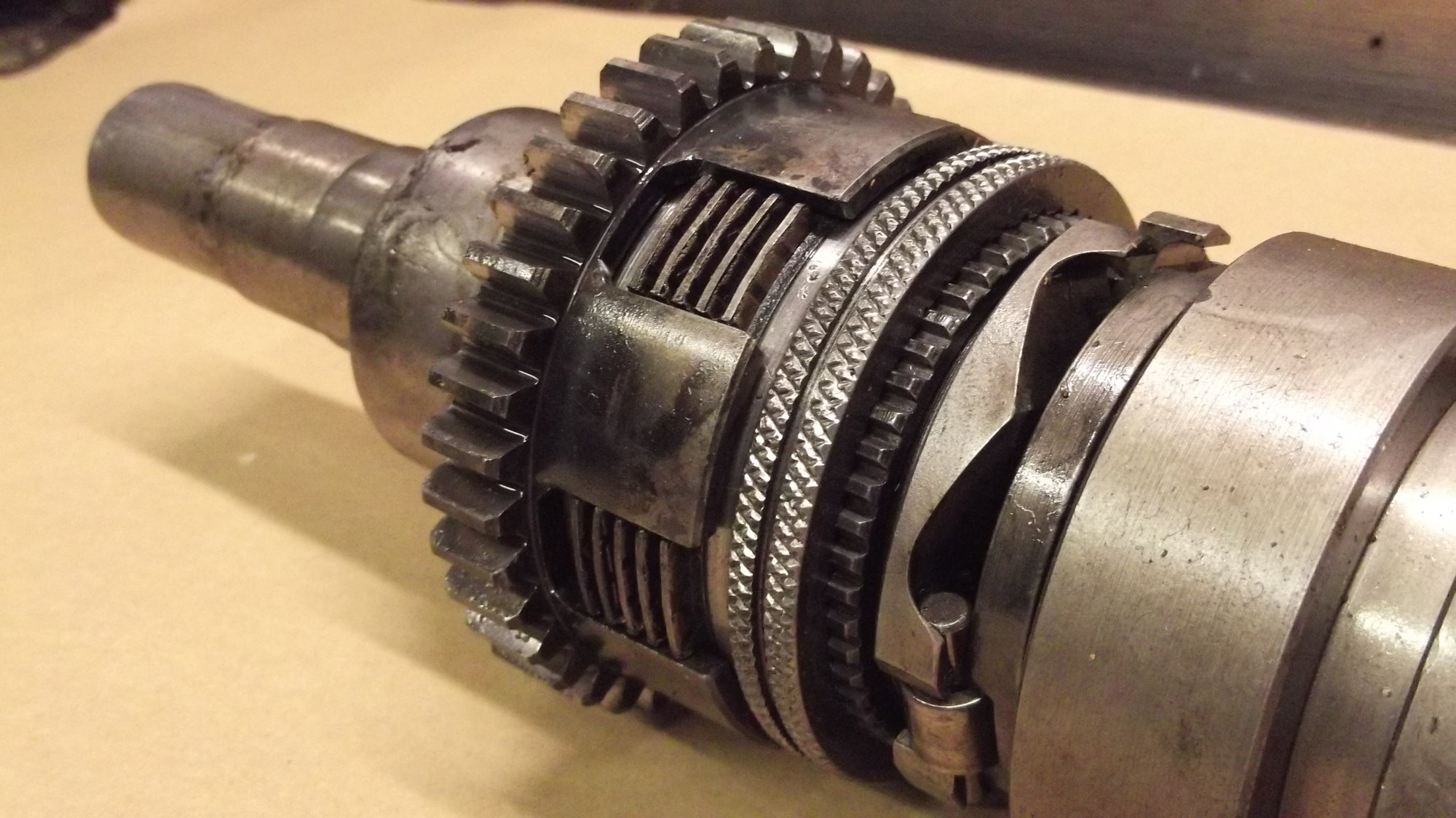

So the story so far is, I was looking to buy a lathe for the garage at home and a few month of looking but never saw anything local that was floating my boat. I happened to mention to a retired friend of mine that I was looking, and knowing he had a lathe of some description buried in the back of his garage that he used to use when he was building/fabricating custom motor bikes. He said he never used it anymore and pop up for a look at it. Well it was sat in the back with stuff piled on top of it, covered in swarf and grease and generally just bloody manky. He did plug it in and I saw it running, albeit very briefly as I saw no need to run it any longer than to see it function.
What I did notice was that it was very loud when the clutch was engaged and it was running the headstock gearing.
Fast forward to getting it home and in the garage, moved somewhere near where it is going to live and it got a wash down with some diesel and red scotchbrite to clean things up a bit. Then I took the top cover off and ran the motor to see if the oil pump to the top end was working, nope not a sniff. So the pump was removed and opened up and it had a few bits of swarf and crap in but no damage. Refit and fresh oil and the top end was getting oil again.

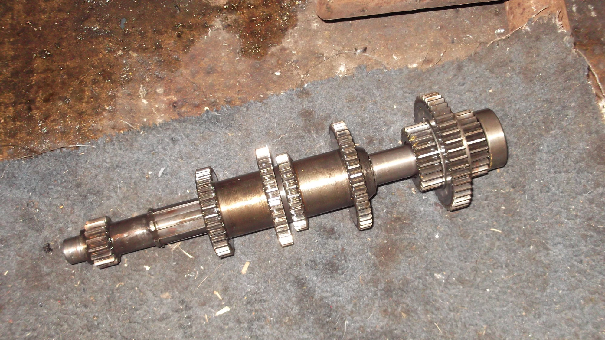

So running the lathe a little while with fresh oil getting up top the noise didnt change but I did notice that it was noteably quieter in reverse than forward. I looked at all gears for damage as best as I could with the top cover off and could see nothing wrong with anything, then I noticed one gear that runs free on a shaft was a very poor running fit and there were brass filings in the bottom of the headstock. That promted me to make the decision to make a start pulling things to bits, if nothing else this needs sorting out before the bushing wears away totally, if it already hadnt, and then it starts mangling the shaft.
View media item 9971
View media item 9972
View media item 9973
View media item 9974
View media item 9975
View media item 9976
