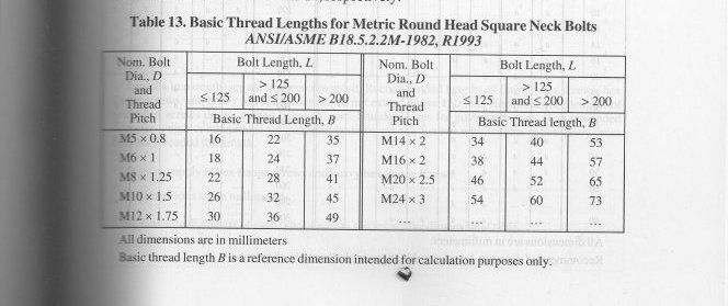

im making up a list of some coach bolts i need for a job ,many online suppliers have partial thread
is there a rule of thumb that gives the percentage of thread /shank for a given overall length?
