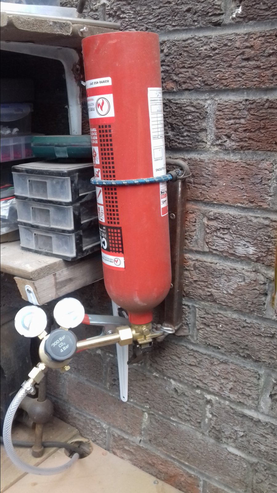

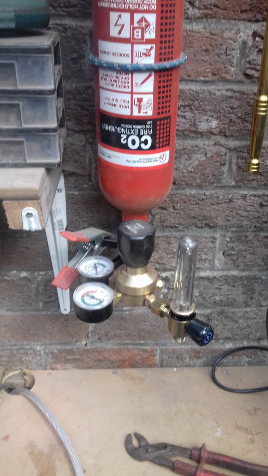

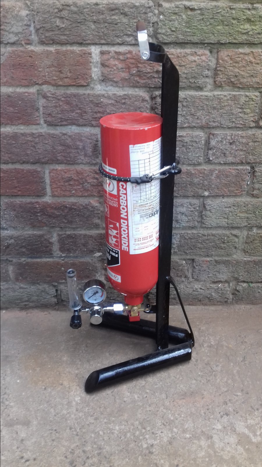

I use parweld co2 regulator for main use and it just bolts on no fuss.
But if you want to add a incline flow meter it sits out abit and need to set the regulator horizontal for the flow meter to be up rite.

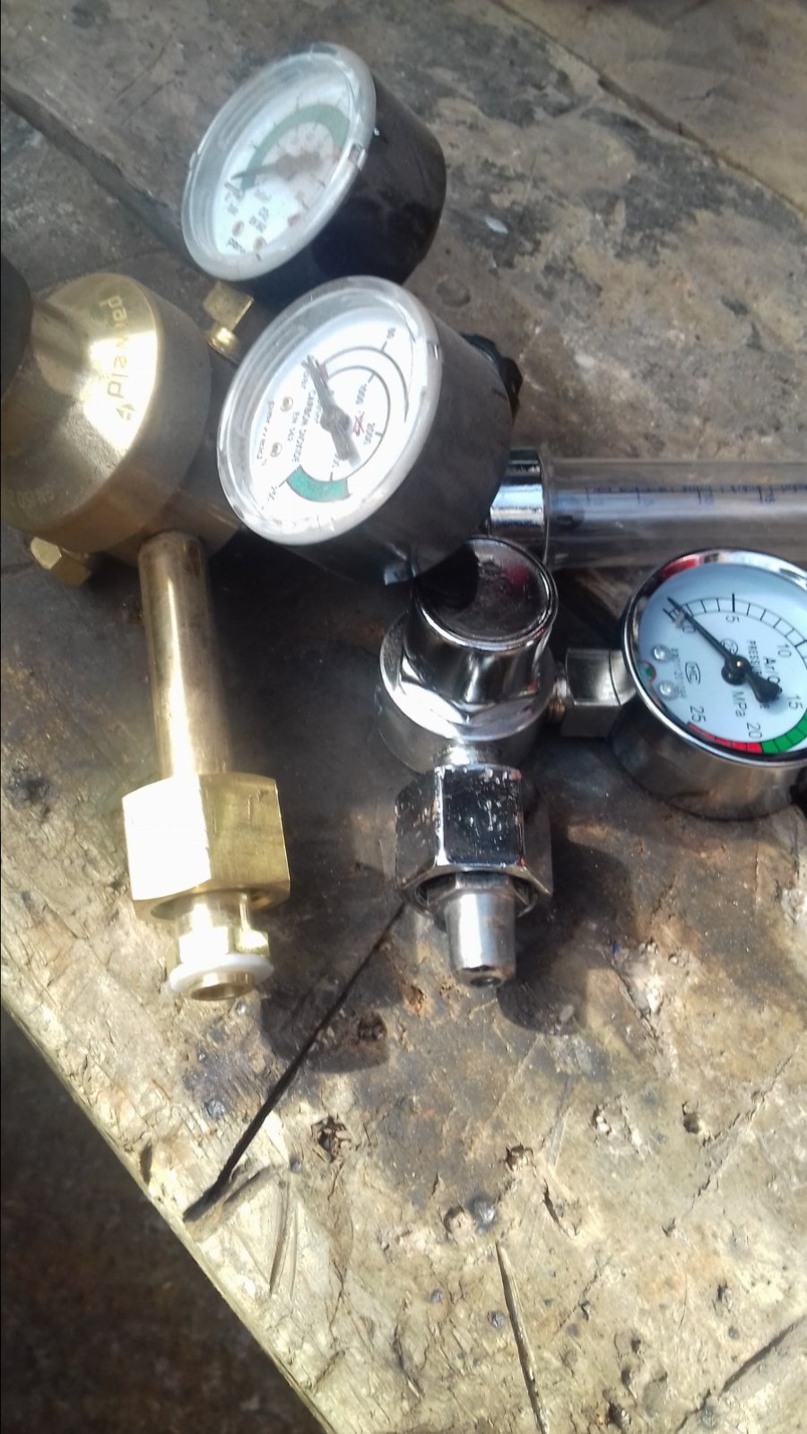

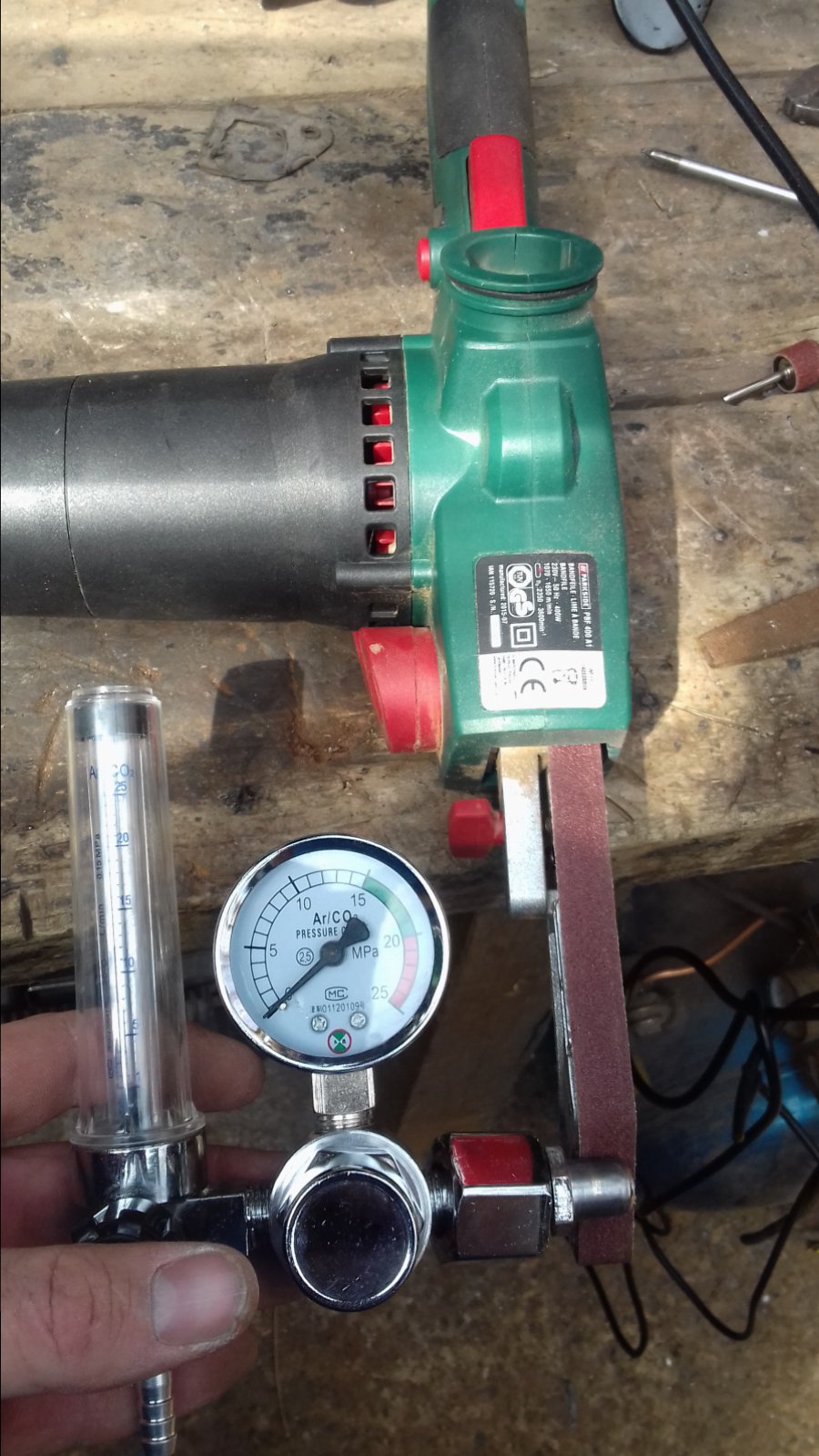

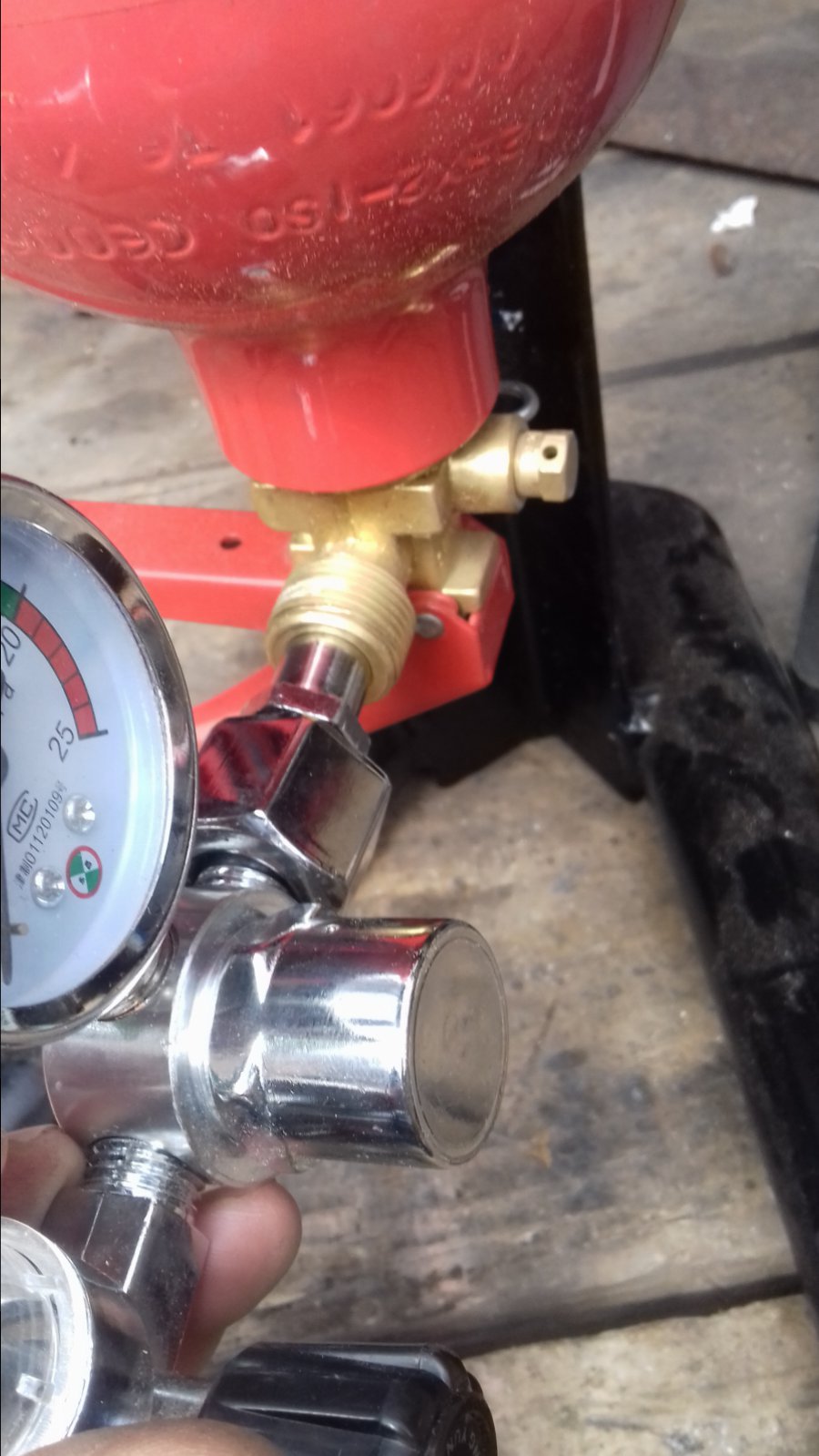

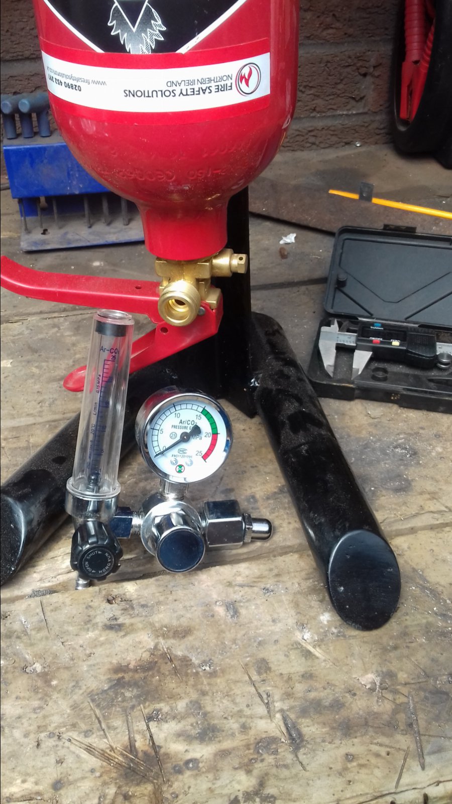

So for my portable stand I wanted a smaller regulator so I order this one
It did not fit rite out of the box like the other one did so I use a par file to take it down 1 mm
Now it work dead on and fits the stand better.
Hope this can be useful for some one
Thanks Aaron
