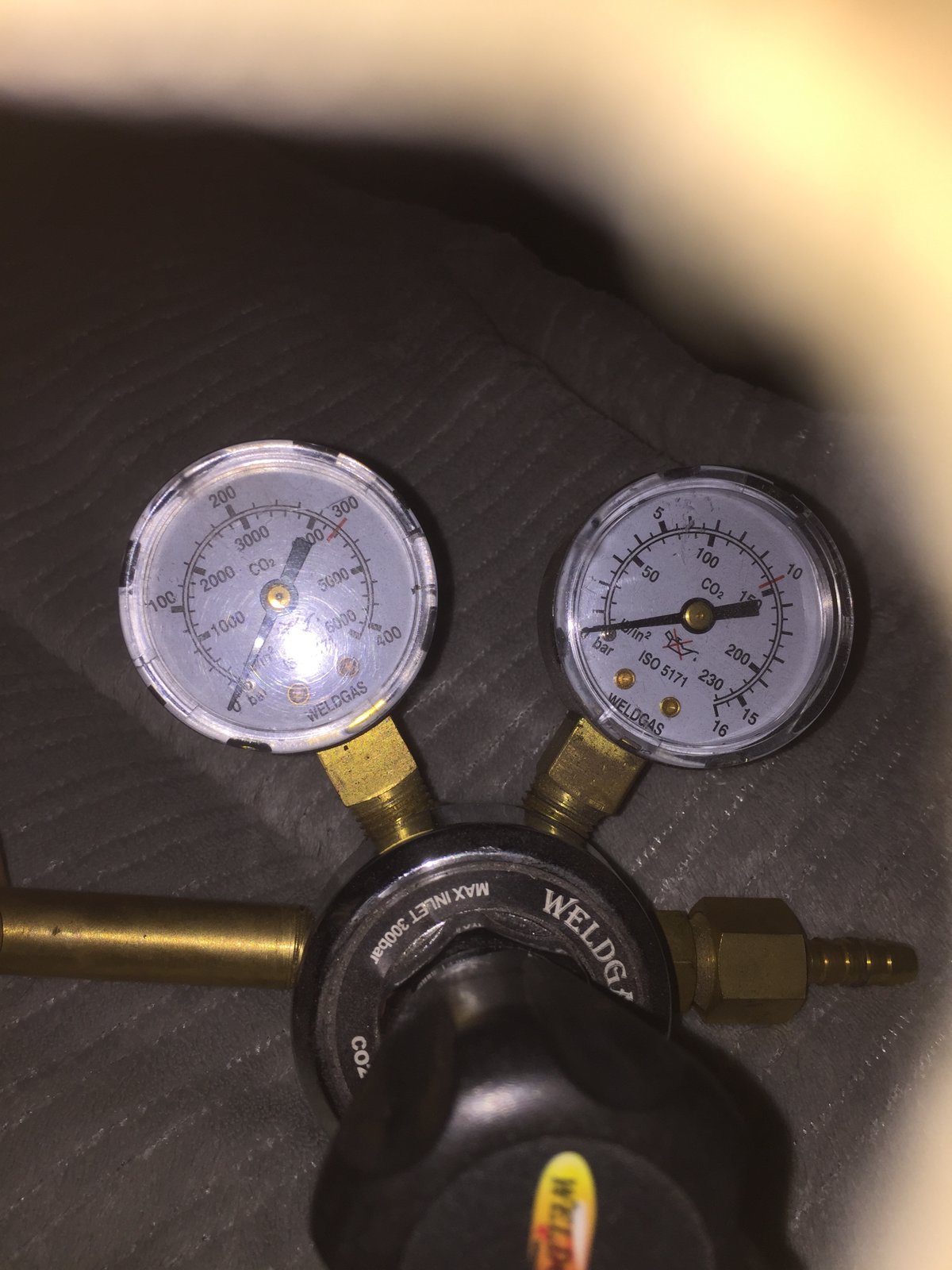

Do you no roughly where I need the second gauge setting to with the trigger pressed I’m used to a flow rate meter never used one of these.there's contents gauge and regulated output pressure gauge set in 10 psi increments to set the output flow
Thanks for your help I thought something wasn’t right with those gauges..so I should be able to get a flow gauge from eBay remove that second pressure gauge and install the flow gauge there ?Not very accurately!
The gauge on left is your bottle pressure and on CO2 will only lift the needle form it's current position (0) call it 7 o'clock to about 8 or 9 o'clock as CO2 is a liqued under pressure and you measure bottle contents by weight.

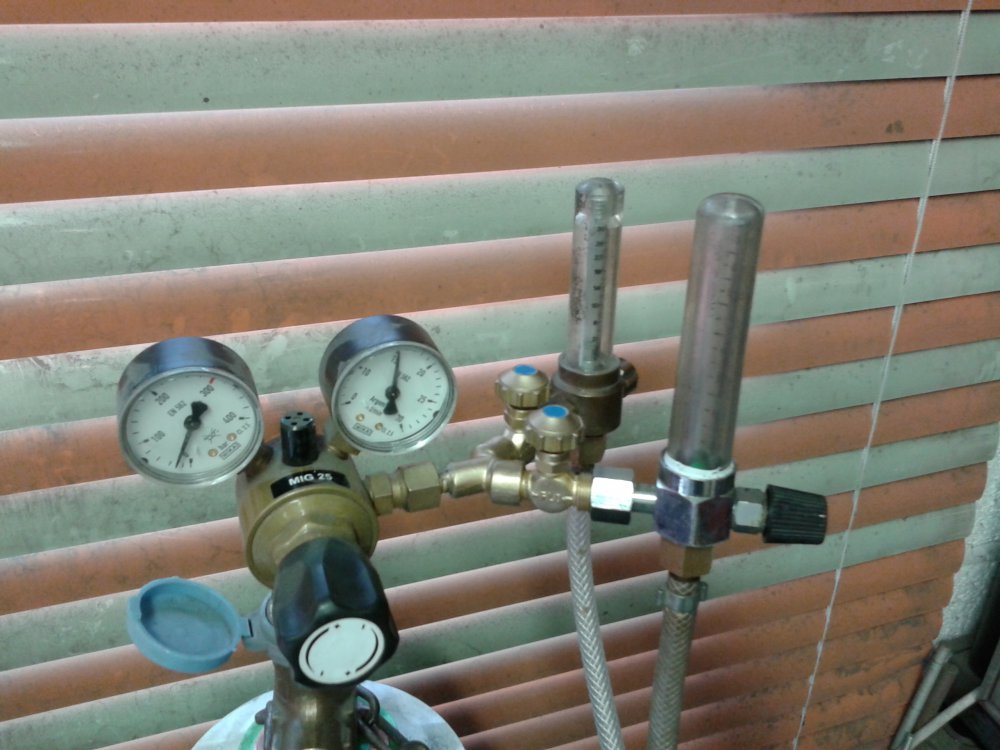

The "flow" gauge on right is in fact a pressure gauge and so won't show a clear flow rate but about half way between the 0 and 5 (outer ring) with trigger on torch pulled should be about 10 lts per min. You need to add a flow gauge to get a correct reading. In pic my gauges are reverse of yours.

no don't remove the gauge .that isn't the outletThanks for your help I thought something wasn’t right with those gauges..so I should be able to get a flow gauge from eBay remove that second pressure gauge and install the flow gauge there ?
NO you add it to the out put connector. Remove the barb connector on right side then add in flow gauge like this one https://www.weldequip.com/flowmeter.htm Then connect barb fitting to bottom (on this type) and then connect pipe going into welder.Thanks for your help I thought something wasn’t right with those gauges..so I should be able to get a flow gauge from eBay remove that second pressure gauge and install the flow gauge there ?
Thanks for your help cheers I understand nowno don't remove the gauge .that isn't the outlet
Thanks I understand I maybe get one of those that goes on end of torch so I can get the reading from right at the endNO you add it to the out put connector. Remove the barb connector on right side then add in flow gauge like this one https://www.weldequip.com/flowmeter.htm Then connect barb fitting to bottom (on this type) and then connect pipe going into welder.
Some prefer this type https://www.weldequip.com/gas-flow-tester.htm as it gives a flow at the final output of the torch.
Note it you use a fitted type you may have to sort male/femal connections to match.
