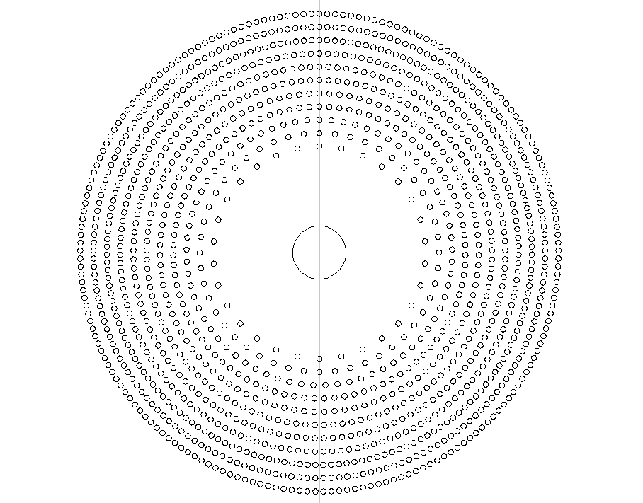

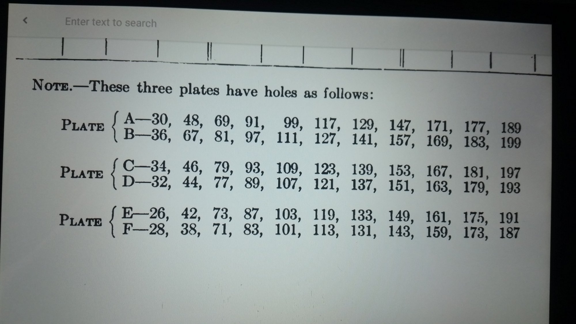

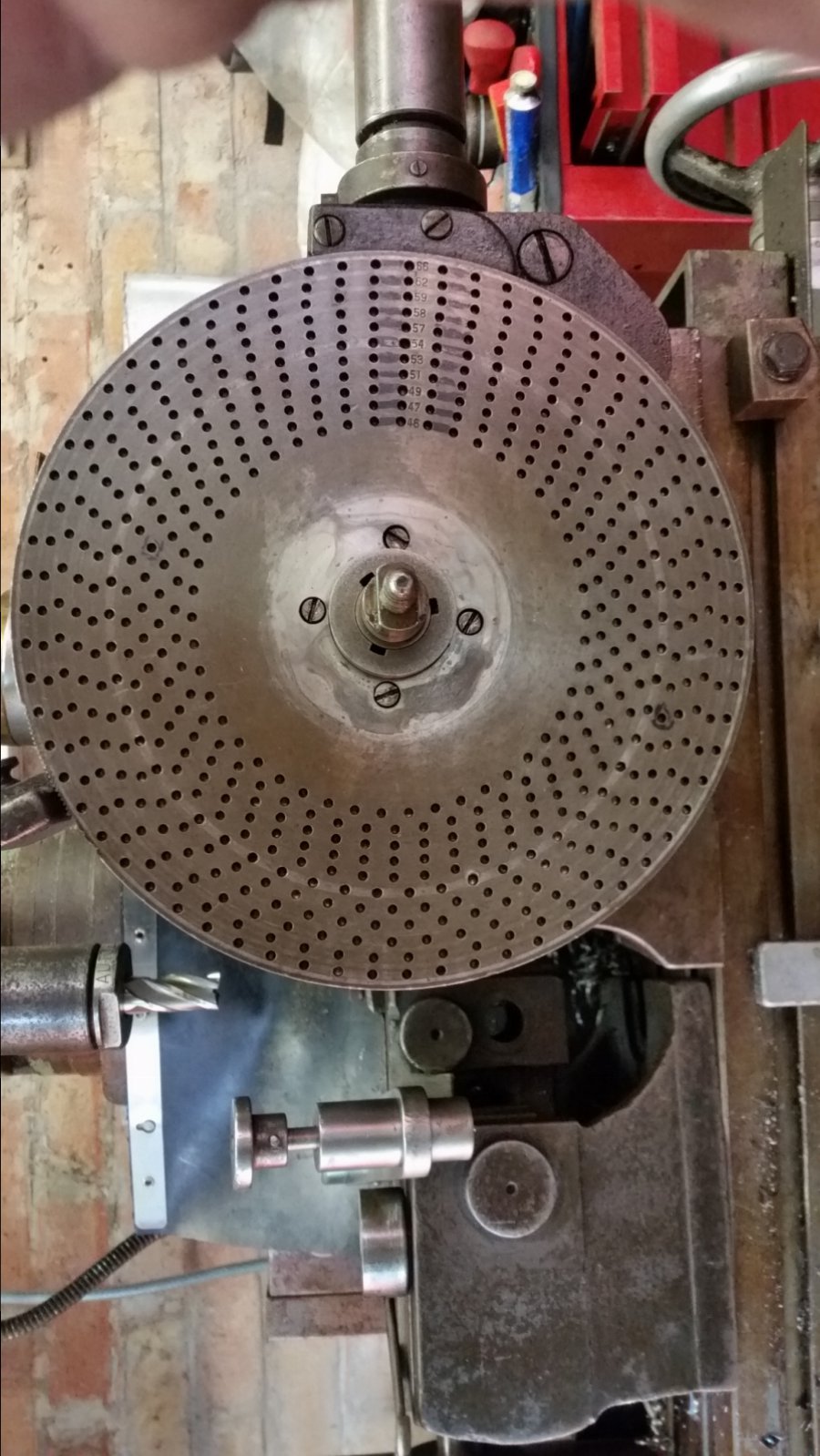

I hope to have made, 3 dual sided indexing plates for my dividing head, blind holes (up to 199 in a circle) to be drilled/milled, the plates (EN8 probably) are just under 9 inches in diameter, 3/4 inches thick approx.
I will provide the blank plates to be drilled as I have to machine the central mounting and fixing holes to my dividing head.
Does any member here have access to the Knowledge/Machinery/Time and would consider helping me out?

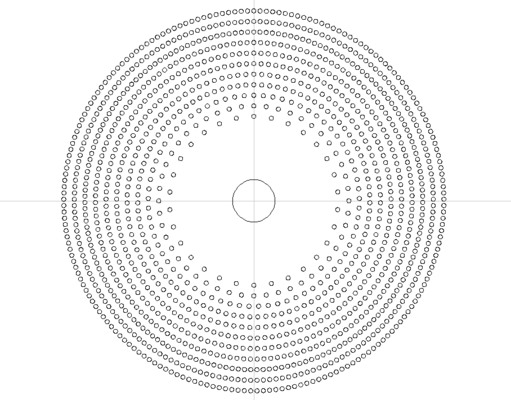

Hole pattern as follows:-
