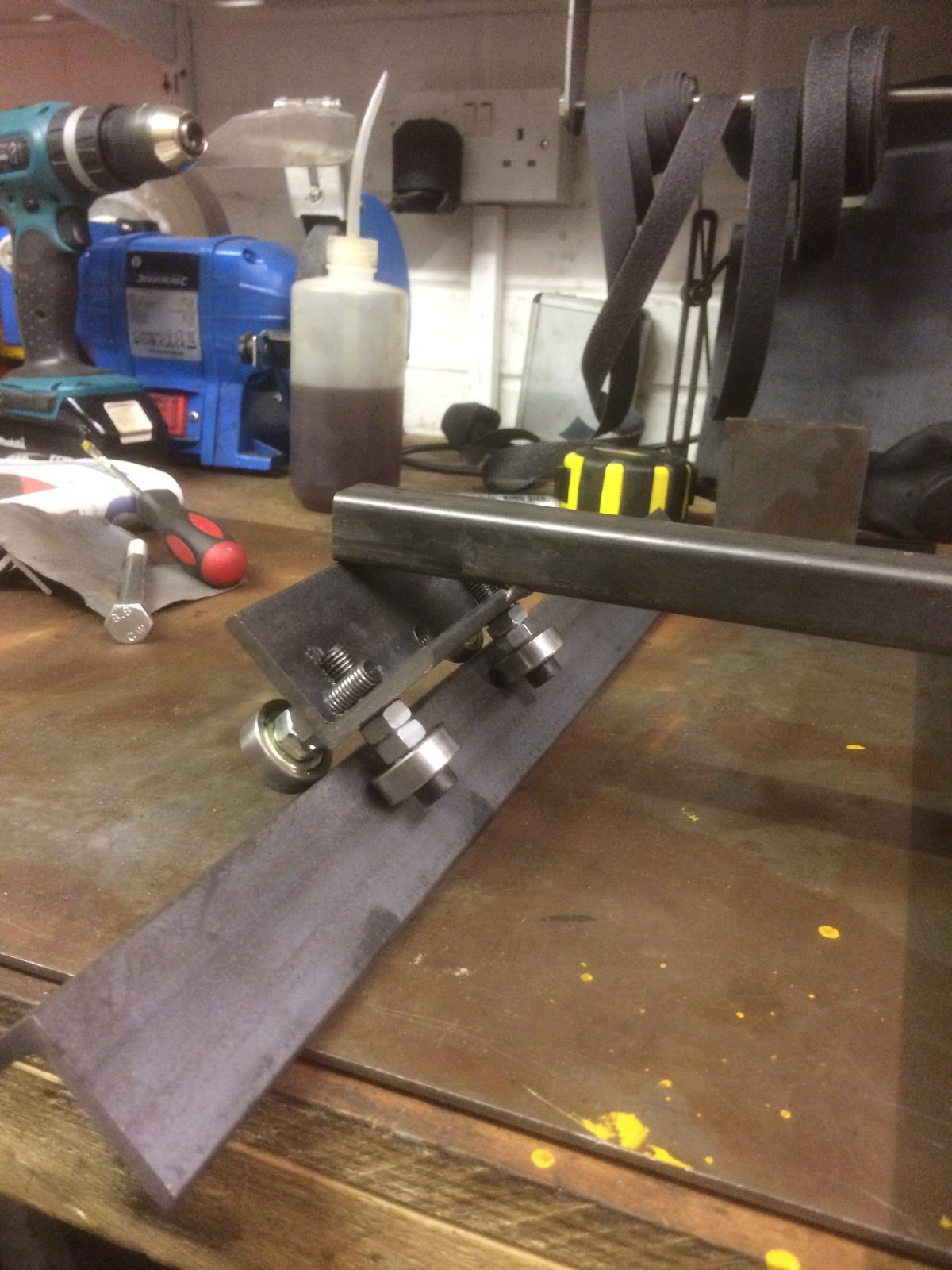

View attachment 119257 Thanks for all the input guys. Started researching rail systems and as I'm on a tight budget tried this experiment.
It is surprising how smooth it is but will have to use better metal for the rail on the real one.
Have a video of it.Why?
Some of the ones I have seen in kit form use ERW tube and sit them on edge similar to your idea with angle. You could flap disk it down if required, but, you said it is smooth, how many thou do you think it will deviate the cutter with the mill scale?
