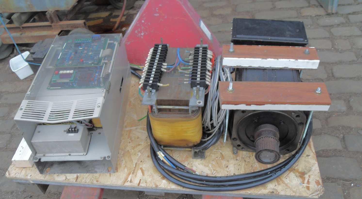

Direct drive like the cnc router spindles.What kind? Direct drive or separate motor?

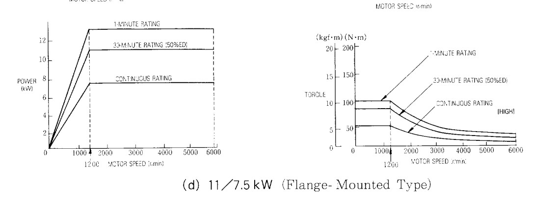

Even if torque was constant the power would be minimal at the low rpm.
Don't know the type of use you are intending but high rpm usually means smallish tooling requiring less power and lower speed means bigger tooling which requires higher power.
So lets say that the torque can be maintained over the full speed range, unlikely but could be fairly close depending on type of motor.
So a 1KW 10,000 rpm servo would have approx 0.95Nm of torque.
So if you then say torque remains constant then at 50 rpm you can work out the power, it would be 0.01Kw approx.
