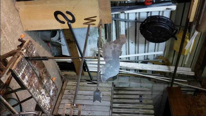

I was taught with soldering that a good mechanical joint would help a good electrical joint. Well as I haven't had much chance to play with my machine tools for a while, I decided to apply that to welding as well.
The letters and Clumber were supplied by gerrymoore (of this parish!) and the Clumber silhouette was taken from a picture of Henry (www.whissgig.co.uk).

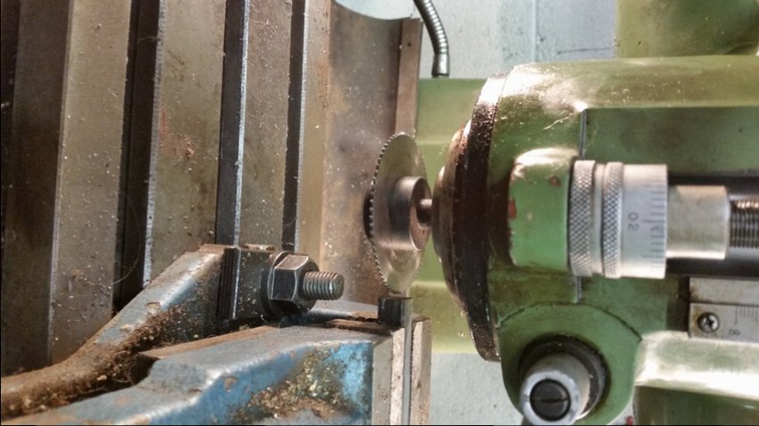

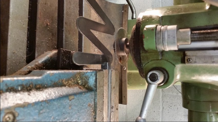

So, I used a slotting saw and created the slots for the letters at the end of the fixed arms.

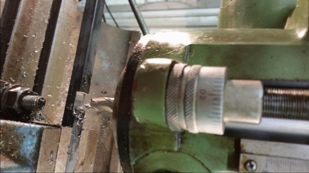

I then machined a larger slot at the center in each of the cross pieces to help the fit before welding.
I then re-did the slots as they were now 90 degrees out as I had machined the middle slots on the wrong face!

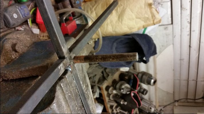

Having welded the cross pieces, I turned a piece of rod down, drilled a hole in the centre and used that to locate what was going to be the pivot prior to welding. I also turned the outer down slightly so it was a nice fit in the tube. I used the well known method of a ball bearing in grease at the end of the tube to act as the pivot.

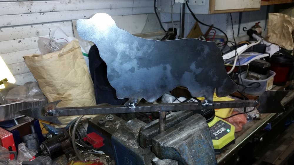

I welded up the moving arm, the found the balance point and welded the tube on at that point.

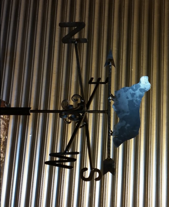

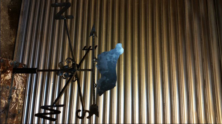

I then welded it all up, using a bit of 2x2 with a slot in the end to ensure all letters were at the same height. I also included 4 bits of architectural steel to finish off under the cross piece.
I attached a post with a screw to lock it once North had been identified and a piece of drilled angle welded at the bottom to attach it to a structure.
All it needs now it a little bit of fettling then painting.
The welding leave something to be desired in places, but I'm happy with it!
