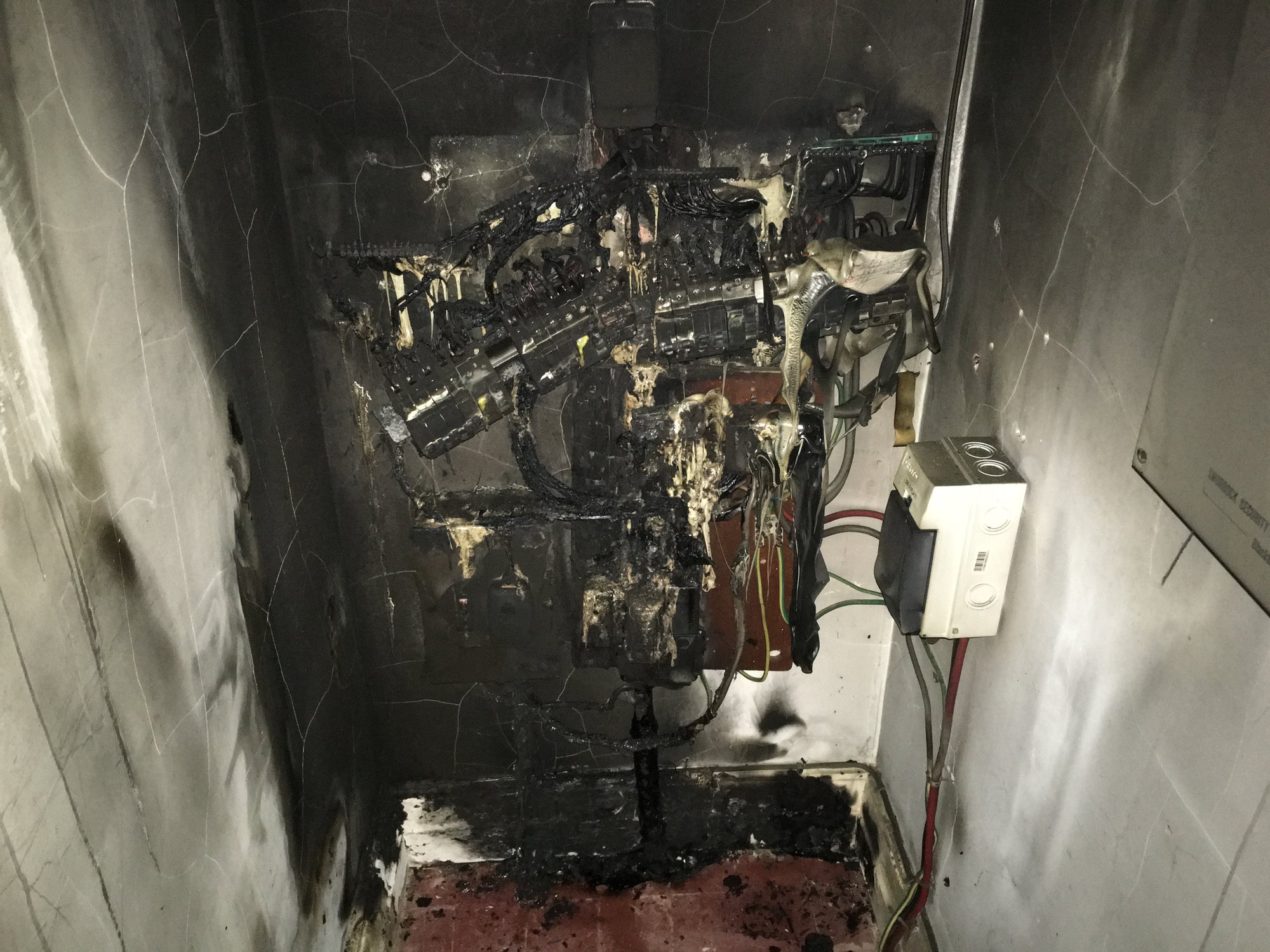

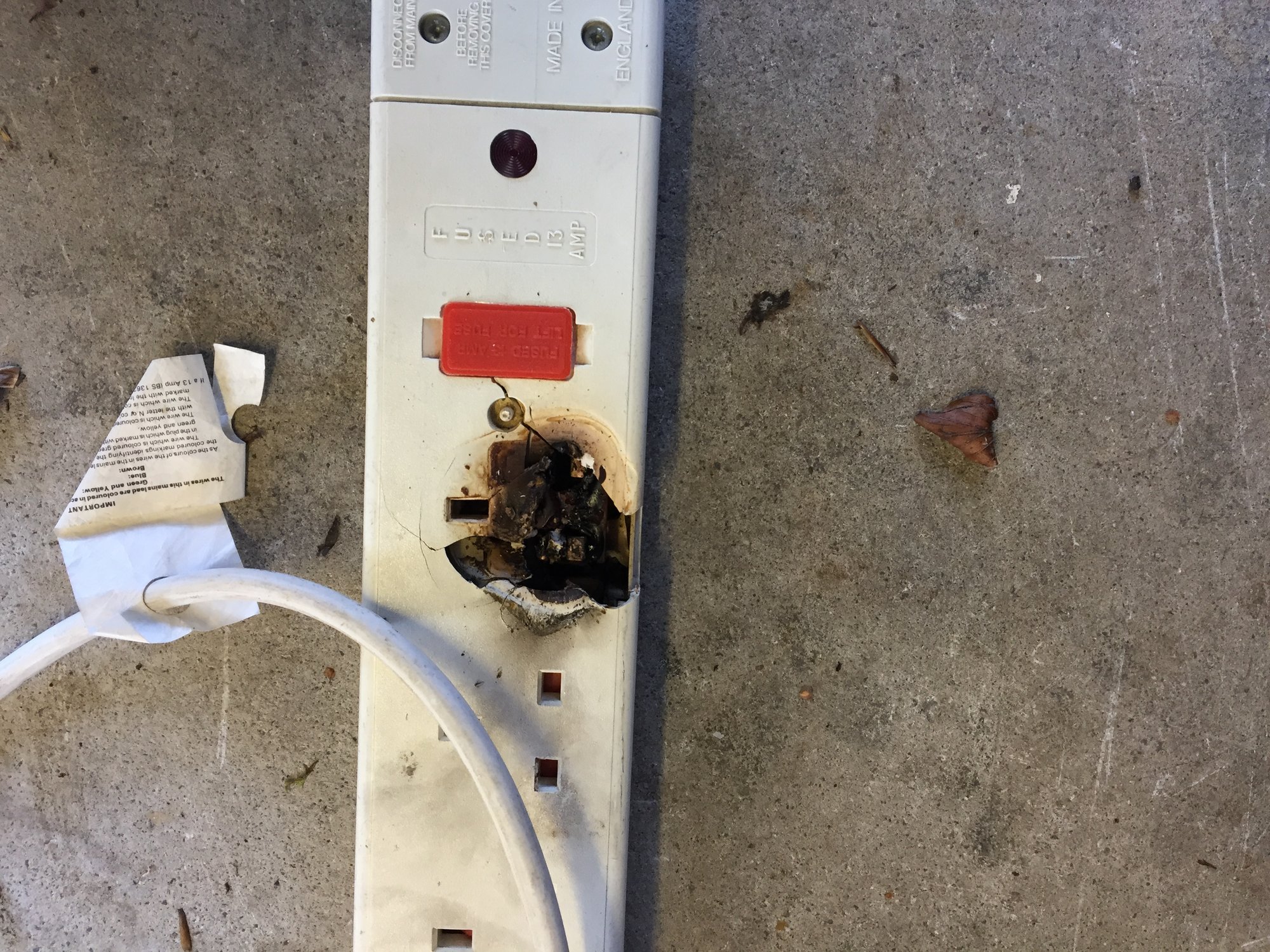

Standing by for criticism about plugging a dryer into an extension lead (I’ve googled it now!) but this was the only thing that was plugged in.
Certainly something I wouldn’t do again, and I’ve gone round the house checking all the other plugs!!
anything else can be on a 4 gang lead they don't like a constant 3kw load on them and the 13 amp fuse wont blow in them to stop that
