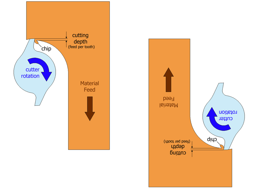

ronan Member Messages 11,282 Aug 15, 2021 #42 Pete. said: No I mean heavy enough. You can climb-mill 90% diameter no problem. Click to expand... Maybe on your machine, but mine is too small. I do climb mill, but usually only a few thou as a finishing cut, it does leave a lovely surface finish.
