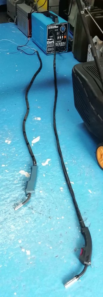

Thought I'd weld up a split in the frame of my swivel chair. Simple! I'd run out of gas so I swapped the polarity round to weld no-gas and pressed the trigger to test the wire feed. It moved weakly then smoke started emitting form the gun. As you can see the live wire has a clean exposed section and the first two inches of it have also been hot. But it was the liner that was lying/melting against the earth. I think I will have to cut open the conduit because I cannot pull the liner out. I presume it's welded to the conduit somewhere. Anyway my poor old trusty welder is looking a bit sorry for itself!

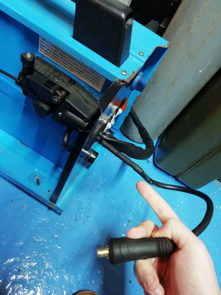

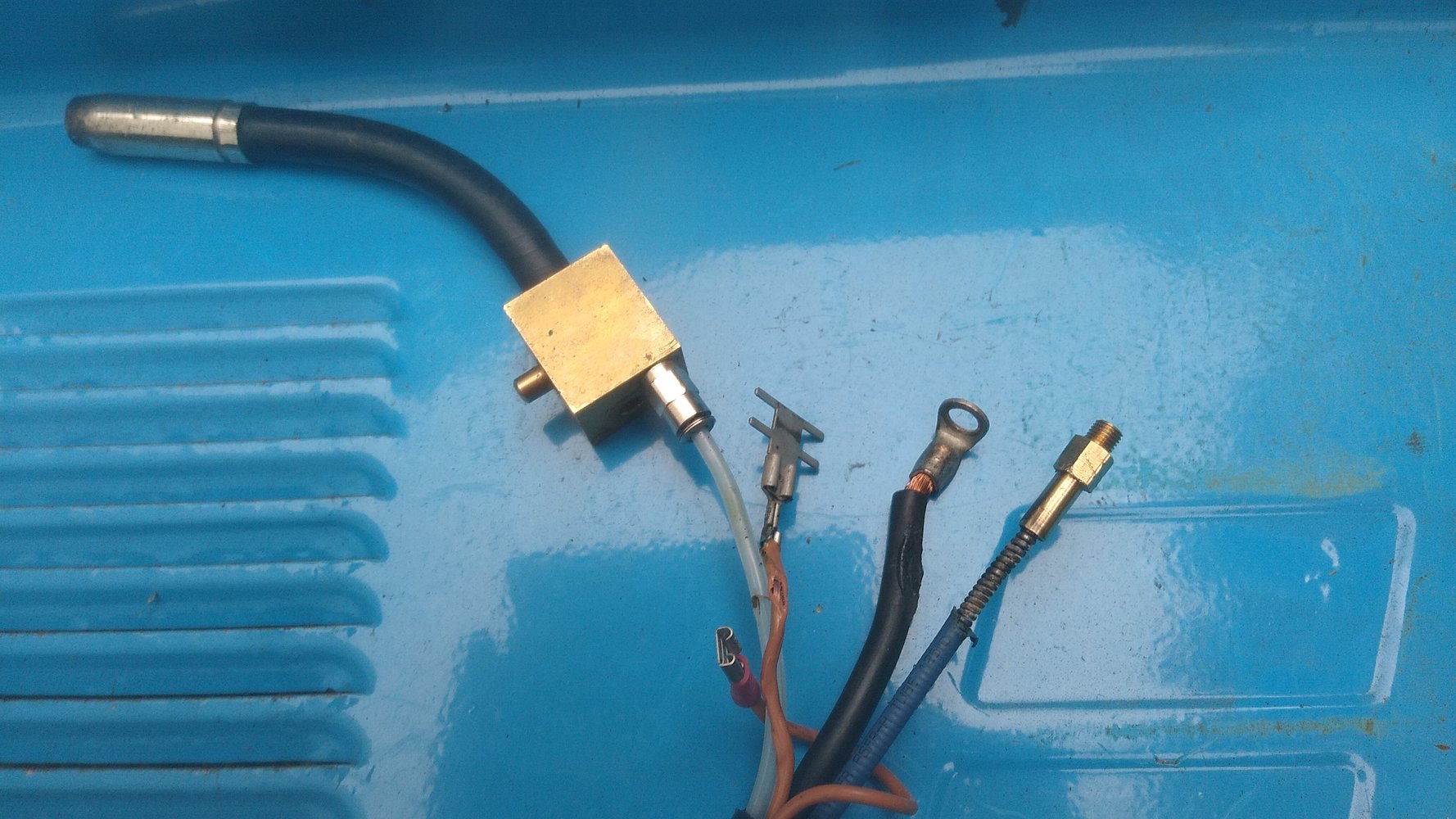

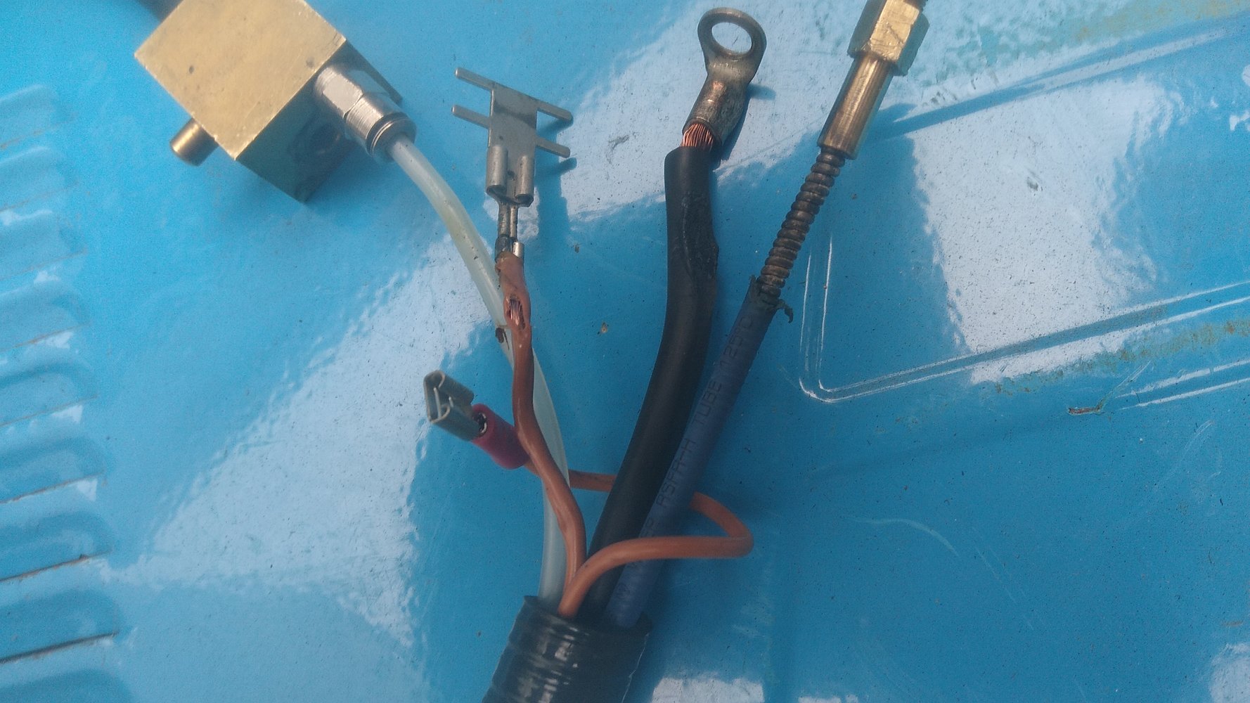

Here are some post mortem pics, what do you happened here? I'm guessing that maybe there was a short between the live wire and the liner rather than the earth which looks melted but not exposed. But should the outer liner offer an earth path?
