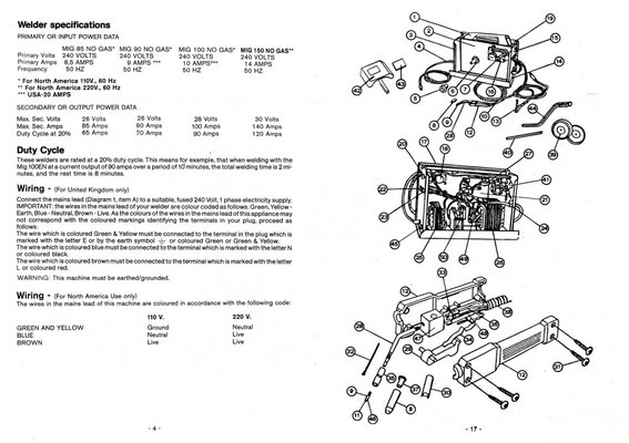

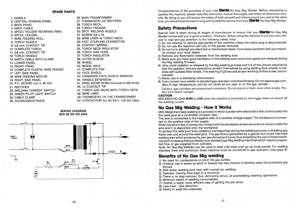

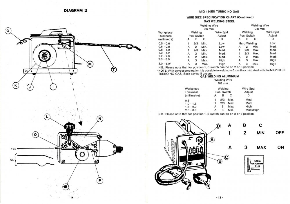

I have modified the manual for the 150en that was kindly scanned and posted on this forum by Jimcrow. It was a scanned pdf but it was in portrait when it needs to be in landscape so it can be read on its side. I have turned it into .jpg and rotated it.
Thanks Jimcrow for the original.
