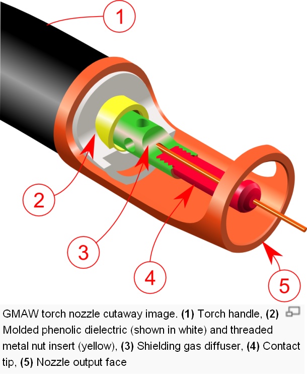

If you cannot do a photo easily enough, then perhaps the following diagram might be of some use in describing your problem a little more......you could refer to the parts by number or name...
that pic is spot on mate! i haven't got the red thing (num 4) on mine, i presume that just screws in?(to num 3). thus keeping it in the middle stopping it from "arcing out" ?? cheers
The contact tip is the part that transfers the welding current to the wire which is why it's sputtering and arcing all over the place.
When you buy some, get a bag of 15 or so from a welding supplier, you'll soon wreck them when you're learning and blister packs of 5 will cost you more in the long run.
