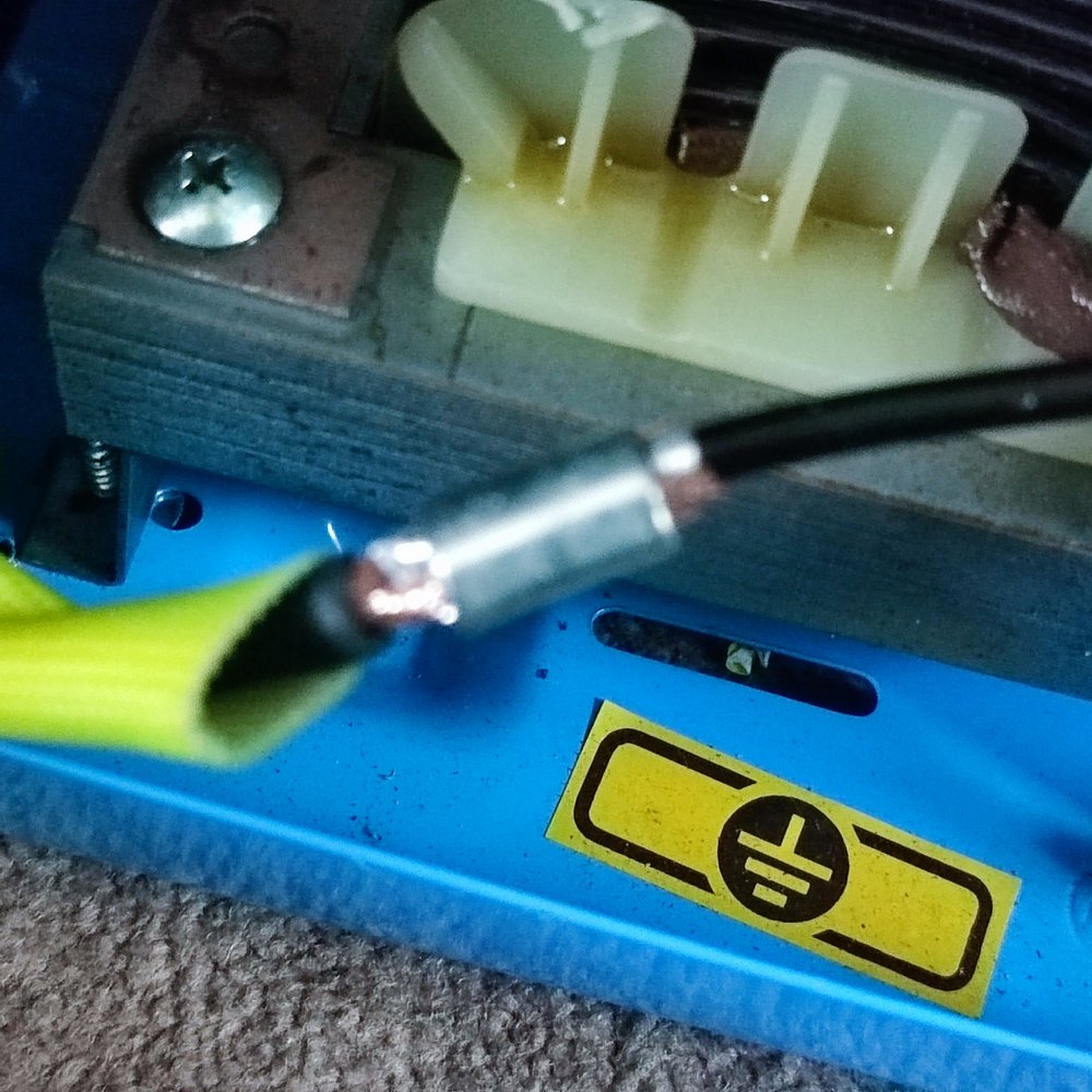

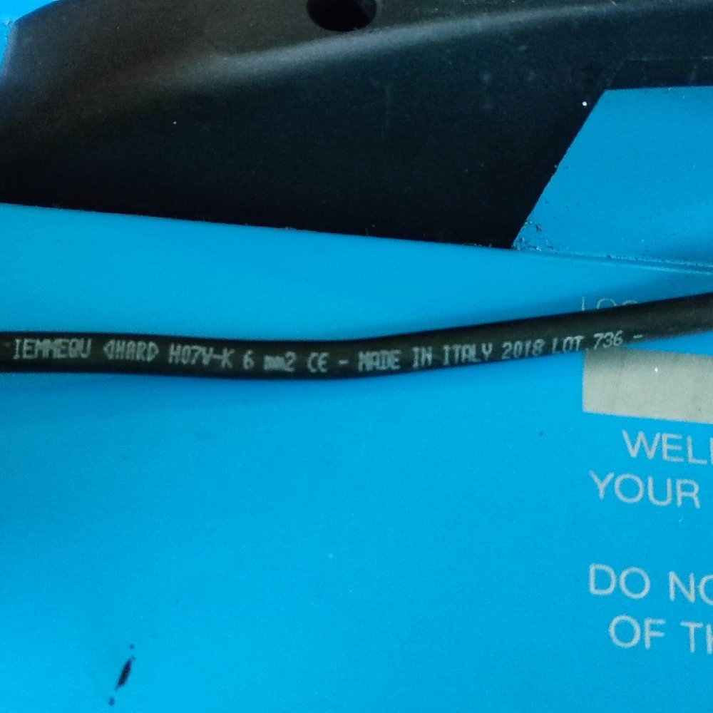

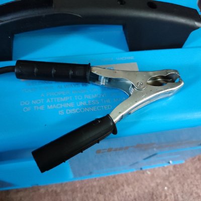

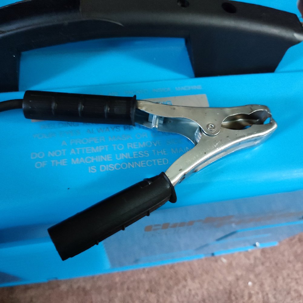

Good evening all. I've had the Pro 90 for about 4 years and it's not been bad at all for thin car bodywork managed to repair a front cross member on my old nissan. The earth clamp on it is pretty feeble and the cable is only 6mm( minimum spec) . Had a look around and a cable with a dinse connector looks a good option? The cable is not very long either. As far as I can see I would need a dinse socket to go on the front of the case where the current earth goes through the hole and inside the welder there's a butt type crimp connector( 2nd picture)so I would need another piece of 16mm cable to go between the crimp connector and the back of the dinse socket with a lug on it. I've got a neighbour who's an electrician so should be able to get a new cable crimped. I was thinking a 16mm cable and should be ok for this welder as it's only 90amps.Hopefully it will help improve the welding lol. Have a sill to weld up on a nissan soon found a small hole where someone put a patch panel on before have to get it done soon while the weather's still warm! Any tips or words of wisdom would be appreciated.
