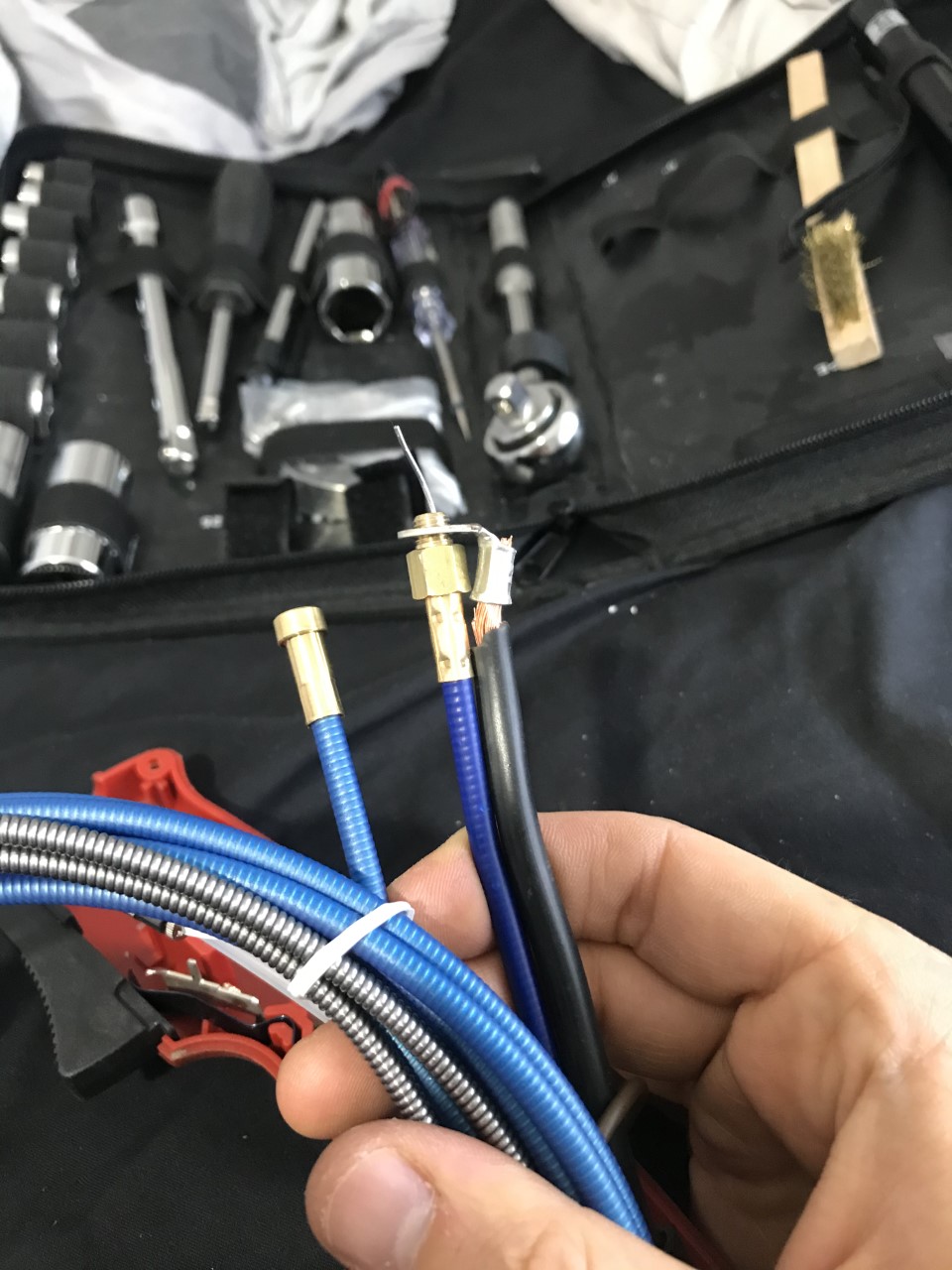

MB14 5 mm tips - all over ebay.
Buy a blue Euro torch 4 m liner, chop in half and you've two.
Maybe get another gas shroud along with the tips?
The earth clamp and thin lead can also be improved.
Give the roller grooves a good clean out, that's about it.
That's the right one. The fitting on one end is not needed.
If you cut the fitting with c. 6 cm of liner left, you can use it to replace the short section in the feed motor, giving a nice brass end for the wire to enter.
