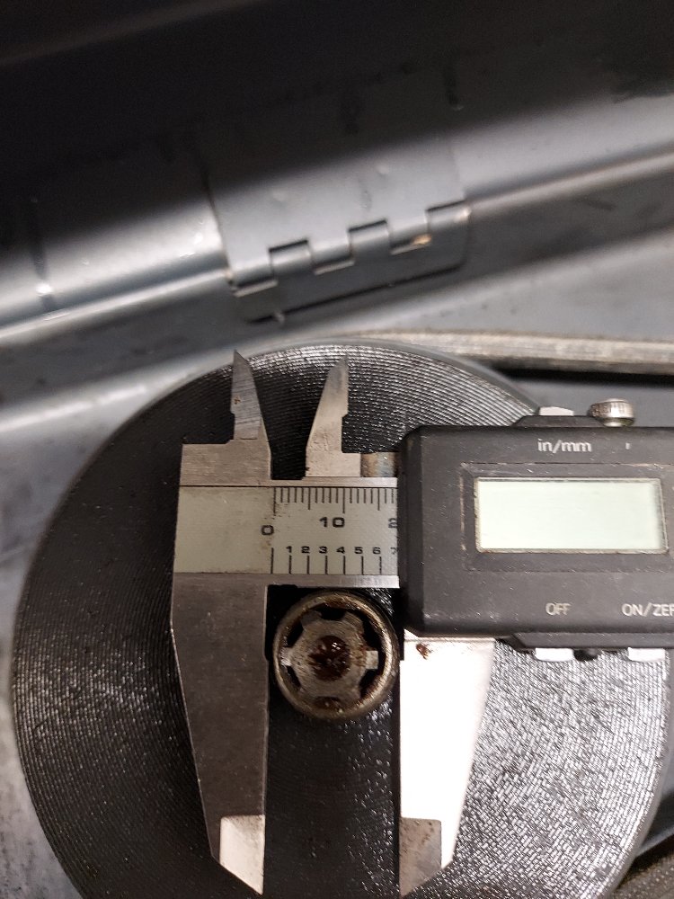

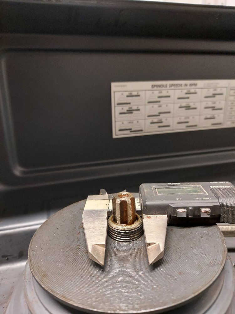

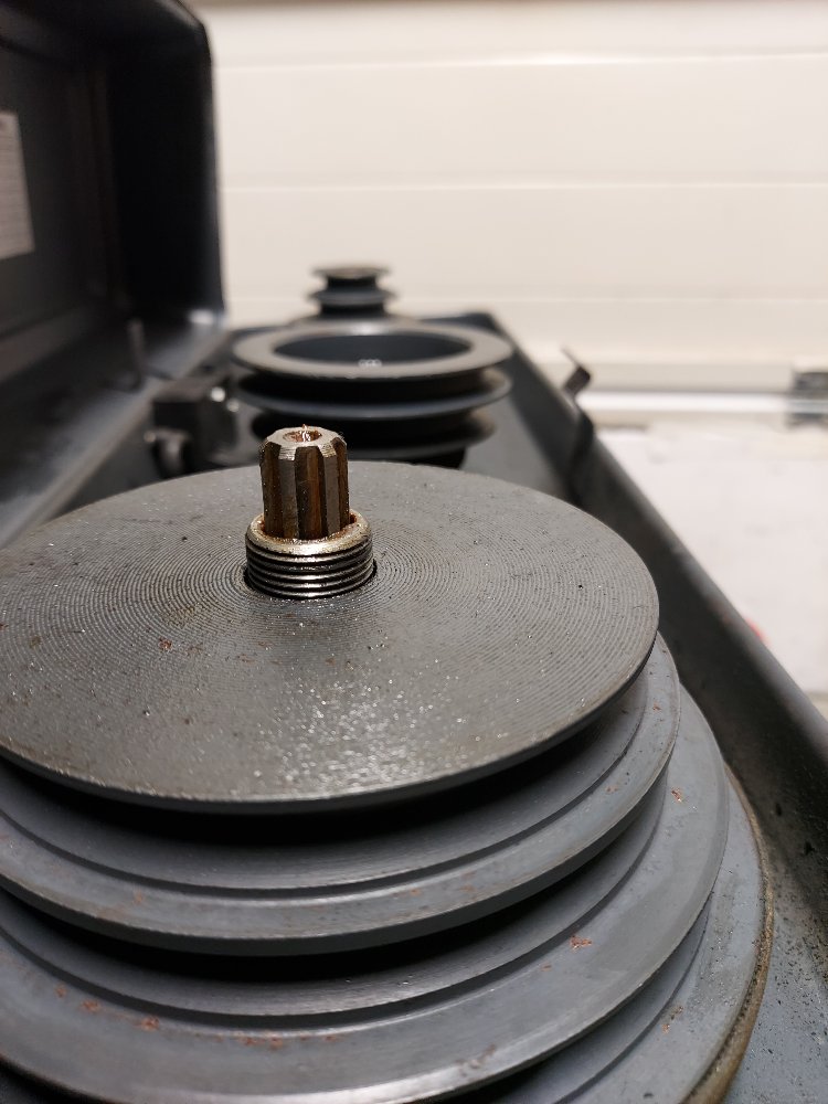

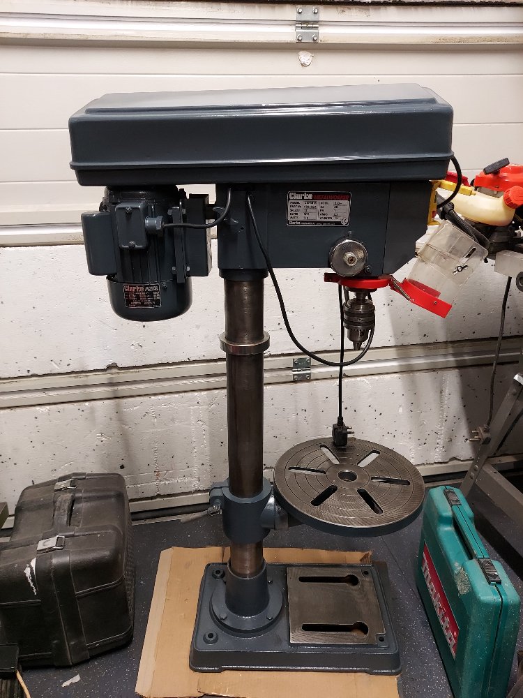

Hi, new to this forum so just hoping i picked the right part of forum for this question ,I recently aquired this Oldish Clarke CDP301-B drill press which i was assured it was unused but quite rusty, i switched it on but did not try to drill anything.Anyway cleaned it painted and looks good but when i tried running it so i could clean the chuck i found the slightest pressure stopped it turning and after looking up parts catologue i realised the pulley nut is missing from spindle. Tried to get one from Clarkes but no longer sell parts for this machine as quite old and couldnt tell me size either .So if anyone could help me getting the correct thread size nut for this would be gratefull thanks
not that i need to. got a thread pitch gauge and vernier caliper and all the charts
if so i said take it in not just the part number and they will identify the thread
