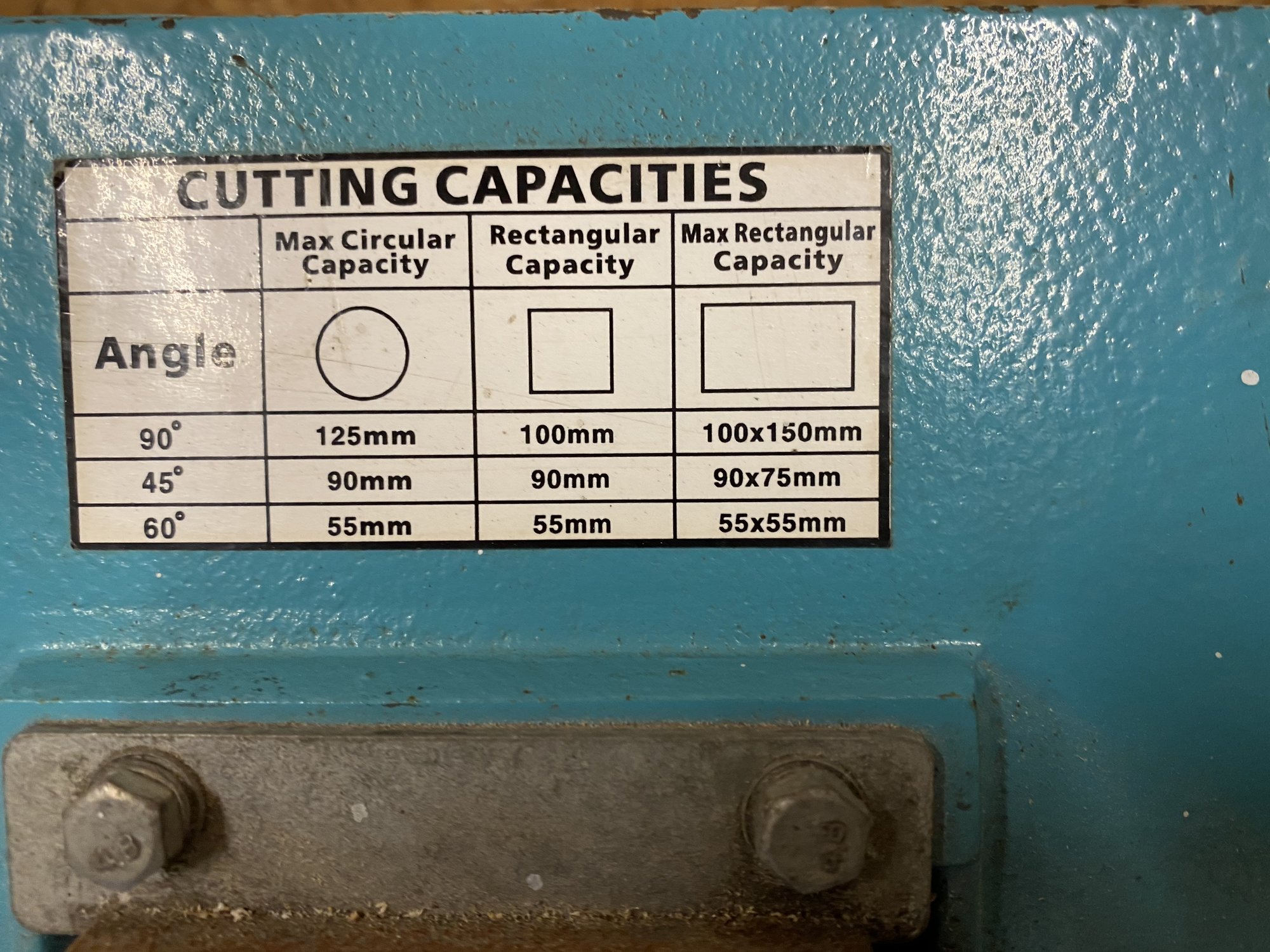

After cutting a load of 45 degree mitres manually with a grinder and then having to sort the fit up issues I’ve decided I need to get a bandsaw. I’ve been looking at the Clarke ones for over a year now but always talk myself out of one. I know there is tons of info on how to improve them but I was hoping somebody can tell me their maximum cutting capacity is at 45 degrees? I’m cutting a lid of 72x25 box and I’d be peed off if it couldn’t accommodate it!
Only sizes quoted are at 90 degrees on the MM site!
