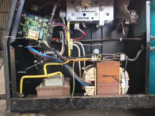

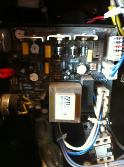

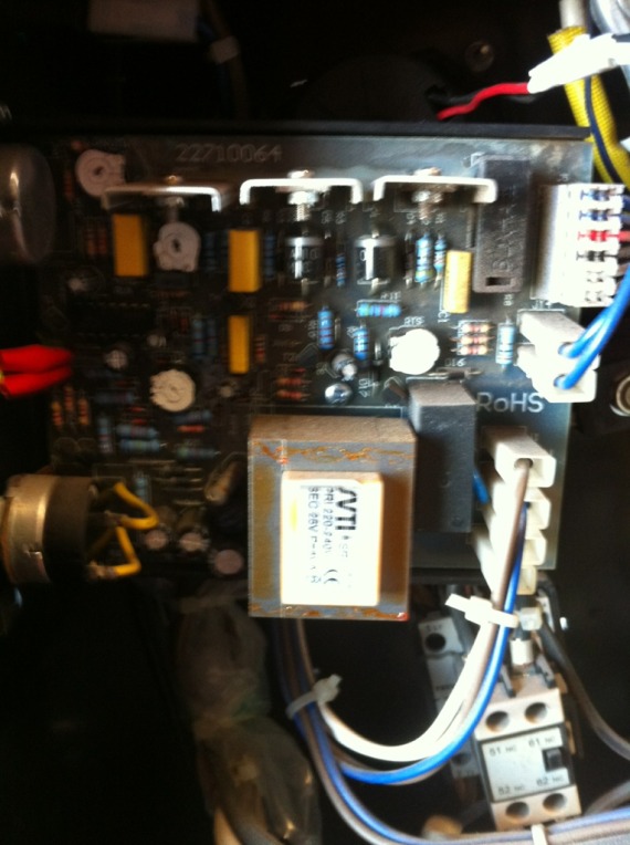

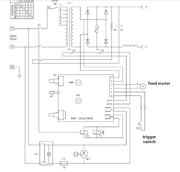

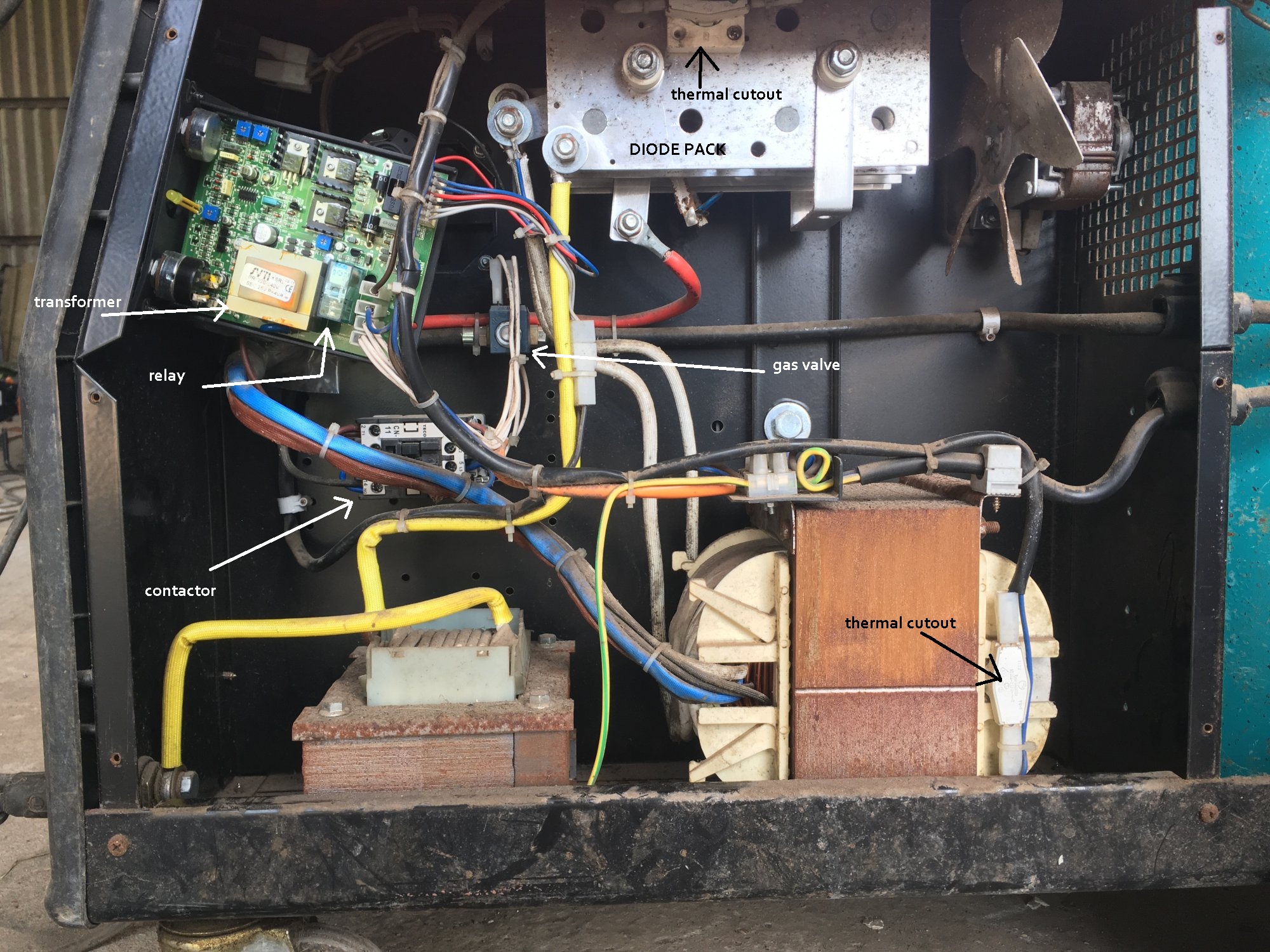

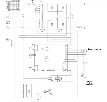

Hi I've got a Clarke 230 tec that I've just dug out of my shed. The unit was brand new, never used but not in a box. It's been stored for the last 6 years or so in my shed and today was the day I've been looking forward to since I bought it !! Finally I plugged it in and tried to do some welding. It turns on but when I pull the trigger the feed doesn't operate. I took the side panel off and can see the fan operating and also the relay clicks in and out when I pull trigger but the motor doesn't turn. I checked the fuses. Please can anyone help ? It's never been used
