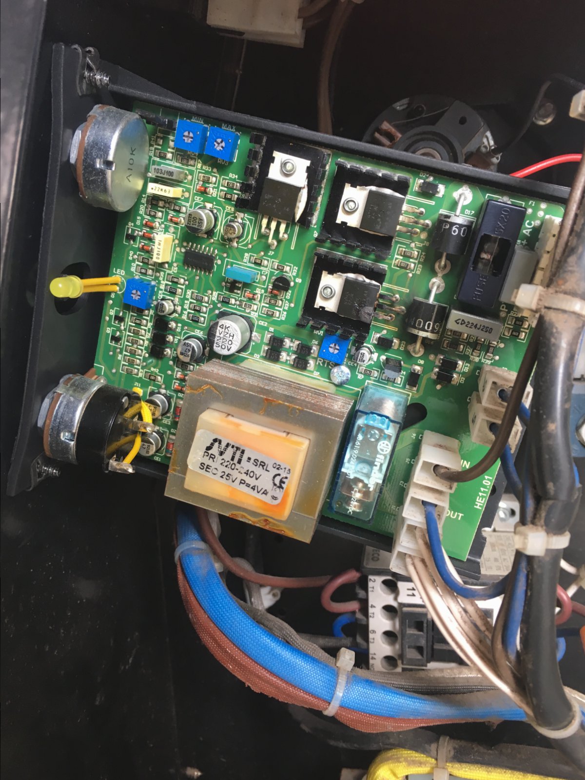

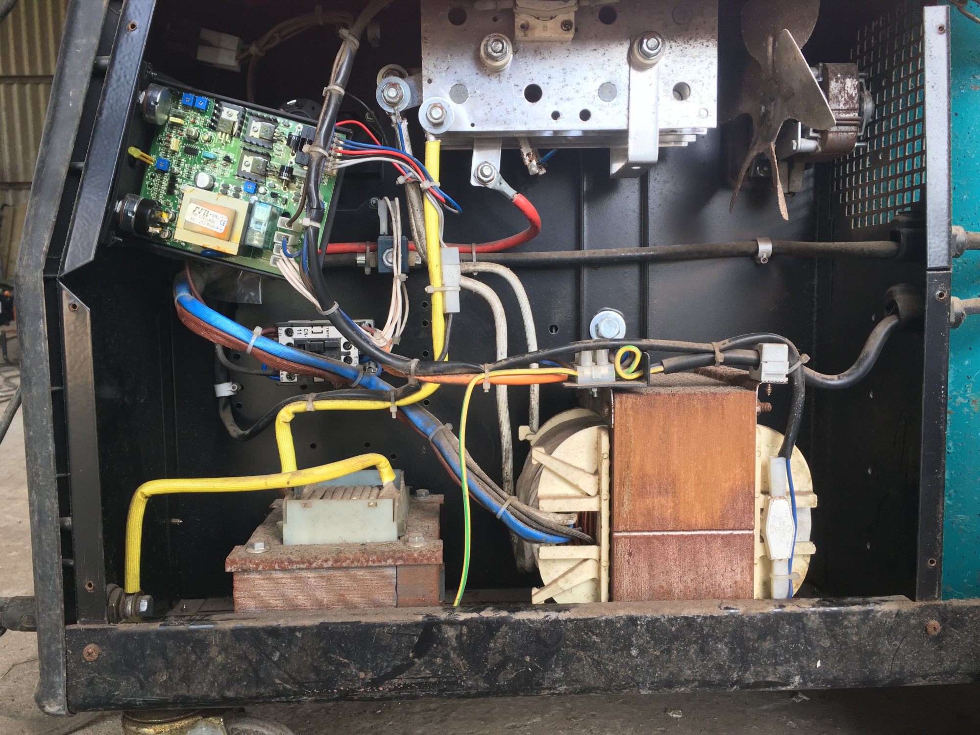

I'm hoping someone here can help me diagnose the problem with my Clarke 205te.
Recently it stopped feeding wire and i suspected the motor had packed in so i fitted a few one but still no wire feed. I then fitted a new pcb board and this seems to fix it for about 5 minutes.
When trying to weld it would only feed for a few seconds before stopping, this carried on for about 10 minutes before it stopped feeding all together. I've had a look inside and I've noticed the small glass fuse has blown and also a black flat square transistor is looking a little toasted.
I would appreciate any suggestions from you all as to what might be causing this.
