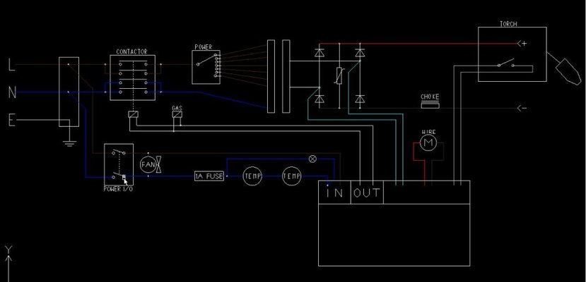

I started by making my own wiring diagram from just tracking the wiring loom inside and cross referencing similar machines diagrams from the net:

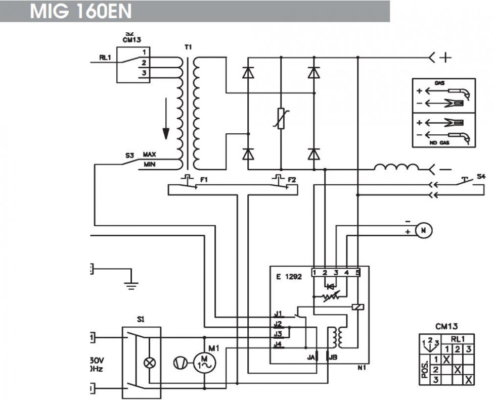

this is 90% based on tracing the wires and partially on this schematic I found:
Ive a few things yet to circuit test to be sure things that are connected in the 160en are not the same in mine (ie the 160 has a feed from the + feed of the torch to the trigger and the pcb, mine doesnt but has just a closed loop from the board and back or it seems to anyway, and also that the 160 shows - from the welding feed going through the PCB and a diode to the motor neg,)
any obvious mistakes please do say so!

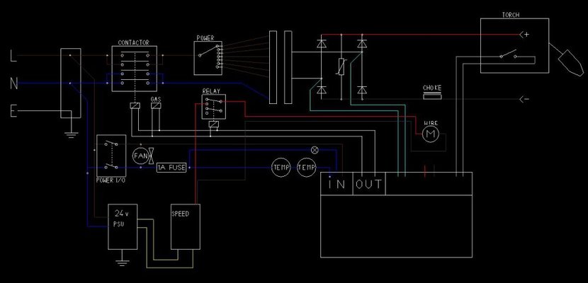

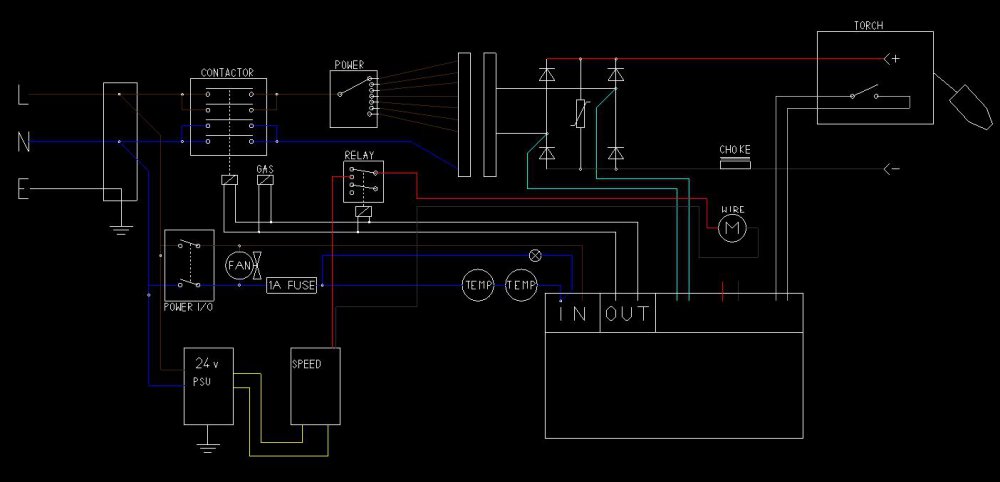

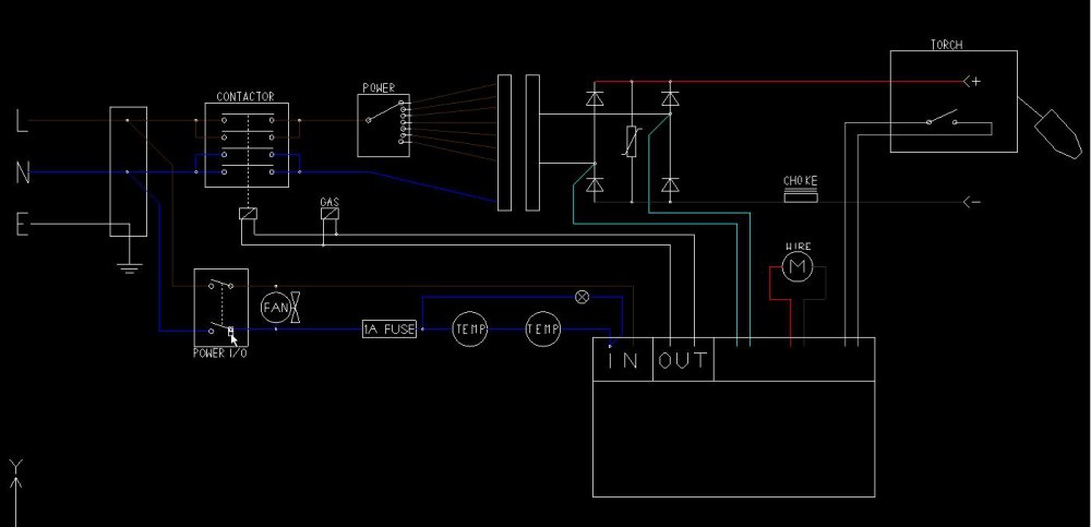

anyway I've already wired in a 240v ac relay in parallel to the control feed for the gas and contactor circuit coming out of the board, this is to enable the new PSU output to be switched via the relay contacts rather than physically turned on and off which kills PSUs. My new 24v PSU was still on order but I did have a 12v PC PSU which I use in the shop for all sorts as they are free (find an old pc, take it out, yellow is +12v and black is 0v) and powerful, along with a 12v cheapo Ebay motor speed controller, so I wired it in just to see how it fared.
Wow! even at 12v the completely stand alone wire feed system is a HUGE improvement, no struggling to drive the wire even with the tension cranked on to get grip on the wire and so much smother than its ever been, the controller uses sine wave to alter the speed rather than the standard one which changes the voltage and therefore also the torque of the motor also so it has almost full power at low speeds now.
This is the altered schematic now (with 24v written wrongly as it as actually a 12v for now):
For anyone wanting to try this its a doddle to do with just £20 of bits from ebay!
