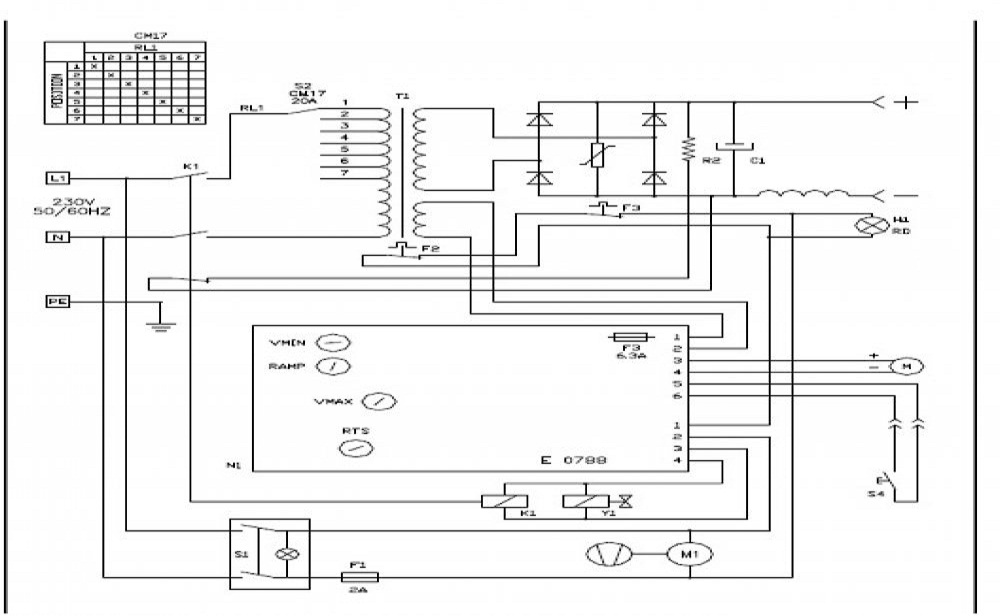

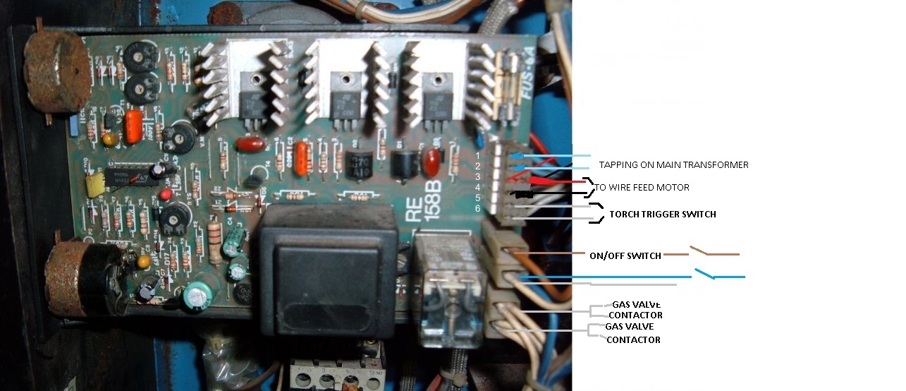

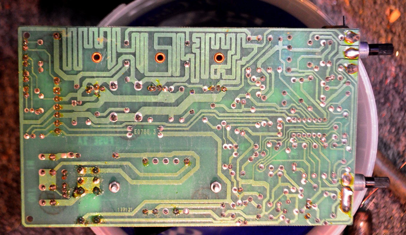

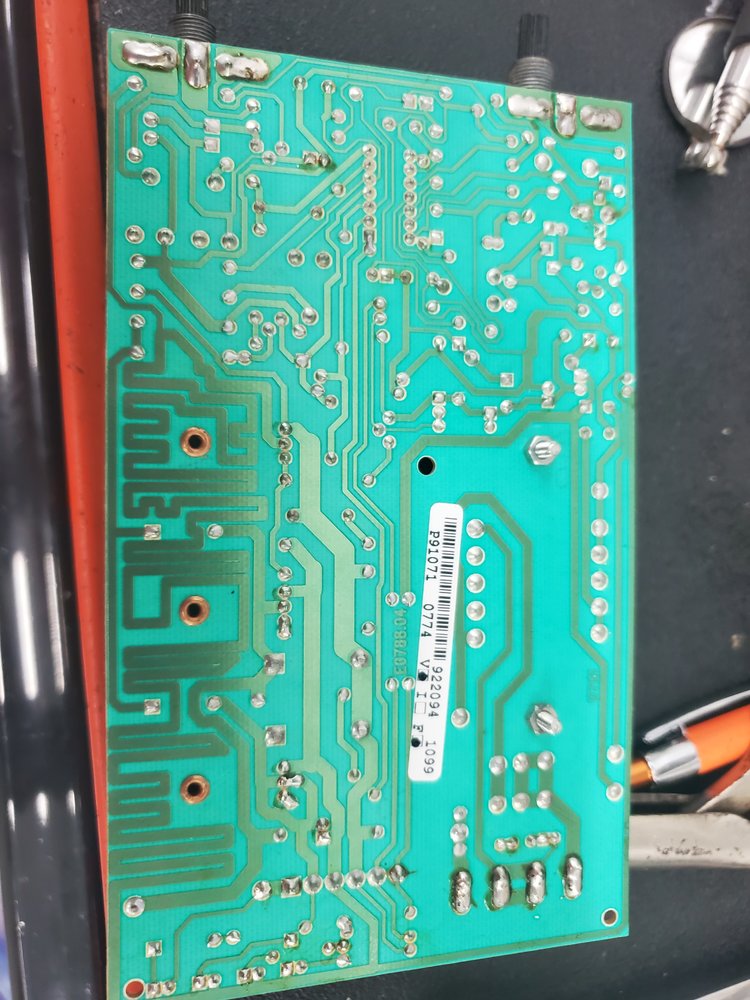

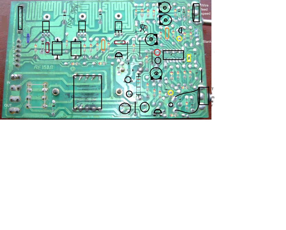

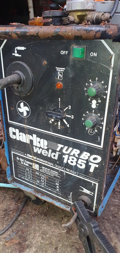

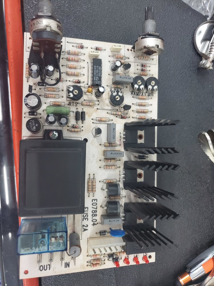

Hey guys, im Joe, im new to the page. Im in need of some help, i have a Clarke 185e that we had purchased from an auction years ago, i didnt have an outlet to run it (240v). I now own an automotive shop and have an outlet to use it, got everything changed out that was worn,(hoses, wire, ground cable etc. I went to make sure everything worked, but i have no wire feed. If I manually feed wire out, put on my ground cable, turn on gas and pull the trigger, i get arc and can hear the gas, but no feed. I use my battery booster and apply 12v to the feed motor and it works ok. Ive performed Ohm checks through connectors just to make ure there were no bad or corroded connections and that all check out ok. Upon visual inspection of the pcb im not seeing any obvious concerns, no burn marks, cracking, ect. Im not sure where to go from here, what are my next steps.
Thanks, Joe
