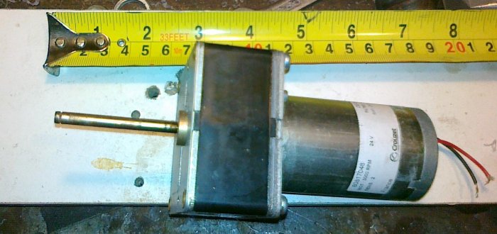

Hi, First time poster here so forgive any errors I make please.
I offered to look at Clarke 165E mig welder for a friend.
The wire reel apparently 'bird nested' (no brake spring on the wire reel by the looks of it) and he kept his finger on the trigger.
I could feel that it was trying to feed so I stripped the gearbox.
The first nylon cog after the motor gear has a couple of crushed/stripped teeth.
Obviously parts will be long extinct but has anyone found a substitute for the gears or anyone who can cobble up a metal/brass replacement?
The owner of the welder is somewhat poorer than a church mouse so it would be nice if I could be a good samaritan and resurrect his machine.
So glad I've found this site as my own welding is similar to pigeon guano sometimes and I may be able to gain some more skills.
Many thanks.
