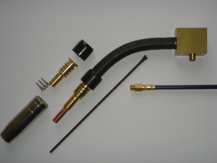

Bought my 160TM a few months ago, but am only getting round to setting it up now. Power supply sorted no problems. Reel installed no problems. Now the real issue - the torch shroud. The manual says, and I quote 'Turn the shroud ani-clockwise and pull to remove'.
So as per every other welder I've ever used, grab the mole grips and twist it anti-clockwise (no way it was moving by hand). Very coarse threaded screw, so I stopped and gave it a tug to see if it would come off. Nope. Continued unscrewing it, and noticed a weird spring like thing around the thread coming off with the shroud. Tried tugging it again, still no joy. Eventually it screwed all the way off. Removed tip, wire fed through no problems.
Now, replacing the shroud. This weird screw thing doesn't want to sit anywhere sensible, there seems to be a bent end at the tip end of it which would appear to hook into the shroud. The inside of the shroud is not threaded. I'm very confused, never seen anything like this before, and I've used all manner of gas and gasless Migs. I've tried every which way of replacing the shroud, but it doesn't want to know. Anyone else encountered this? Have I knackered the torch?
EDIT: It's the little spring shown in the photo below, except mine is now a very strange shape. I'm guessing that makes it knacered. So what damage am I likely to have done, and what is the correct method for removing / replacing the shroud on these?
