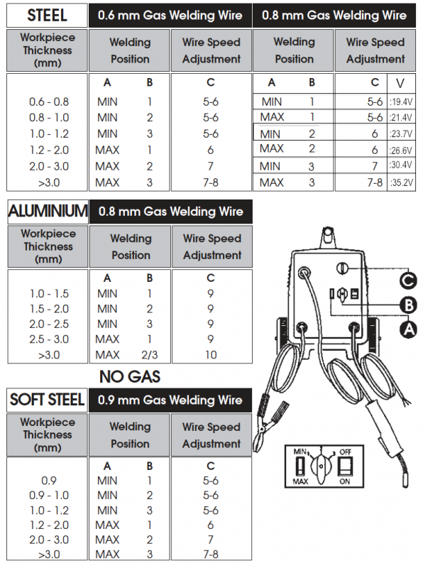

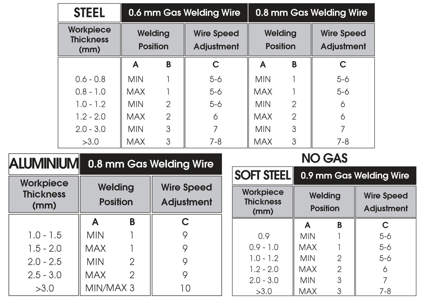

On the 160TM there are 6 welding positions, selected by use of a main 3 position knob and a min/max switch.
I suspect I have the answer to my question but I would like to check with you other guys and gals.
Is it that the progressive increase in power is; 1 min to 1 max then 2 min to 2max to 3 min etc? That is that 2 min is greater than 1 max. Are these all proportional steps?
thank
Colin

, as well as the manual! Actually, I did blow a hole at 3min, but assumed it was just me moving too slow!
