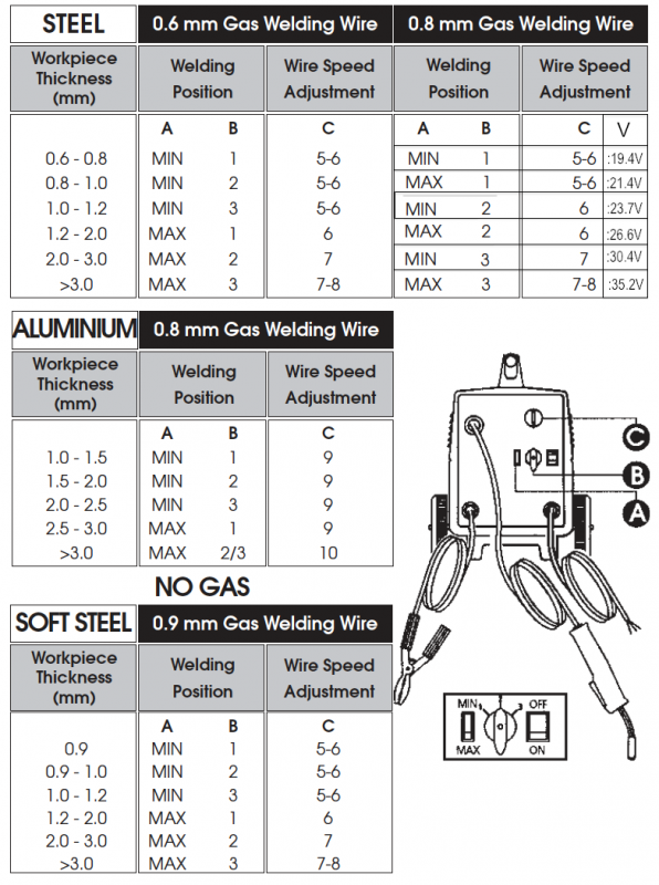

After a whole load of studying your columns (and various others too), I have finally bought myself a Clarke 160EN Gas/Gasless, a bargain virtually unused machine to which I am fitting all new liners and stuff so I know it will be working at it's best.
I note the comments made about the wrong settings in the Clarke manual and using your information I have remade that page of the manual. It's here if you want to download a copy.
Cheers. Mike.
Mike - just started using my Clarke 160EN for the first time in ages, printed off your amendment, thanks for taking the time and sharing it.
