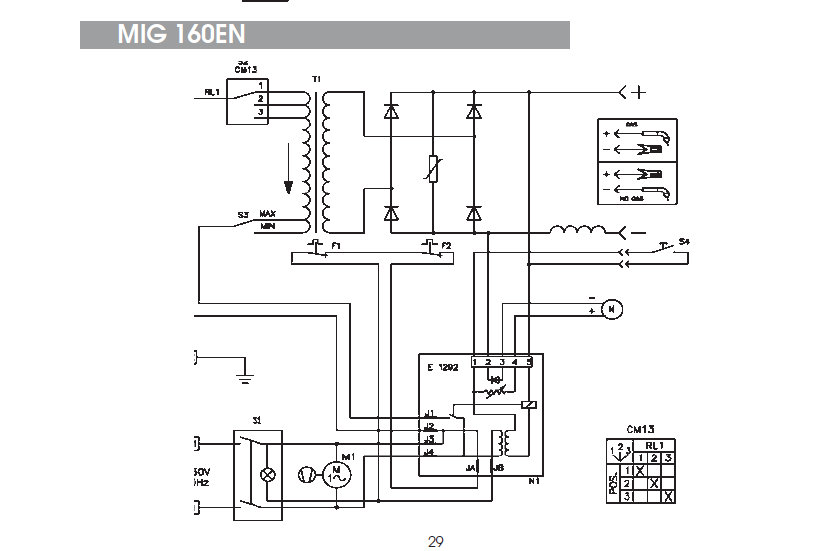

Hi all, my Clarke 160EN has stopped working, the fan is running but nothing else.
I have continuity from the circuit board, around the torch and back to the circuit board. I have continuity across what I think are the thermo switches on the large coil and what must be a rectifier.
The relay on the circuit board does switch if I put a seperate 12v source across its terminals.
So can anyone help me with where and howto look for the fault but please don't baffle me - I'm not an electrician!
