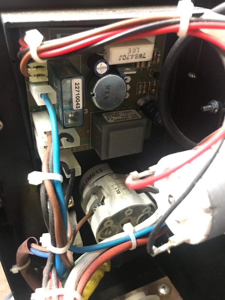

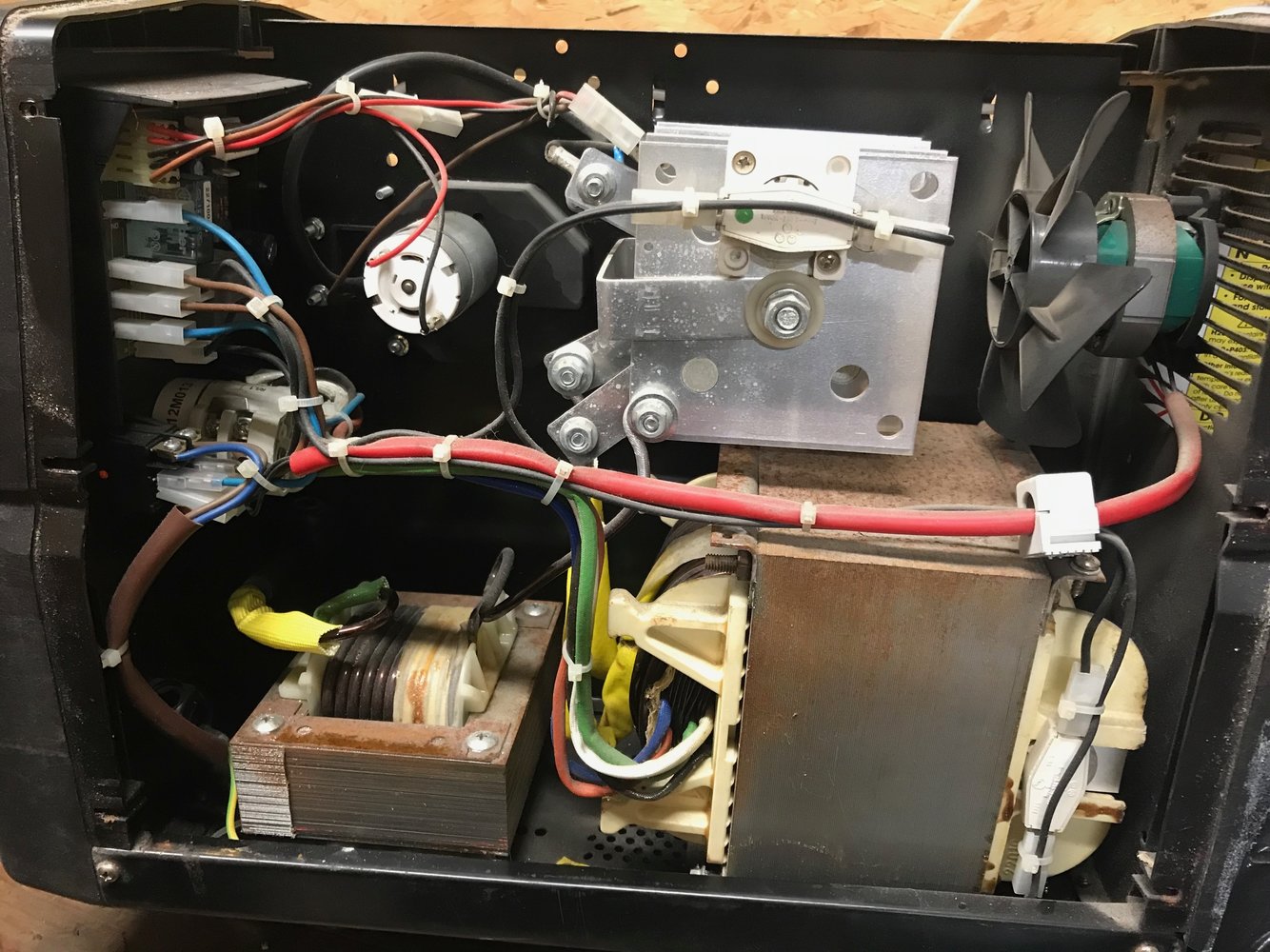

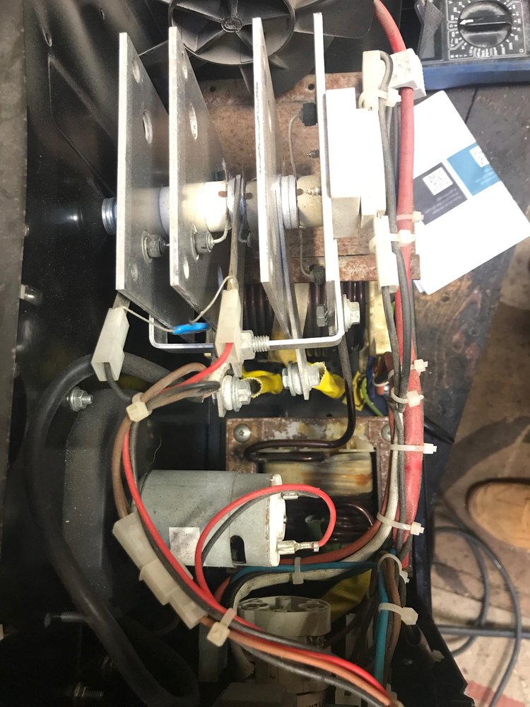

Im hoping someone with some welder knowlege can help me get back on track as my electrical knowlege is not extensive. I fired up the welder to do some tac welds on an exhaust downpipe. I got an initial spark then it suddenly died. Welder has been working great over the past couple of months.
The wire feed and fan still work. I have checked each diode on the rectifier and get a reading of 0.4 on each so I assume they are good. Between low-high power settings I get ~28-35 VDC between the torch tip and earth with trigger pulled. On the output of the transformer I get 30 VAC with trigger pulled. I dont see any burned connections and the relay makes contact with the trigger pulled.
When I first opened the case I noticed the ground cable which goes from the transformer to the casing ground had been pinched and severed. I have since replaced the cable.
Any suggestions on what else to check would be appreciated.
