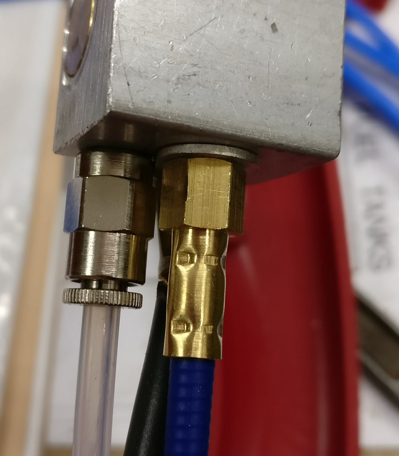

so the torch leads on the clarke welders are a bit short (about 1.6m long) and it seems that to get a longer one, people have fitted euro torches and solenoid valves, but I didnt want to do that as I like having the gas valve in the handle and its easier to control the gas. The clarke torches are also physically smaller than euro torches and easier with access in confined spaces in cars. I ended up getting a new 3m long liner, 4m of 4mm nylon tubing for the gas line and 3m of 20mm (135amp)cable

its a bit fiddly to use as a new cable outer and is a bit lightweight, so only time will tell how long it lasts and using 16mm 110 amp cable would have been easier too for size (the original cable is about 10mm 70amp) but I ended up with a new cable that was 2.6m long when fitted.
I ended up making a new terminal in the handle that was clamped buy both the wire liner fitting and gas tube fitting, which was first crimped an then soldered into place
