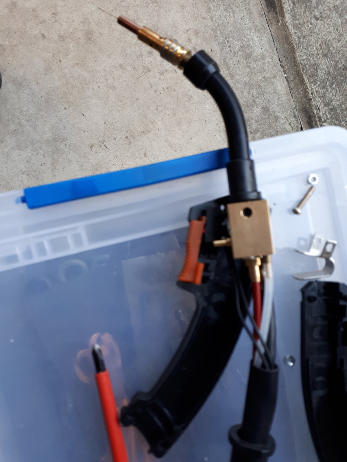

Did a bit of welding today; whilst having to hold the gun together with my other hand... the swan neck came out of the mechanism. Its the type that pushes inside a small metal block and tightens with a grub screw. Didn't have access to an allen key for it tonight so just made do.
The experience got me back to thinking about changing it for a euro type connection. I've already had to remove the original MIG gun and put on another one, as my collection of tips and shrouds didn't fit on what came with the 151TE, so rather than have them go to waste I swapped the gun.
With that in mind; can anyone help me figure out if I need a gas solenoid for my welder, it's the most daunting part of the conversion process for me and if I don't need to add one I'm much more likely to make the change.
I don't have a photo for the gun I am using now, but these are the internals of the gun I took my current swan neck from and seem to be the same.
Gas flows out of the gun, only when I depress the trigger, the trigger depresses that small metal rod type thing into the metal block. As it is now, am I right in thinking I don't need to add a gas solenoid to my machine if I went with a euro conversion kit or am I mistaken?
