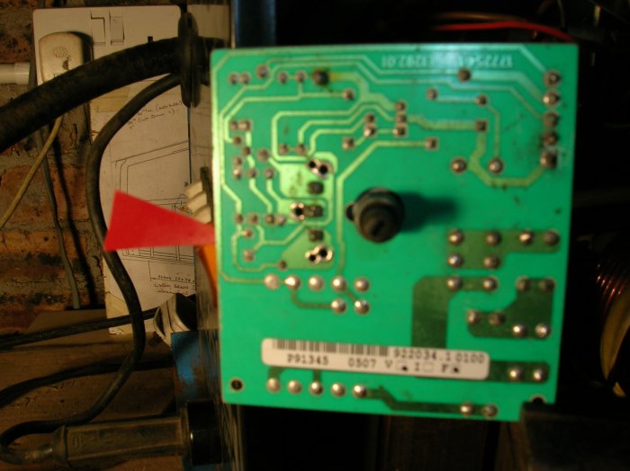

Hi all, was gifted (after fixing a £600 truck component!) above machine and found that a component is missing from the controll board, probably a capacitor. The board ref is P 91345-0507 PCB etch 177254.1 E 1292.01.

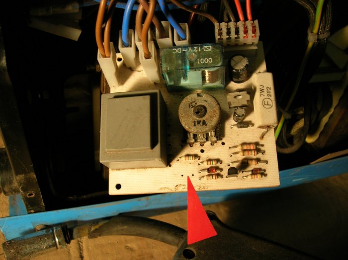

The two holes are 8mm apart and the (missing) component is at bottom edge of board (cables at top) see red flag on picture.
Would greatly appreciate value of missing component, machine looks well used and fan turns when switched on so worth some attention.
