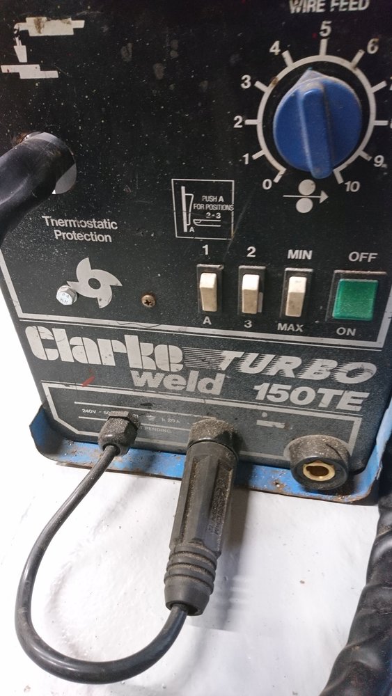

Hello,

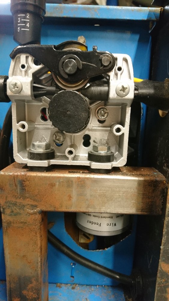

I have fitted a new wirefeed motor and when the trigger is released it runs on and wastes about 2" of wire each time.
The motor label says 24v 4A but is chinese rated and is infact 1A at 30v while under more load than is experienced while welding.

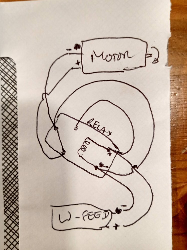

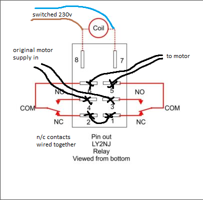

Is the welder possibly faulty? Should it brake the motor? If not does anyone know of a motor brake modification?

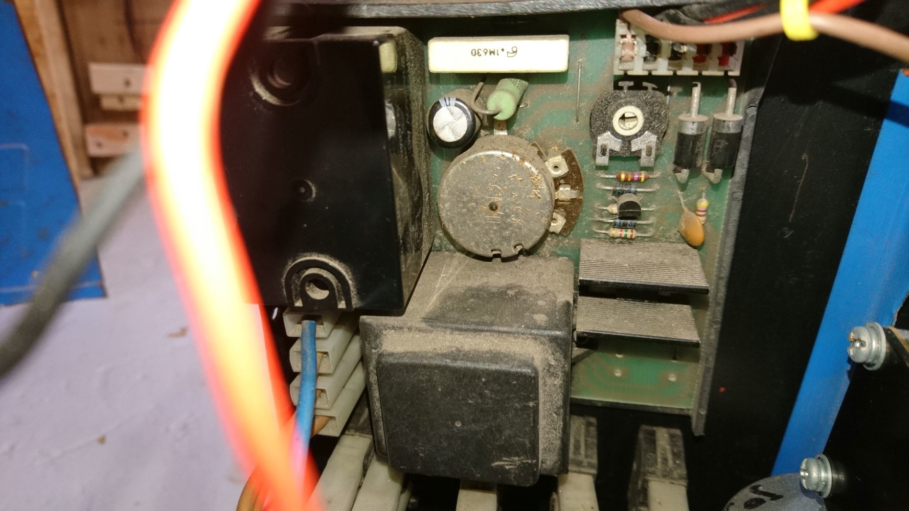

There is a large resistor between the PCB and motor that isn't shown on the wioring diagram in the manual but it does look like it should be there.
Thank you for any help
