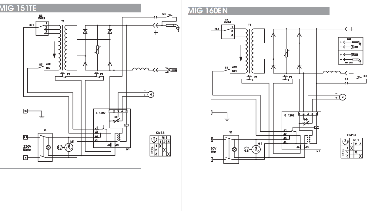

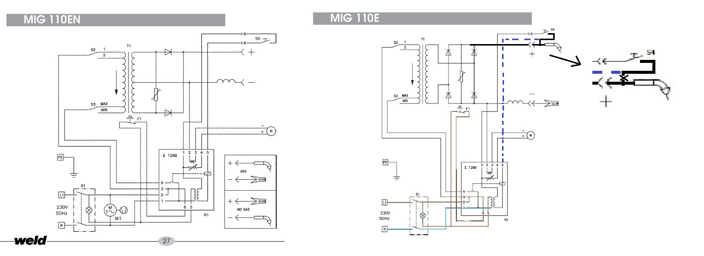

hi firstly many thanks for adding me.i have been trying to switch polarity so i can use flux core wire,i have followed posts on here for how to this,but when i have switched over the large leads and added a extra wire in torch,this then goes to the positive part off the rectifier.now all i get is a loud buzzing from the choke,only very slow wire feed and no arc.i also cut down the spring trigger so not to short on brass block.
any help would be great.
