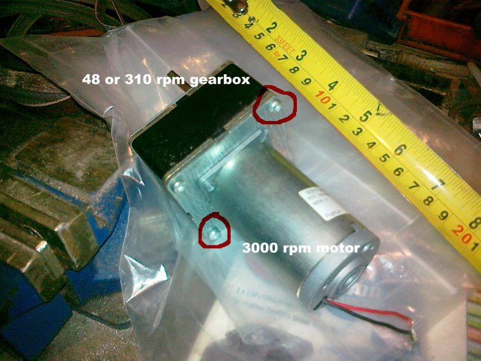

If the noise is a high speed screech then it will be the gear on the end of the motor. If it is a slow grindy (think that's a word!) then it will be the gearbox part of wire feed.
The reason the motor makes a screech is that it is running very fast (motors I change at work are 3000 rpm into a gearbox which then drops the speed down to 48 or 310 rpm (two main types) They are very similar to wirefeed mortor asy's (see pic) I have befor now removed one or two of the motor to gearbox screws and using a can of spray grease and it's spray straw inserted into gearbox as far as it will go then whils spraying slowly withdraw ( I refer to this as the withdraw methord ) This should sort the slow type noises. For the high screech it would need to remove the motor from the gearbox and spray the small gear at end of motor.
Avoid using WD40 or similar as it will only be a temp fix.
As the ones I work on are on medical devices I only use as temp fix/get out of jail type fix.
