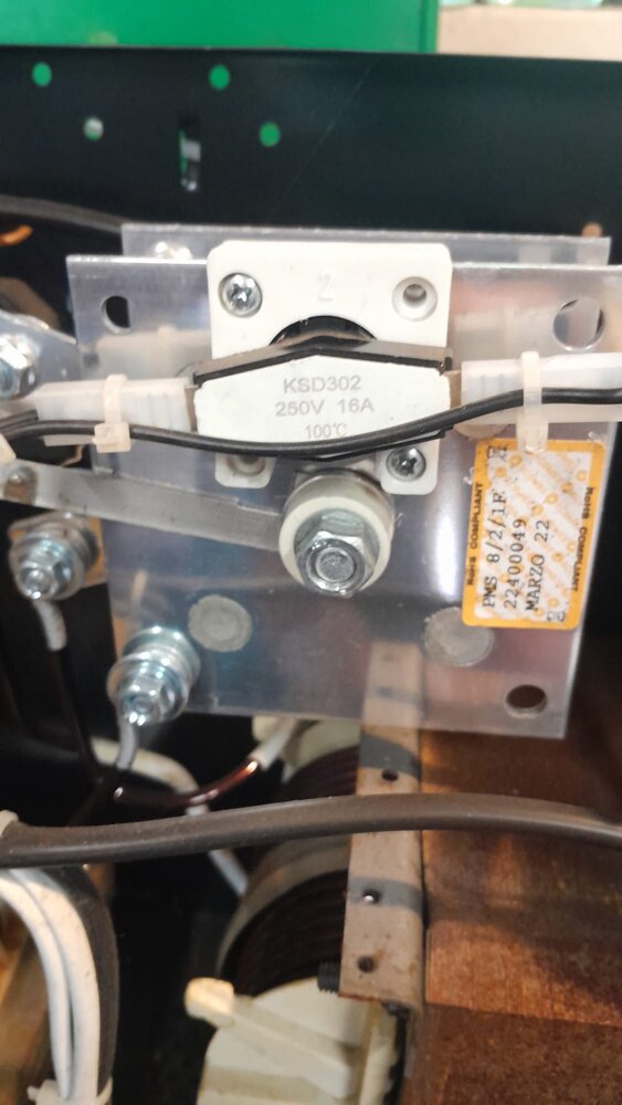

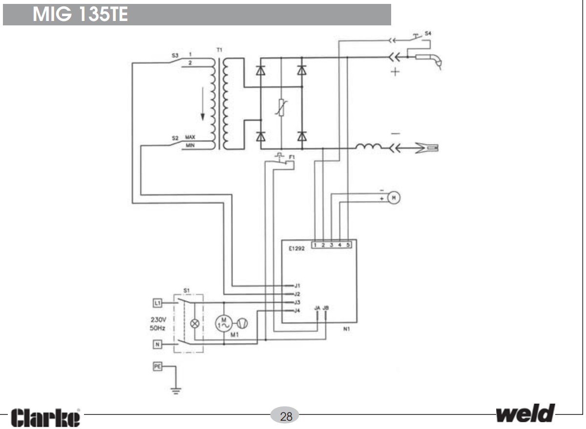

Hi there i am new to this forum have read through a few posts but havent managed to sort my problem.
I was welding my car and the welder stopped feeding wire just like that, thought maybe it just got stuck in the roller. After trying for a while had no luck disconnected the tensioner. wheel just would not move just making a clicking noise from inside the machine, i thought i must be the motor so dissconnected the motor and assembly and connected to a 12v battery the motor spun fine am completely clueless now. What else can i check and howdo i test them please many thanks chris
